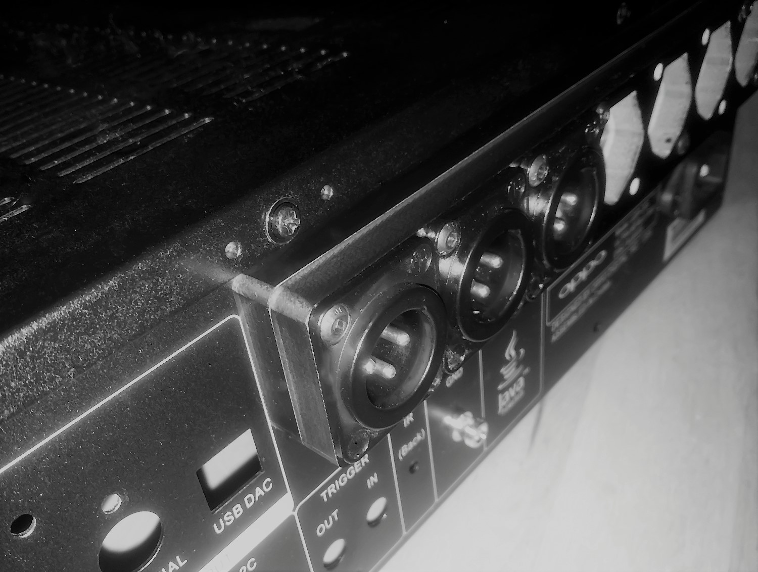

A better way for mounting the multi-channels XLR connectors, on the back panel of 205..

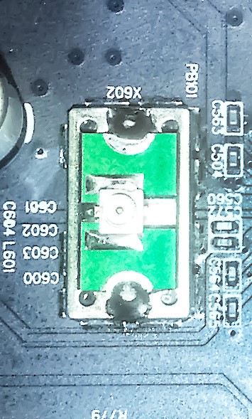

I wonder also how they may doing it when soldering the can on board... It seems to me that all soldering points of the can are soldered simultaneous... I have used a 100w soldering iron and I couldn`t remove it. It is a such big heat spreading on that ground plane, and the risks for damages on board are very high (as to be seen in the above picture also...).
However, I repeat my opinion that the can removing is absolutely unnecessary (now when we know what is inside). Here I can see only two alternatives: either using the circuit as it is, or cutting the clock out trace, and power rail to the original circuit, and then inserting the new clock circuit/signal. At least the can itself so as it is soldered on board, is a very good support for a UFL connector (my solution) or another small PCB, as the one used in the above pictured case...
