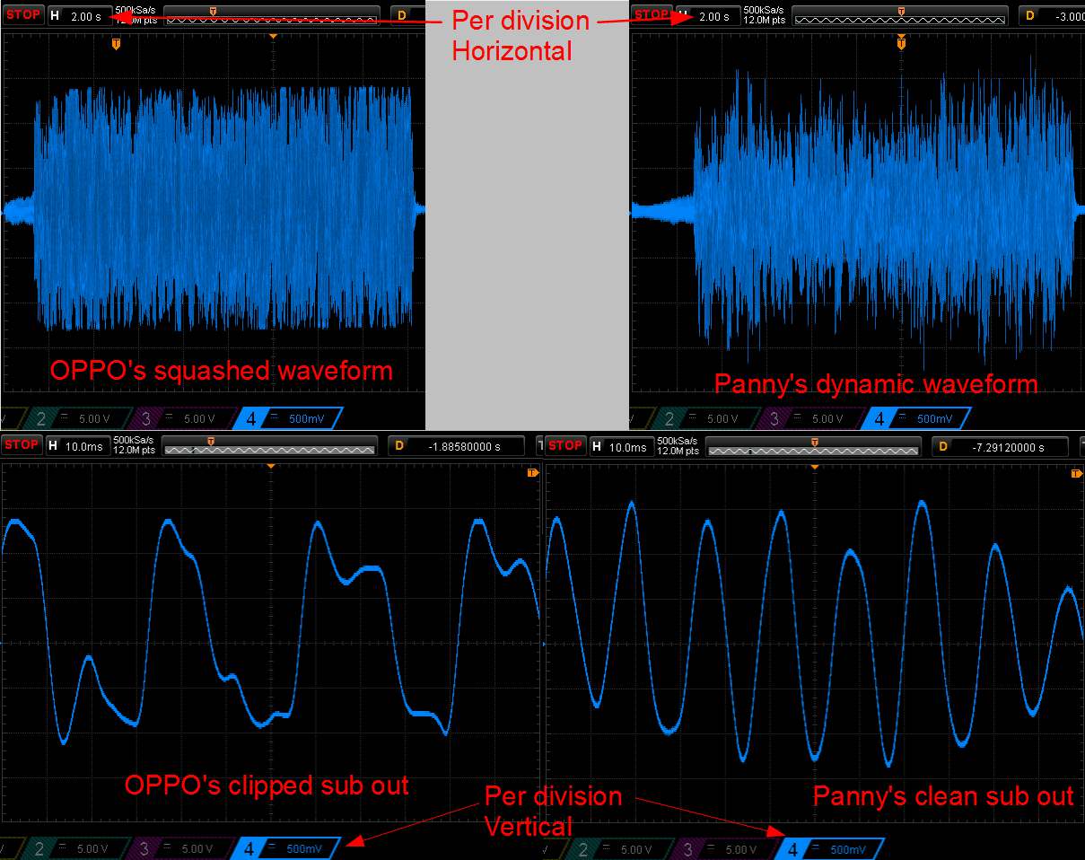

First of all, to the Mod's: I know there there is already a thread about this player but what I've found here is huge and I wish somebody had showed me the following data before I wasted over a thousand dollars on this device so I believe it's worth it's own thread...
This is a waveform from the end of the movie Earth to Echo. The waveform with the red border is taken from the analog sub out on a 200 dollar old 1st or 2nd gen Panasonic bluray player. It fades into the green border's waveform which is taken from the sub out of the OPPO BDP-105. Here is a closer view...

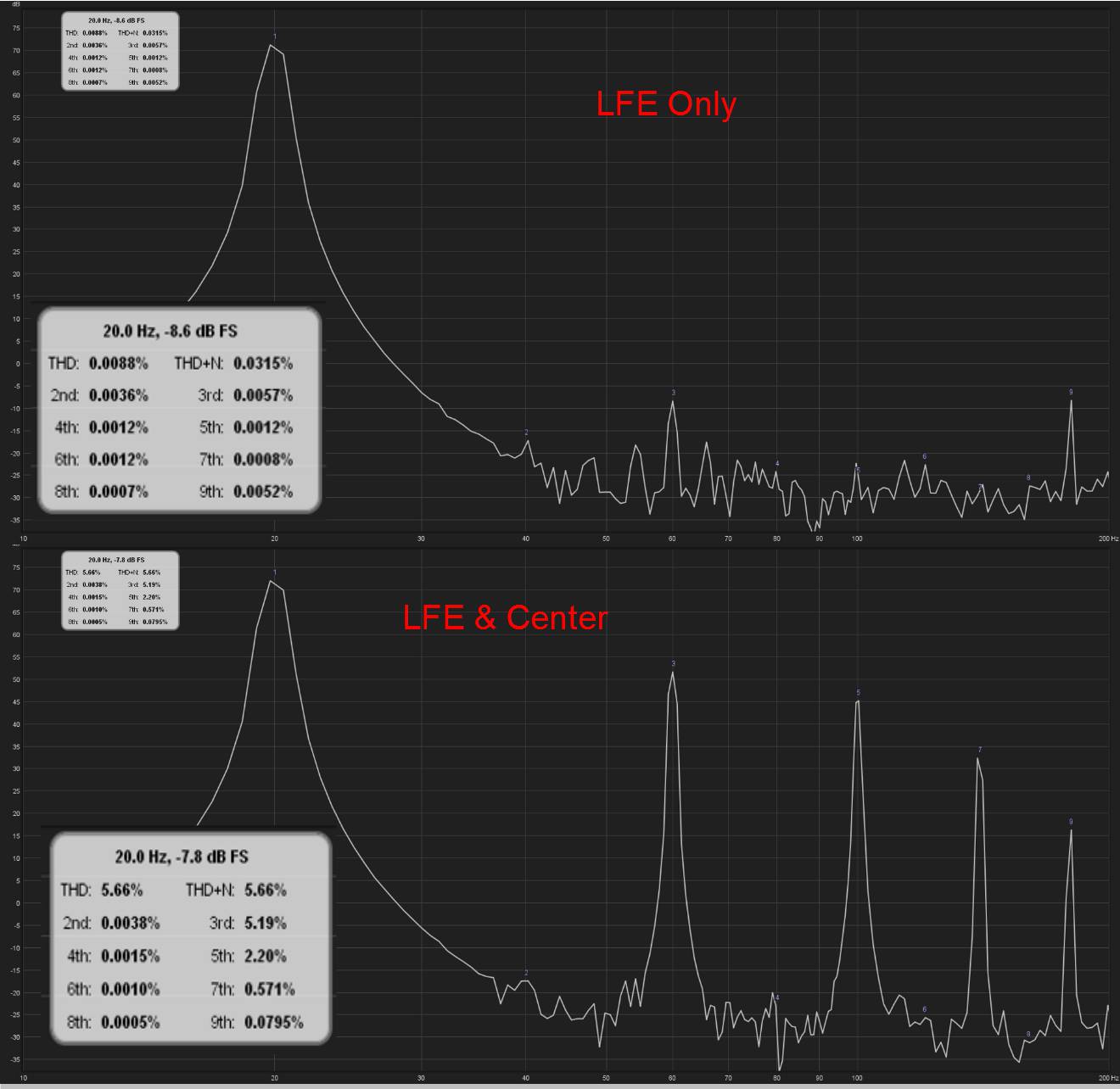

What I found is that the 105 can handle a near full reference level (-0.1dB) LFE track at any frequency with the MVL (master volume level) all the way up to 100 without clipping. But as soon as you add even the center channel's re-directed bass with it, it starts clipping and from there the more channels you add of re-directed bass the worse the clipping gets. The WORST part is: it doesn't matter how low you adjust the MVL or the sub trim, the clipping does not go away! It is a problem with how the 105 sums the signals and adds it to the LFE channel so there is no fix for this.
I understand that there isn't going to be many movies with all channels outputting only sine waves in the low frequencies but like I said, this was a worst case test to have a good idea where to set your analog out's (MVL for reference and/or sub trim control) so that a worst case will not take out any amplifiers or drivers in your system. With loudness wars now infiltrating more movie soundtracks full of square waves in multiple channels, we might as well start setting our systems up accordingly.

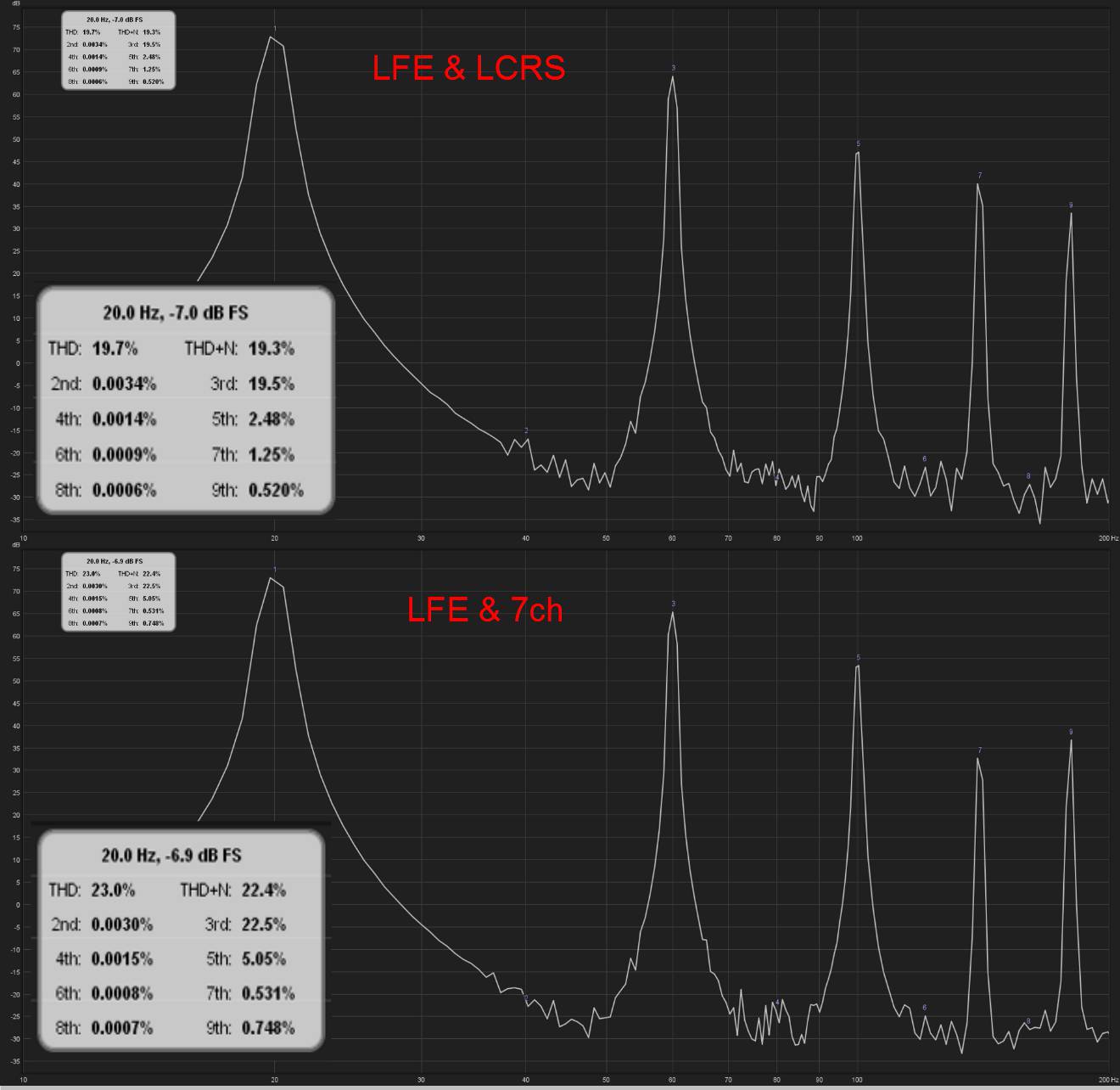

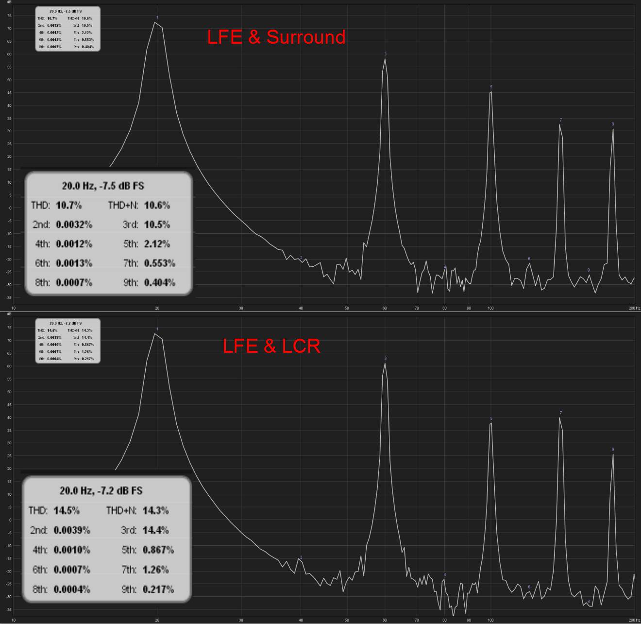

Look at the following attachments to better understand how the 105 deals with re-directed bass:

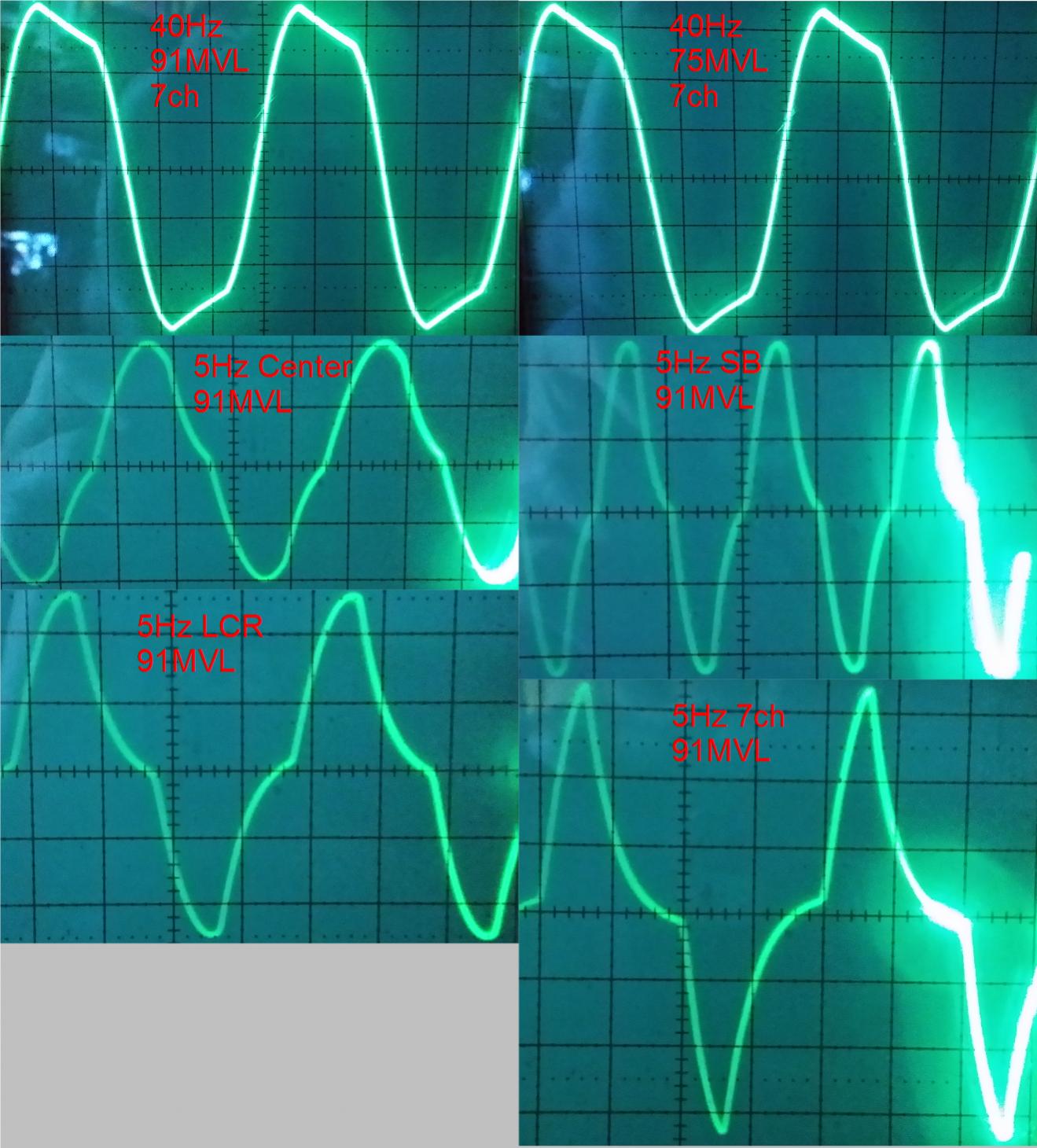

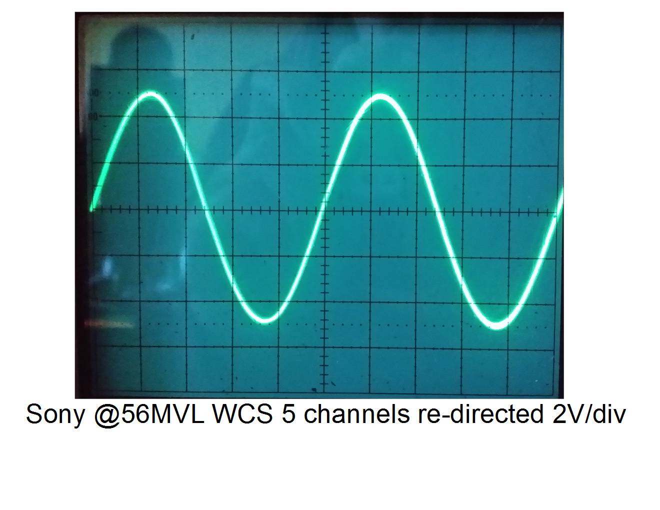

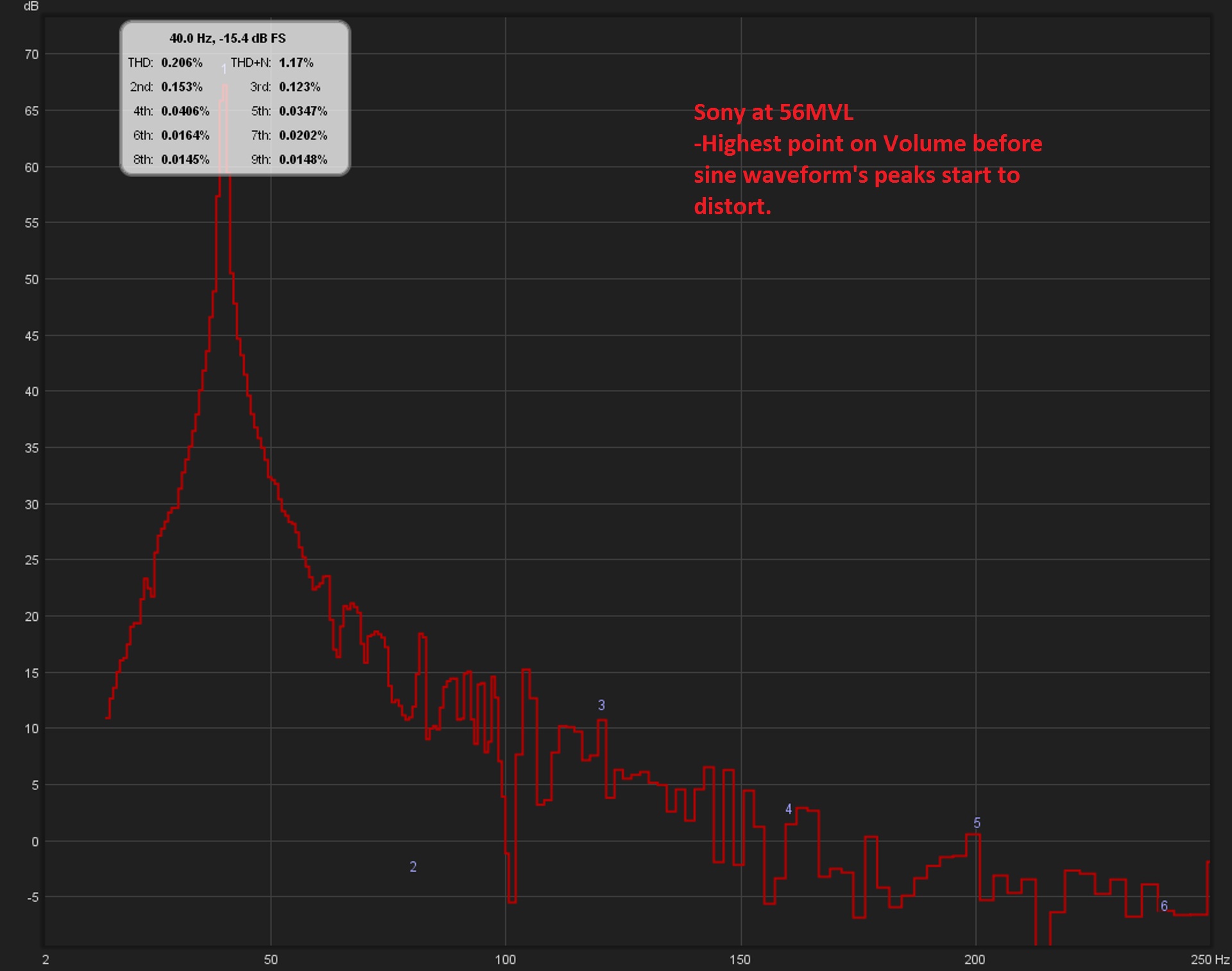

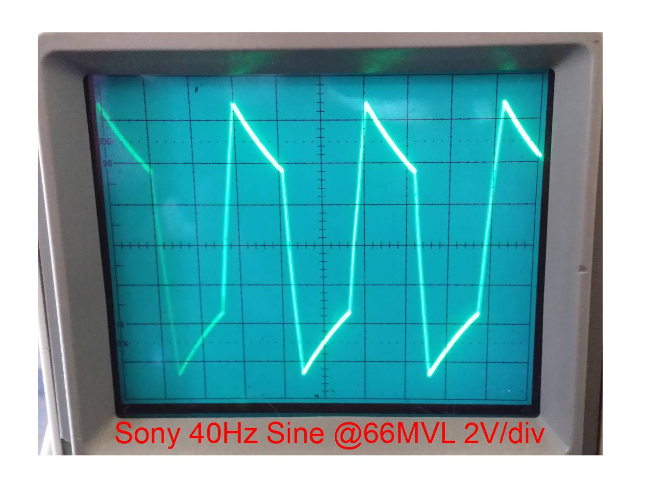

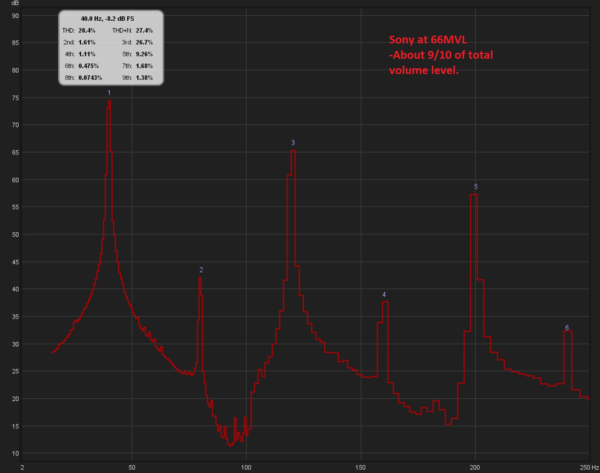

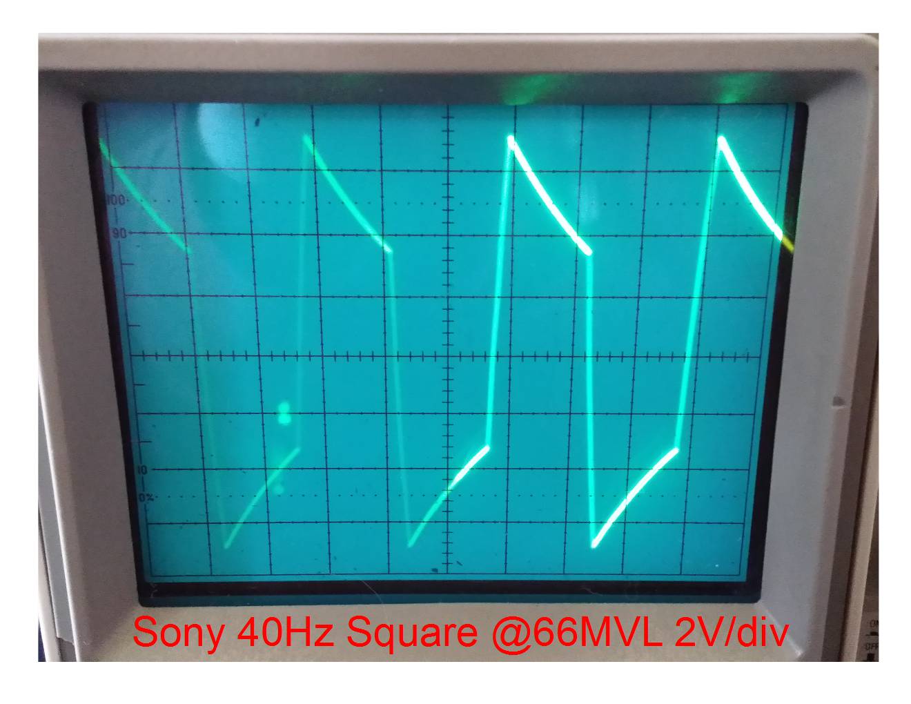

Now you see how the OPPO has failed the worst case scenario test. I'll show you a pass. I tested a Sony AVR -the STR-DE597. It is a cheap 6.1 only compatible AVR with only 1 choice of crossover settings (77Hz) with a pretty poor low end rolloff. It's master volume goes from 1-74 and with the worst case test disc I found that it's last usable master volume level with sub trim at 0dB was 56 before it went into clipping. It's clipping as opposed to the OPPO was due to it's analog preamp level's limitations.
I also show here some data from it's volume at 66 (about 9/10 of the total usable MVL). I found it very interesting that there was almost no difference at all in the shape of the waveform in reproducing a sine wave vs. a square wave due to the amount of distortion it produced at that level.
So basically, the Sony is now guaranteed to put out clean audio with any hot re-directed bass movie content you can throw at it as long as you keep the MVL under 57, everyone with me?

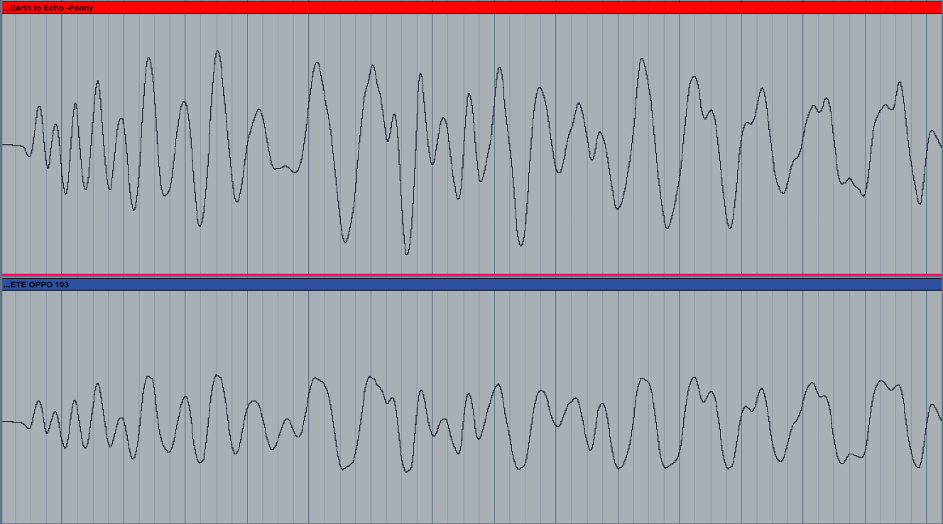

At this point I started to think about a test I did where I viewed the waveform of a movie scene by taking the OPPO's sub out, putting it into an interface and recording it in a DAW (digital audio workstation). The scene was HTTYD the Dragon Crash near the end of the movie. I began to remember that the peaks in the waveform looked very similar to the waveform from the sine wave test. I then looked closer at them and my heart sank. The OPPO was actually clipping source material.
This is the 105's sub out A/B'd with the cheapo Panasonic player playing the same Dragon Crash movie scene with the levels matched. Look at how much of the dynamics the OPPO clips out of existence. This is OPPO's flagship model vs. a 200 dollar obsolete player!

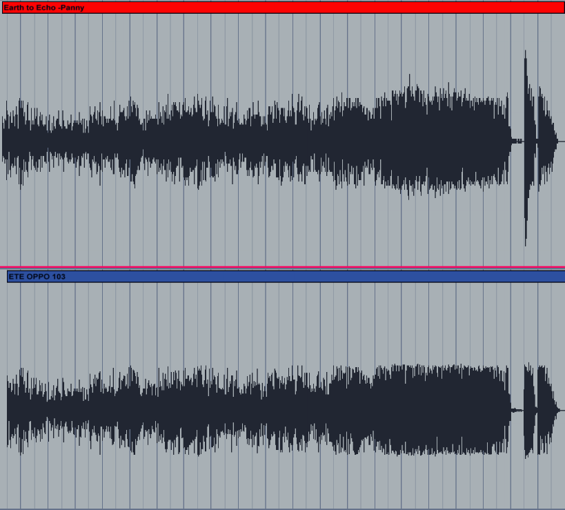

Here is the waveform of a recent movie "Earth to Echo". This scene is the ship at the end of the movie. You can see how a cheap $200 1st gen Panasonic bluray player puts out a dynamic signal while the OPPO BDP-103D squashes it with clipping.
