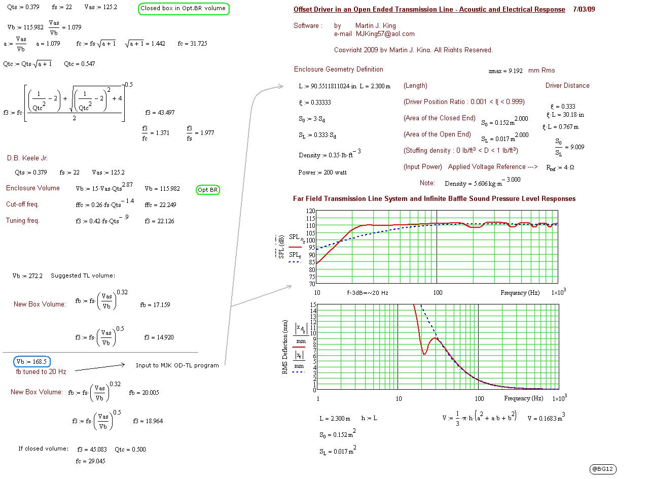

Hi schmeet,
Good job! A quick check using one of MJK:s programs:
b:)

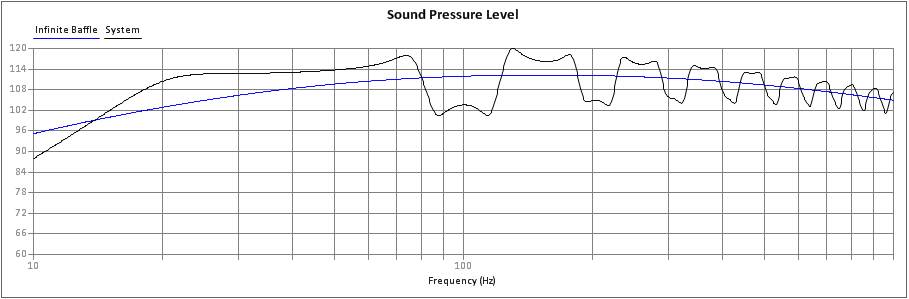

Thanks for that bjorno.
I've attached the FR output from my program for comparison. It seems to correlate pretty well (although the axis aspect ratio are very different so its hard to see).
It appears that the frequency response of my stuffing attenuation is a bit out though as I have slightly more low end attenuation and slightly less high end attenuation.
I guess the smaller volume TL would be good also with its main advantage being it is alot smaller! I think the terminus velocity would go too high though.

..I guess the smaller volume TL would be good also with its main advantage being it is alot smaller! I think the terminus velocity would go too high though..
Agree, and if using a suitable ~20 Hz HPF the terminus velocity should stay lower than 10 m/s when reaching x-max.

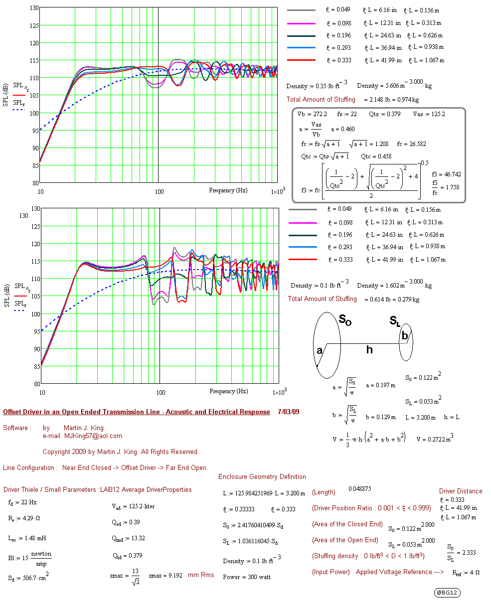

Here is a suggestion more in line with a traditional TL design:
b:)
