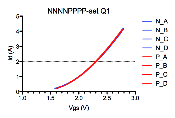

A diyAudio member has reserved the NNNNPPPPP-set Q1 and to document the quality of the matching I have this morning located the recorded traces and plotted these to share with you. N-FETs are in blue and P-FETs are in red.
As you can see all 8 FETs track almost identically over the entire current range. In fact, it is hard/impossible to distinguish the individual curves.

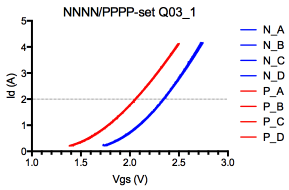

Joined 2009
For comparison here is a Type 2 set with a Vgs offset of about 300 mV between the N and P devices. Notice that the slopes are also different with the N devices being steeper (i.e. have higher transconductance).
Later I will show you what happens to this set when the N-devices are added a little bit of source ballast:D
