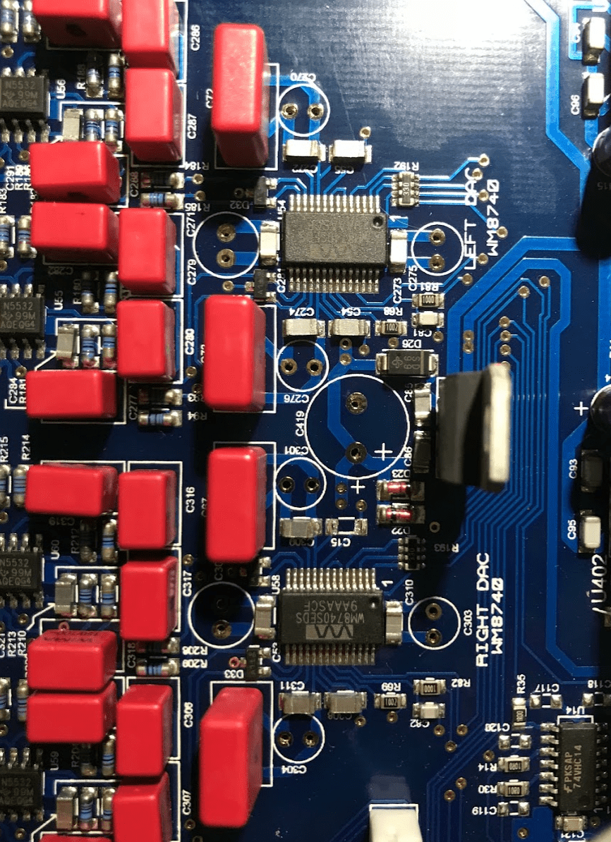

Hey quick question the caps surrounding the two DACS are not marked as polar, and the recommended examples here still uses polar replacements.
It's the 10 uF 50V that came out C275, C303 C301 etc , and the 47 uF 16V see photo.
Can I put polar caps in, does it matter on the orientation or am I best to select some bipolar examples like the Nichicon ES.

What do you think? And do you have a DMM? You could measure voltages to see what + and - are. They are decoupling caps mostly AFAIK so polar ones are to be preferred.Can I put polar caps in, does it matter on the orientation or am I best to select some bipolar examples like the Nichicon ES.
BTW C15 is missing?!? It should be there. Same value as C55 I think. A case of part rolling with damage?
good spot on the C15 missing, I will have to find the value and drop in a conventional cap here.What do you think? And do you have a DMM? You could measure voltages to see what + and - are. They are decoupling caps mostly AFAIK so polar ones are to be preferred.

Found the spec on the Wolfson chip and since C15 is between pins 9 and 10 it's termed C4 in the specification sheet and therefore 0.1uF I think

* the cap is between pin 9 and 10 but one of those is + and the other is GND so……

So for C15 I can use a polar and put the +ve on pin9, and I float off C55 and copy with a non SMD Cap that matches for pure symmetryWell then you have introduced non symmetry with parts. One out of 8 is then replaced for a random brand/type/value which is a true nightmare for cap rollers if I have understood them correctly. In this case the non symmetry is between channels. Horror!

Dear cap roller, C15 is a non polar SMD film cap AFAIK and closest to the ICs. A very good choice by the manufacturer. If you want to correct the introduced error then measure the other caps like C55, C54 and C308. I think they are all the same value but checking = knowing and knowing = not asking. Maybe it is a good idea to use SMD non polar film caps for those 4 caps again in the same brand/type/value/size in both channels. So no more RR (random rolling) but a technical choice making stuff right. Scary! If you are lucky then the missing cap is somewhere in the device. Take a good look and if you find it check/measure it. Would be the easiest option except then different solder will be used. Oh oh.

* the caps indicated with a circle on the PCB are all electrolytic caps which are polar for decoupling usually. I don't know why the "+" has been omitted as one would think of bipolar caps but those don't make sense for decoupling duty. If you have kept the old ones you could take a picture. Strange things may have been done as this brand and designs sometimes have dubious choices in the cap area and fail more than normal.
** you can't go wrong with measuring the electrolytic cap pads as WM8740 only has positive power supplies so if you measure continuity between a pin and GND then it is the caps "-". Mark the pad outside its circle clearly visible with a "-" and make sure you solder the caps right in.

Thanks for the advice I now have the polarity on these decoupling caps measured and marked.Dear cap roller, C15 is a non polar SMD film cap AFAIK and closest to the ICs. A very good choice by the manufacturer. If you want to correct the introduced error then measure the other caps like C55, C54 and C308. I think they are all the same value but checking = knowing and knowing = not asking. Maybe it is a good idea to use SMD non polar film caps for those 4 caps again in the same brand/type/value/size in both channels. So no more RR (random rolling) but a technical choice making stuff right. Scary! If you are lucky then the missing cap is somewhere in the device. Take a good look and if you find it check/measure it. Would be the easiest option except then different solder will be used. Oh oh.

So the lost capacitor in question C15 is 47nF = 0.05uF, so half of the Wolfson

No Wima in this location, please....
You should put a 47nF 16V Panasonic ECHU 1206 plastic film in there, same as C54/55/308 You allready have.
I like for C270/276/301/304 ( VMIDL/R ) nichicon UES . Try 22uF/25V.
For C275/303 (+5V digital ) panasonic FM/FR 100uF/25V work well ( double check polarity before....)
Use for C271/302 a nice audio grade nichicon of your choise ( polarity check and do not forget to check diameter before order )
In C419 position use an audio grade cap 1000uF/16V or 25V if fits, no low ESR please

The tip bicefalo gave is a good one. You could use 47nF 16V Panasonic ECHU 1206 for C15/54/55/308. I am not so sure about using ultra low ESR caps like Panasonic FM for C275 so I would advise to check the schematic what regulator is used and if it accepts ultra low ESR caps. The datasheet specifically mentions NP caps so I think the ESR thingie is actual. Non polar electrolytic caps have higher ESR than normal ones.
Having seen the schematic I am pretty sure upgrading the 7815/7915 and 7805 makes way more sense than rolling caps. With an external multi voltage PSU connected via a multi connector things will also improve. Then the internal switcher can go.
