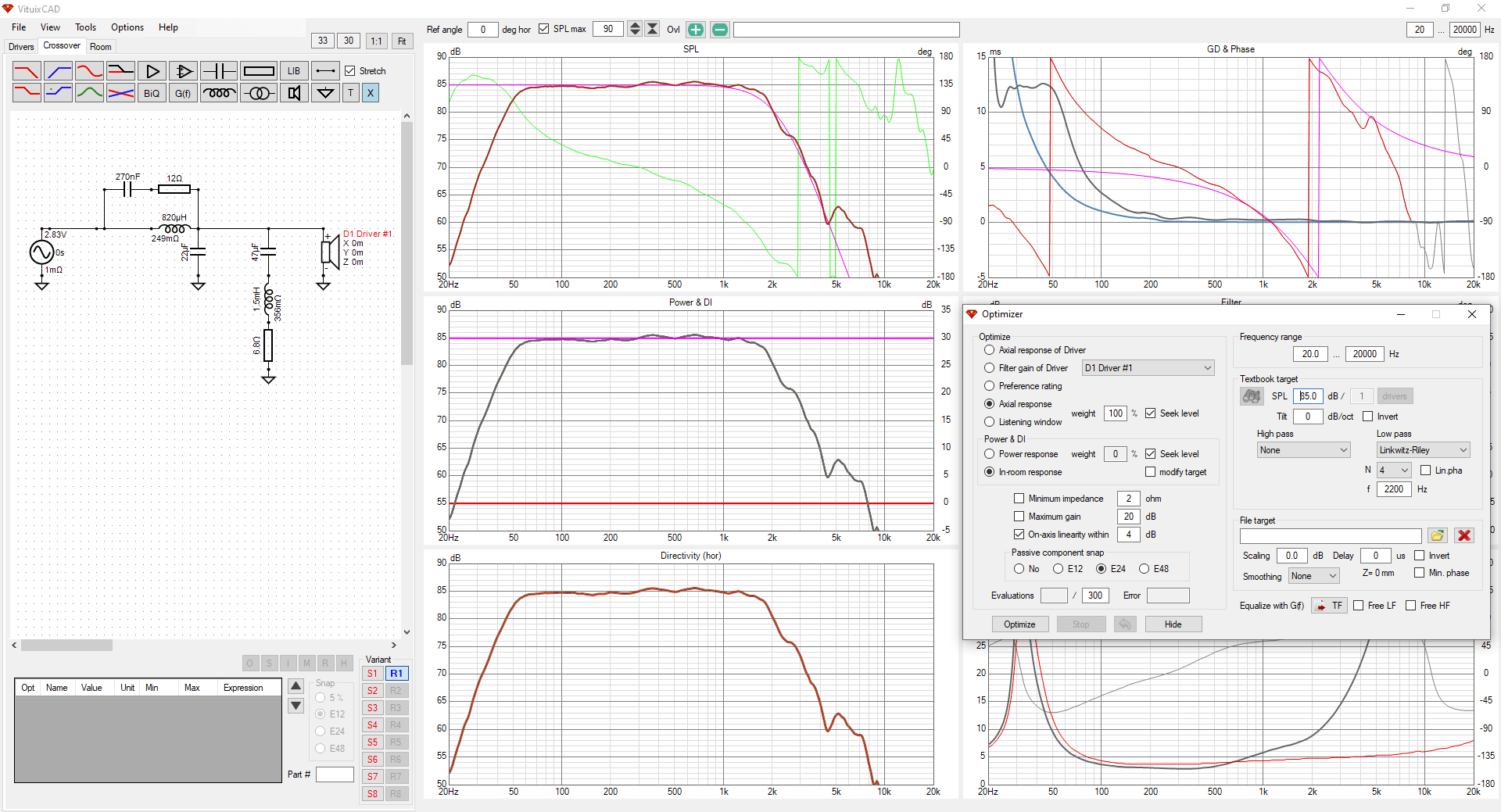

@augerpro I am assuming the measurement are of the drive in the box and on the baffle you intend to use, if not please disregard the info below.
If so, here is a starter for ten. Second order electrical plus a tank to control breakup and a notch to take into account the baffle step. I used the impedance plot from the SB datasheet for reference.
I am nowhere near an expert but might give you something to work on. Others please chip in as this is a pretty basic attempt using the data provided and so may be a load of rubbish.
Reactions: 1 user
@augerpro I inputted the impedance data and it did not change the frequency plot, minimum impedance is 3.0ohm between 220hz and 400hz. Obviously this may change when you add in the tweeter data and you are likely to have to modify the woofer filters to get the phase to lineup correctly. Also there is no off axis data as this again needs the tweeter data to be modeled. I have overlaid the original data (no crossover for reference (orange dotted line). You might get away without the tank filter but the parts are relatively cheap so probably worth keeping in and see if it helps.
Anyway, it's a start and looks a fairly easy woofer to get to where you want it to be. Hope it helps but the usual caveats apply.
Reactions: 1 user
