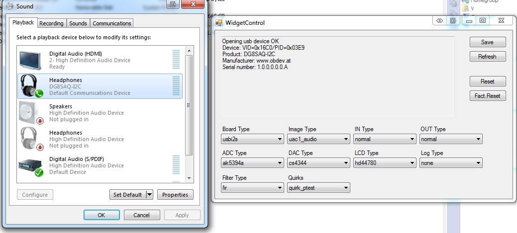

Not working on windows can anyone help...things i did
downloaded the drivers
installed the drivers
installed ASIO on foobar
checked the output as ASIO in foobar
when running an song i get following error
Unrecoverable playback error: Sample rate of 44100 Hz not supported by this device
any idea?

removed the drivers then installed the softwarae again and then now i can not see any output where i can select this as output in foobar or anywhere...
the test audio is getting the sound as headphone in green i guess 24/94 bits only....when its red i am not getting anything...

here is what my screen looks with green and in this nothing works under Foobar and then in red led i cant get anything to play as foobar says there is no ASIO drivers there

Have you changed the settings about which I and alexlee188 wrote before?
On your screenshot I see something completely different ...
(Read post number #1713)
You must choose the same parameters and save them...
Later, you must reset the AB 1.2 (on backpanel)
Your computer supposed to show only this:
In Foobar2000
/Library/Configure/Output/ASIO "USE 64-bit ASIO drivers" must be OFF

This thing was the problem ...thanks and its working...
