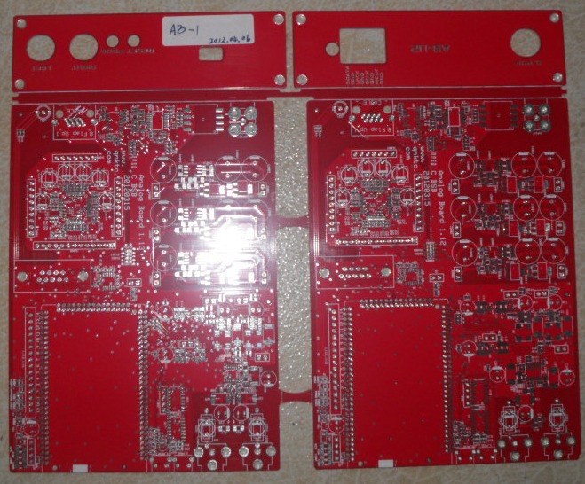

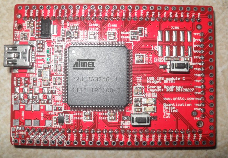

Boards update
Finally, something's happening with the new boards!
Here are recent pictures of the newest incarnation of the USB-I2S module and of the AB-1.12 / AB-1.13 prototype boards.
The USB-I2S module still isn't 100% tested... Cross your fingers for a good result.
As soon as the boards get to Norway and I have inspected them, I will open up for orders and payment.
Børge
