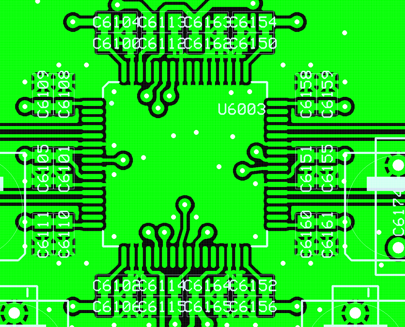

any chance to have AB-1.12 required parts (except for the ES9012/18) shipped together with the board and/or pre-stuffed boards?The AB-1.12 is a naked board,
Are clocks and PCM5102 powered by default from the new regulators on AB-1.12?
Are there pads/holes for local by-pass (and perhaps zeners...) on the (optional) ES9012 spot?
They are the US distributor, but have no pricing info on their web site.
They will not sell single quantity. Minimum quantity is 2 at $50 ea.
yes i was going to ask about more tight decoupling on the es9012/8, i can only see the bulk decoupling and since its a circuit kinda floating there with PSUs not exactly close, local np0/c0g decoupling and bypass is a must IMO. also i have seen Demian post an isolated version of the clock supply, same circuit with transformer coupled output so its completely isolated from ground, it looks like the clock supply is by default USB powered with transformers/inductors/chokes near J2 and J3 having isolated output and J2002 and J3002 on demian and oneclock's reg circuits connect optionally to this point, its not totally clear; can you confirm i'm reading this correctly?

UnixMan, sorry, you'll have to assemble the parts you'd like to use. There are so many different things to prototype on that board, so the complete BOM might be too expensive for those just wanting certain functions.
Qusp, there is a whole underforest of 0603 capacitors schmack on the supply pins. I have attached a picture.
