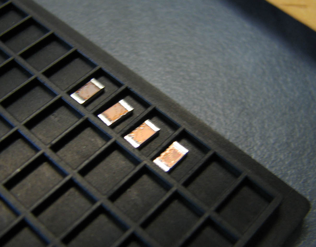

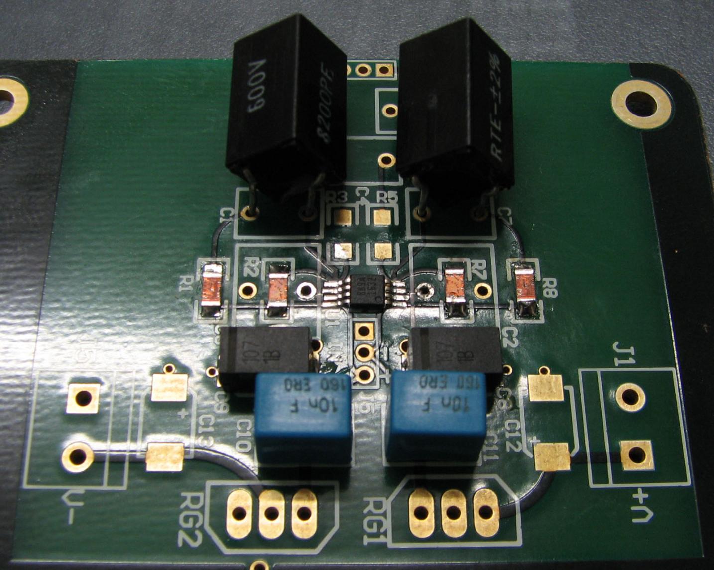

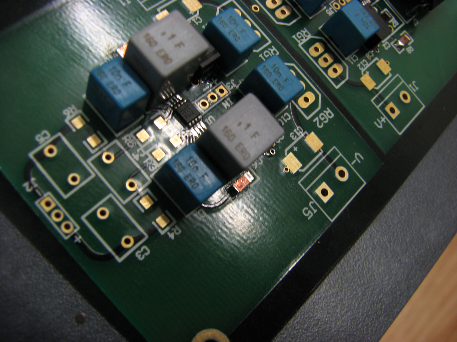

ok, its a bit funny if you ask me and i find it a bit dubious that you might suggest that a leaded Zfoil resistor such as the TX2575, arguably the most highly subjectively regarded resistor anywhere, might sound better because it has 2 leads on it compared to the ASMP series (known as TSMP when bought from Texas components rather than vishay precision group) naked zfoil, which i'm guessing you have no experience of? but is otherwise identical
also smd pps film caps were tested for piezo electric effects, which is the only possible electromechanical effect in this application and they came out exceedingly well. if you think I choose parts solely on numbers you would be wrong, but i will not choose a part because some audiophile press or 'wisdom' says its good; it must tick BOTH boxes. using a huge high voltage leaded cap in such an application as we are talking about is absurd IMO, asking physically large caps to bypass high frequency makes no sense
its this type of baseless superstition that gives audiophiles a bad name in engineering circles. it does not have to be arcane to sound good. eventually if you keep going that way, somehow drawing a line in the PCB or where SMD parts are allowed to sound good (dacs, USB DSPs, perhaps some RF parts or CLASS D etc) and where they must sound bad and you will eventually not be able to build anything at all; because it wont be too long before only niche manufacturers make anything with leads on it.
btw on the board below, i have 2 of them, its an IV stage/low gain headphone amp, on one i changed the 100nf larger vishay MKP (which is a bypass cap on the supply lines here) to a panasonic pps SMD for lower profile as its portable and it sounds great, the relcap RX polystyrene film/foil LP filter caps on one board were changed to sunring pps and copper foil caps and it finally edged out the relcap. for crucial analogue filter situations like that i will often still use leaded, but if someone released an SMD version i would leap at it. there are a few SMD PTFE caps made for RF work, but they are only available up to 5pf

I for one am all for buying parts based on their specs. Do you have suggestions for SMD resistors fit for filters in high-end analog circuits?
Also, you seem to have your capacitors screwed on the right way. Any suggestions for common points of load like XO, MCU, op-amp, DAC-analog, DAC-digital? I have the habit of just piling on, 5-ish nF of C0G, 1-ish µF of X7R, 10-ish µF of something with a perigree :)
Then again, I have heard from a very professional high-end designer that he prefers through-hole metal film over SMD metal film, mainly due to thermal heating and non-ideal TCR.
Børge
P.S. Have you considered multiple vias and less ESL for C12 and C13? :)
