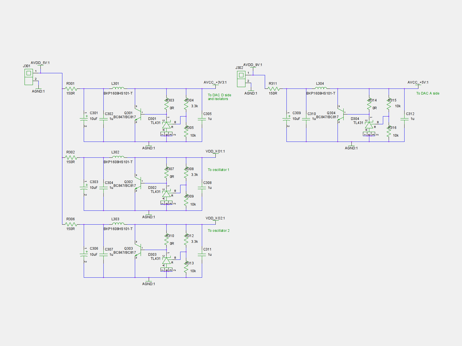

Now that we are in the knowledge sharing mood, any thoughts on using TL431 shunts as shunts for the supplies? I have seen onoclocks interesting studies of the using the TL431 in a series regulator, but on diyaudio's analog forums, shunt regulators seem to have more street-credit. :cool:
In the attached schem, I have included the option for a npn SOT-23 device in cases where more current needs to be shunted.

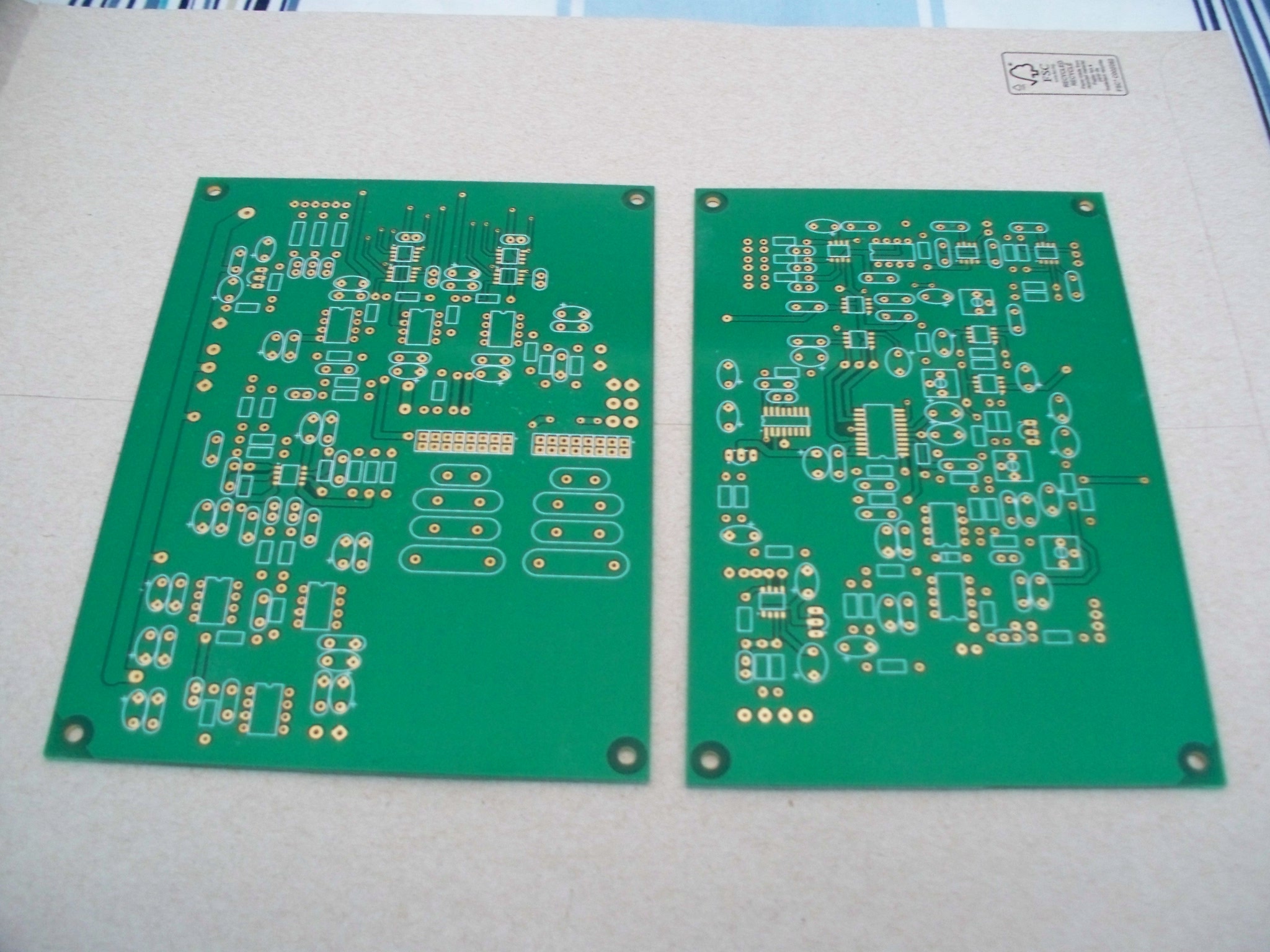

I finally got my camera working.
These really belong over in the oscillator thread but since I mentioned here...
It is mixed signal though.

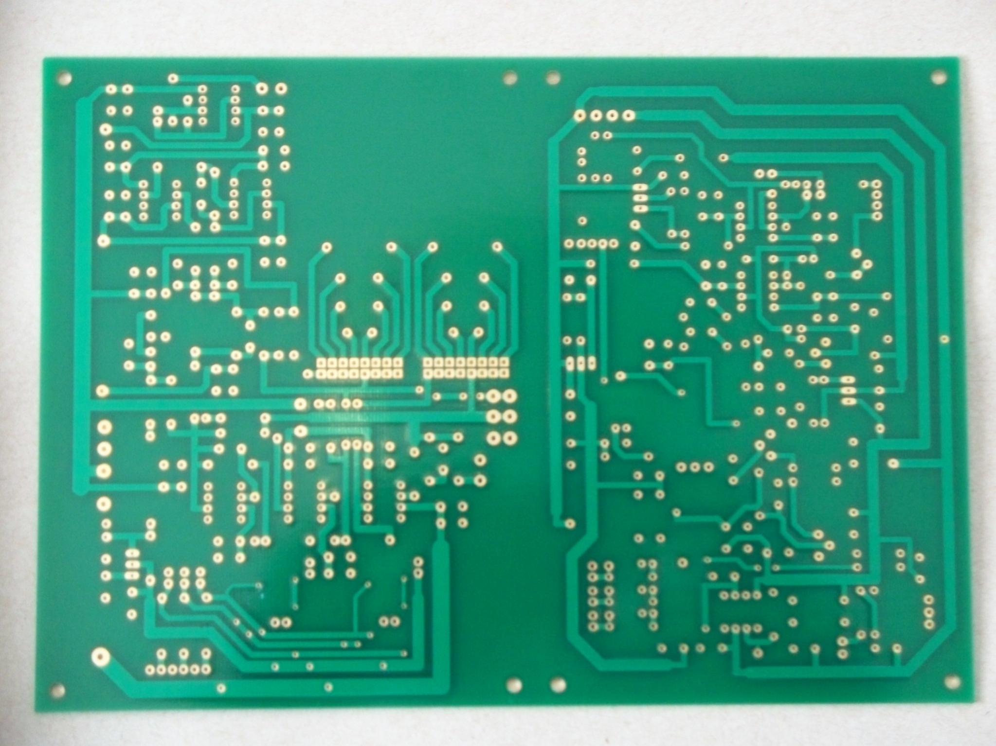

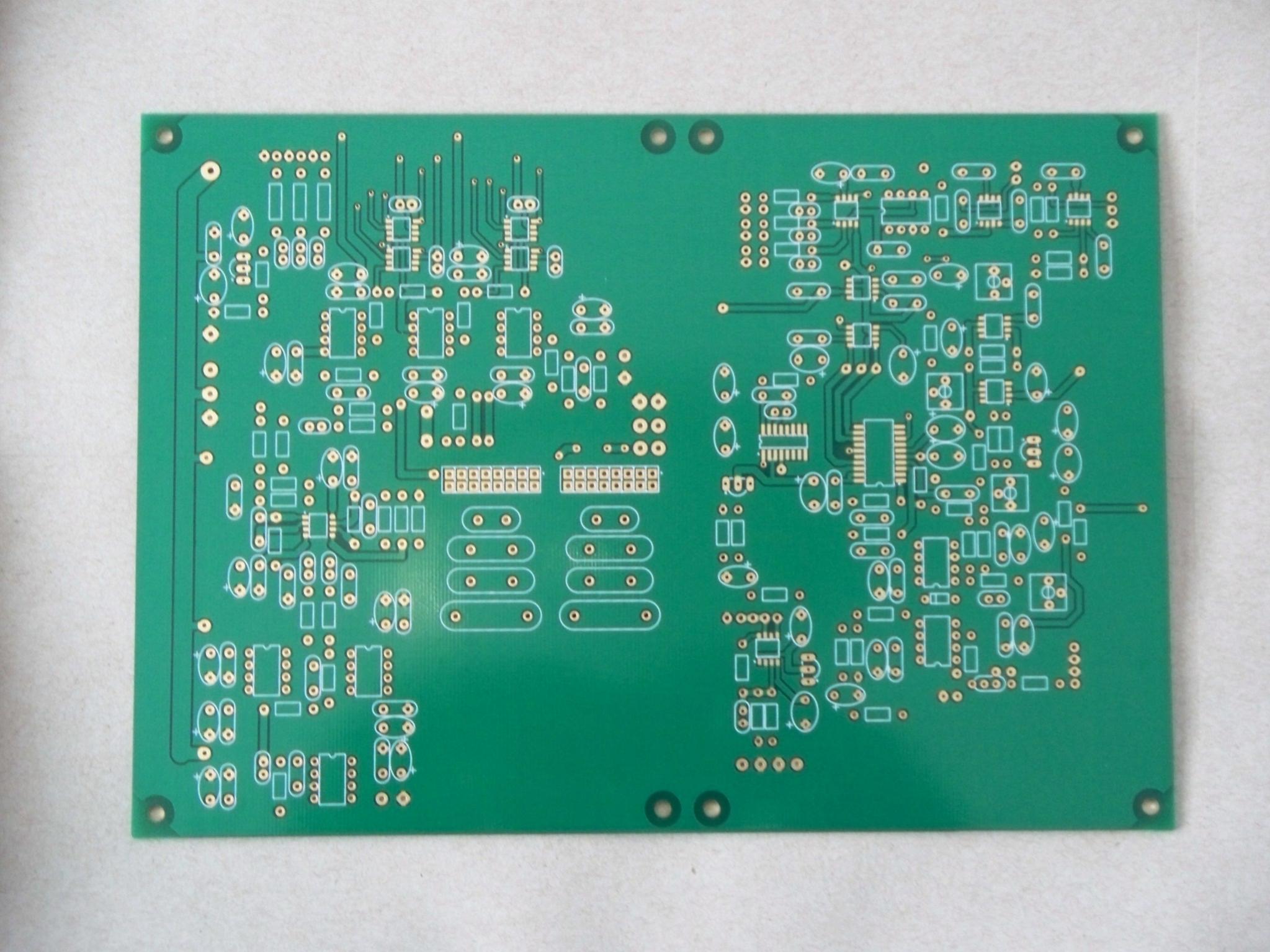

These are development boards. I panelized them to save setup charges.
There is one big booboo, see if you can find it. These are from Make PCB in China. I'm not 100% satisfied but these will do. They seem to have trouble getting the holes centered with the pads.

I have used Make PCB a lot, and you are right that putting the holes in the middle is not their strongest skill. They also have the most hilarious order status system, but very reasonable priced.
Why do your two layout panels share the same gnd plane? Isn't that taking Ott's points too far? ;)

There is nothing intrinsically better about a shunt regulator. The single clear benefit is unambiguous clear indication of where they are connected. Audiophile cred often has no basis in reality and fails miserably when really put to test.
For a USB powered device the lack of efficiency is a real issue.
The TL431 is a great device but its not very low noise. The circuit I posted early in this thread is about as low noise as is possible (1 nV/rt Hz) with an active regulator and optimized for oscillators. It also has much higher line noise rejection than a shunt regulator, really important for oscillators.
I have a variation that is a shunt regulator, attached.

Thanks for your input. I am just toying around with different ideas, but ADP151 being the baseline it seems like there are many good options out there. I believe I have found your other regulator here: http://www.diyaudio.com/forums/digi...sb-interface-audio-widget-52.html#post2810970 - is LT1431 better than Onsemi TL431?
BTW: You are right about the Audiophiles. One of the best one I have heard so far is about the importance of which way you place resistors - can't remember if tolerance band needs to be in or against the direction of the signal. But not to worry, you can hear the difference - especially if you have a high end fuse in your circuit. ;)
EDIT: And regarding USB, I plan to use another supply, so that is not really a concern for me.

Because they are two boards. I.m cutting them down the middle.

The shunt will draw whatever is necessary to pull the supply down to the target voltage. Efficiency be damned if you are going this route. Its the least efficient regulator possible. . .
R9 is a simulated load. That's where most of the current is going. Remove it and add your circuit there.
I have not looked at or run the simulation in a long time. The series resistor from the 5V supply is what controls the current.

David, one thing you might consider in designs like that is to add a straight V-cut line down the middle. The the boards are going to come apart nicely. The other alternative is to use a routing tool >2.0mm between breakaway tabs.
Some board manufacturers want to charge extra because they see that there are now two boards in one production panel. But it is easy to find ones which don't charge more. I've used PCBCART - Professional China Prototype PCB Manufacturer quite a bit.
