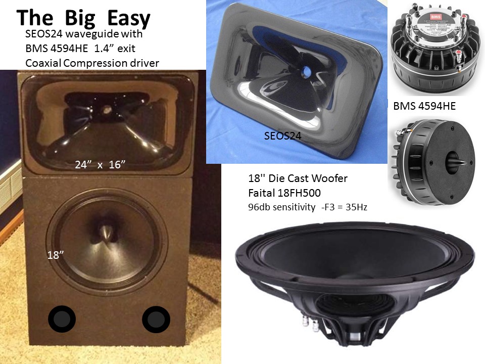

In case a couple pictures would help the discussion:
Big Classic 3
Big Easy

You can even get away with a 2-way (monitor) if you use such a large format horn like the SEOS-24. I have project slated that will use an 18" woofer and the SEOS 18 horn with the DIYsoundgroup DNA-360 CD plus an active crossover. The particular 18 I am using is pretty good up to 1kHz - almost unique in that way. I am hopeful that I can cross over at 1kHz and get smooth on and off axis response. At the same time, the woofer won't do well below about 100Hz, so it might need to be paired with subs to dig low. But the main goal was pattern control and not LF extension.
Also, if you are planning to use pro drivers or make a high efficiency vented-box 3-way with a 15 or 18 woofer be prepared to use a rather large cabinet. I have always been a bit skeptical of the "Maximus 18" design from DIYsoundgroup. Seems a bit too small of a cab... Something more like the JBL 4545 looks to be more on target. That could really be a sperm killer!
