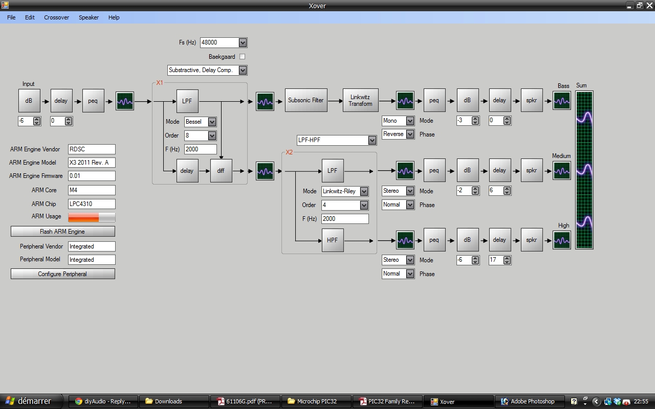

As for the software for the DSP manipulations - i'm working on something related to this...
Graphic Filter Designer
The idea is to simulate the analog circuit in digital domain with a PC, and then "compile" it to different targets
- Analog boards
- DSPs
You'll be able to design the filters for DSPs alone, if you use digital-only filters (delays, or non-textbook biquads or whatever else. No FIRs... )
I've got signal chaining, control points, biquad graphing, and a loop of control point>change of parameters of filter>generation of biquad parameters>chaining of different biquads>graphing in a single mouse stroke.
Graphing of FR is ready too
+ FFT with windowing functions.
Windows only...

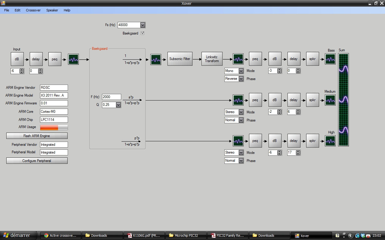

Wonderful ! Would be nice to have a crossover signal flow like the one I've attached. Is it feasible ?I've got signal chaining, control points, biquad graphing, and a loop of control point>change of parameters of filter>generation of biquad parameters>chaining of different biquads>graphing in a single mouse stroke.
Graphing of FR is ready too. Also FFT with windowing functions. Windows only.
