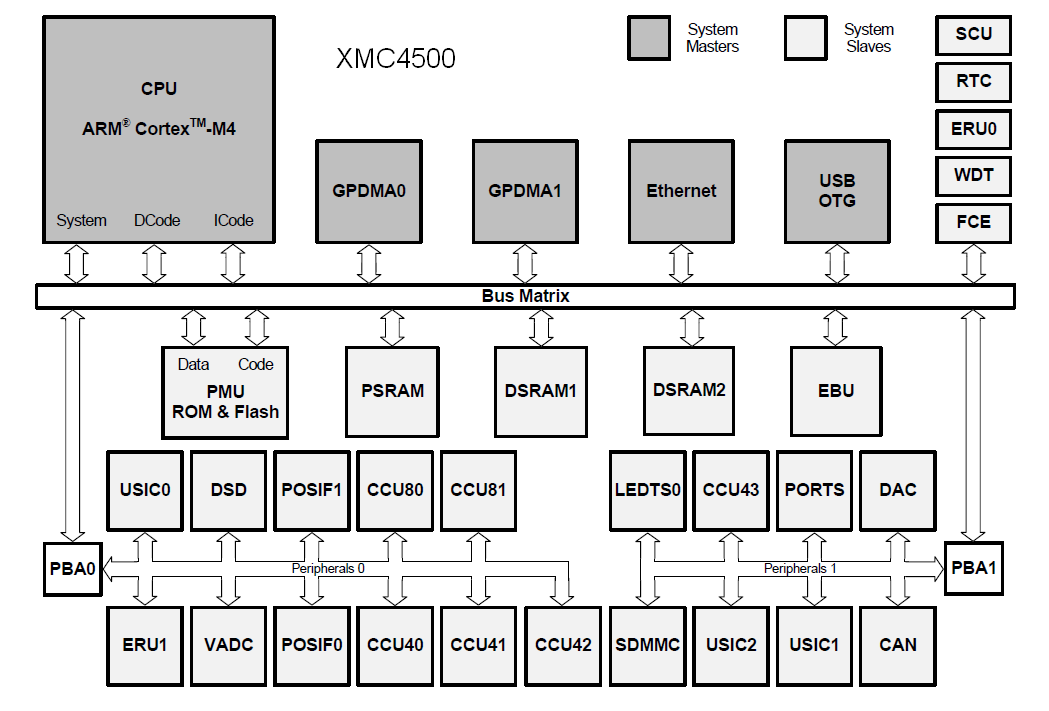

Let's see how a WM8580 "multichannel audio codec cape" would connect on the XMC4500 Relax Lite Kit available from HITEX, costing 10 euro (without shipment and tax).
The WM8580 cape would feature a local quartz, connected to the WM8580.
The WM8580 features an internal PLL generating all audio clocks, including MCLK.
The WM8580 would act as I2S master, sending the I2S bit_clock and I2S frame_sync to the XMC4500.
Consequently, the XMC4500 doesn't see MCLK.

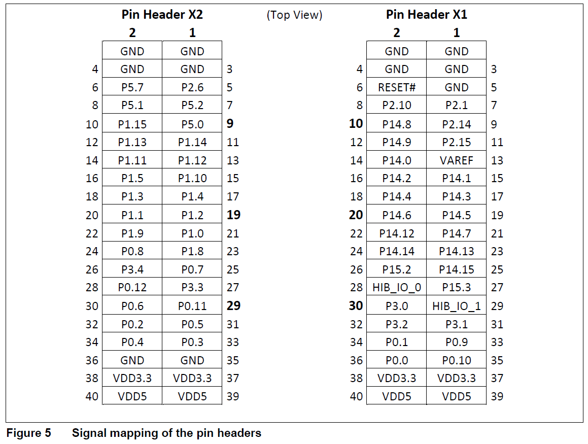

Viewed from the XMC4500 Relax Lite Kit :
Pin Header X2 delivers :
- two full-duplex I2S (slaves)
- one SPI (master)
Pin Header X1 delivers :
- one full-duplex I2S (slave)
It could be that hacking pin 17 and pin 19 on IC200 footprint, one may get as extra :
- one I2C
Thus, the XMC4500 Relax Lite Kit + WM8580 cape would implement a stereo 3-way Xover :
- taking one I2S as input (audio may come from the WM8580 SPDIF-in, or from the WM8580 stereo ADC)
- delivering three I2S as outputs (six line-level analog channels out).
Volume control would be done using the WM8580 output level registers.
There could be a connector for adding an external high quality multichannel volume control, such connector carrying SPI plus chip select, or I2C.
Asynchronous USB audio could come later on, using a second "cape" featuring a second XMC4500 dedicated to the USB protocol, requesting stereo audio samples with the same WM8580 still acting as local, master audio clock and multichannel DAC. One could add galvanic isolation at this stage.
What's your opinion about this?

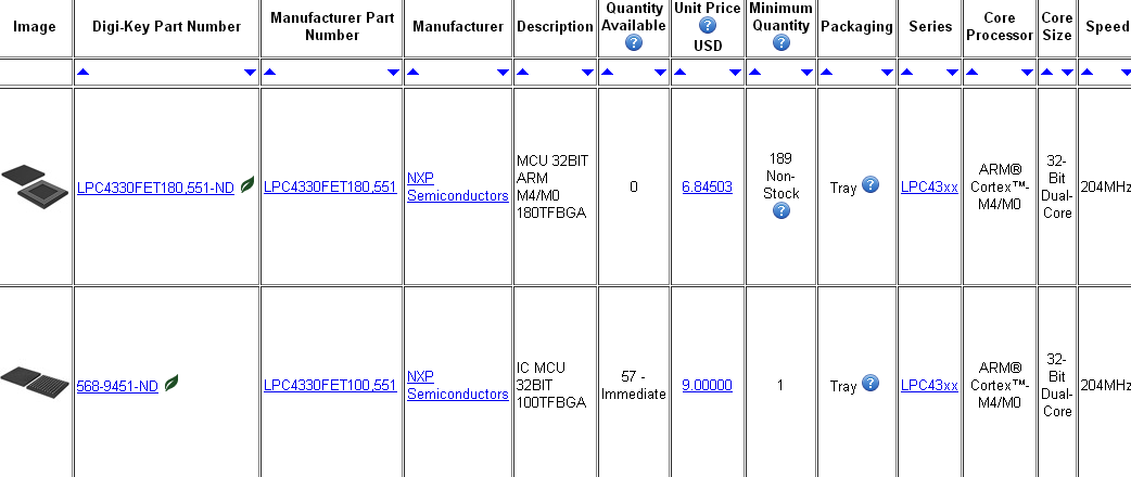

Is XMC4500 fully available now?
I would say yes. See the attached screenshot from Digi-Key. Quite amazing, the XMC4500 Relax Lite Kit from Hitex (10.00 eur = 13.80 dollar) is about the same price as one bare XMC4500 chip from Digi-Key (13.60 dollar). However, the XMC4500 Relax Lite Kit from Hitex embeds two XMC4500 chips : one for the breakable programmer/debugger, and another for the target. Let's hope the XMC4500 price is going to significantly drop. This reminds me the very first STM32F4 prices, about 15 dollar. Now you can buy STM32F4 versions for 11 dollar.

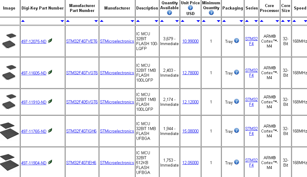

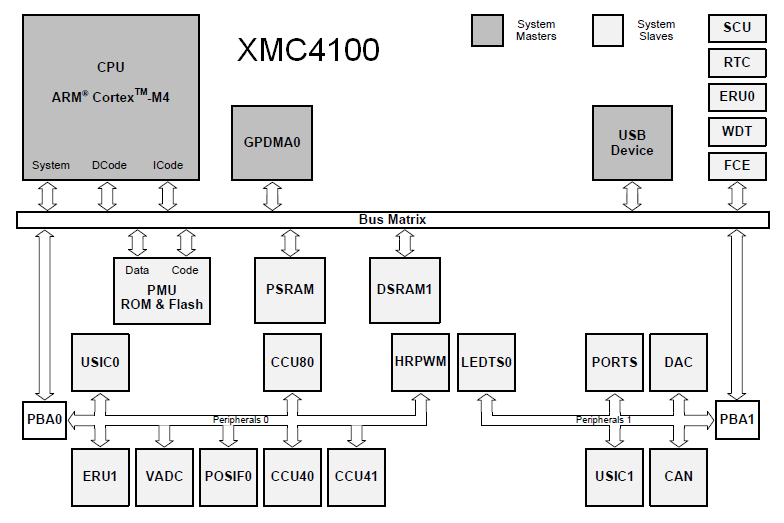

From a quick look through the DS - its just a bit complex as a starter M4 chip for me, and rather power hungry at around 100mA. Much more suitable for my current needs is the 4100, with 24mA Isupply and fewer pins on the packages. It really reminds me of the TI M4s (uncanny that its also 80MHz) which never really arrived. Is it available and what's the price?
STM32Fs are still too expensive for what they are. Freescale and NXP are better value although NXP lacks a real low-end M4.

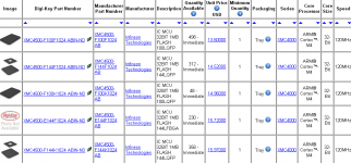

Much more suitable for my current needs is the XMC4100, with 24mA Isupply and fewer pins on the packages. Is it available and what's the price?

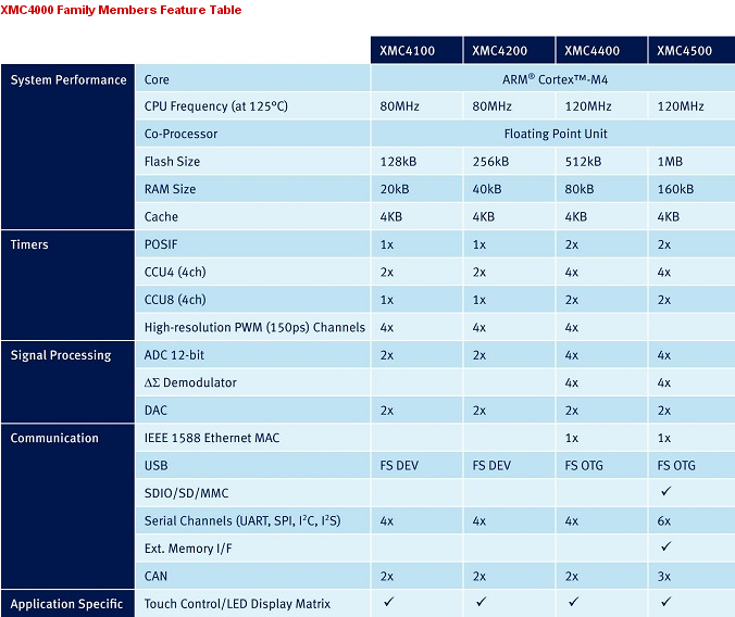

Very nice finding, kind of poor man's XMC4500. Only two USICs. Let's try the following XMC4100 USIC allocation :
- U0C0 as SPI master (controlling Codec registers etc.)
- U0C1 as I2S
- U1C0 as I2S
- U1C0 as I2S
This way we get a stereo 3-way crossover (6 analog line out), something a STM32F4 can't implement (it only features two I2S).
Unfortunately, the XMC4100, XMC4200 and XMC4400 are not yet available.
Currently, the only available parts within the XMC4000 family are the XMC4500. They feature three USICs.
