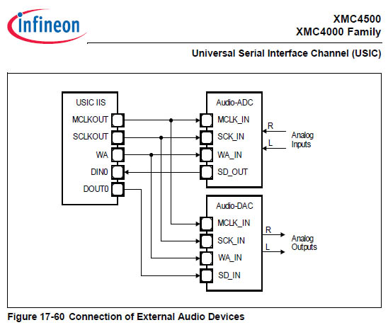

For connecting a WM8580 containing two ADCs and six DACs, the following lines are needed (viewed from the XMC4500) :
- I2S_data_in1
- I2S_data_out1
- I2S_data_out2
- I2S_data_out3
- I2S_SCLK
- I2S_WS
- I2C_SCL (as control bus)
- I2C_SDA (as control bus)
Can somebody advise me how to assign the USICs on the Infineon XMC4500 Relax Lite kit ?

The Relax kit board user manual (Infineon Technologies ) shows in figure 6 example of the pin mappings though it is missing data inputs pins. You have to download the XMC4500 Reference Manual and look for the needed pins and deside the mapping you will use (there are usually several alternatives). Manual can be found here:

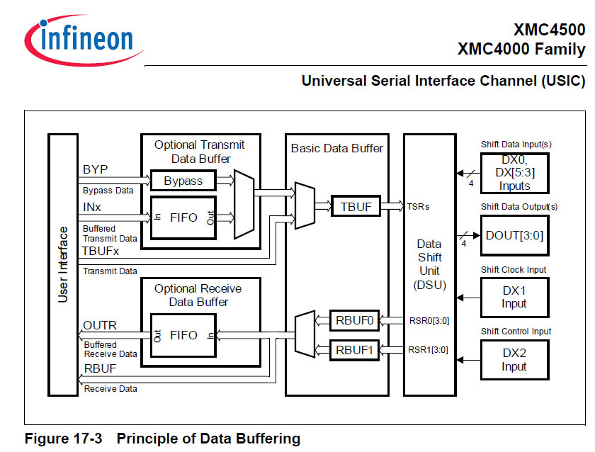

Reading more than 100 pages, I still don't know what the advertised "6 x I2S" really means. At the moment, I don't care about the pin mapping. At the moment I need to know what the advertised "6 x I2S" really means. I'm not going to invest time, dealing with pin mapping, before I understand the advertised "6 x I2S". Currently, as you wrote, the Relax kit board user manual (Infineon Technologies ) shows in figure 6 example of the pin mappings though it is missing data inputs pins. Currently, DAVE is not able to setup the USICs as I2S. There must be a catch somewhere.I went digging the XMC4500 Datasheet and XMC4500 Reference Manual, trying to figure what the advertised "6 x I2S" really means.

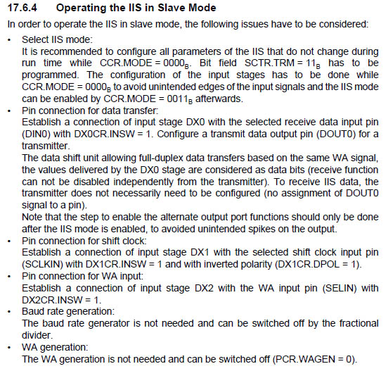

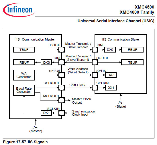

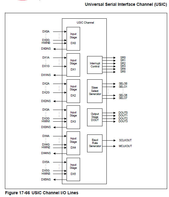

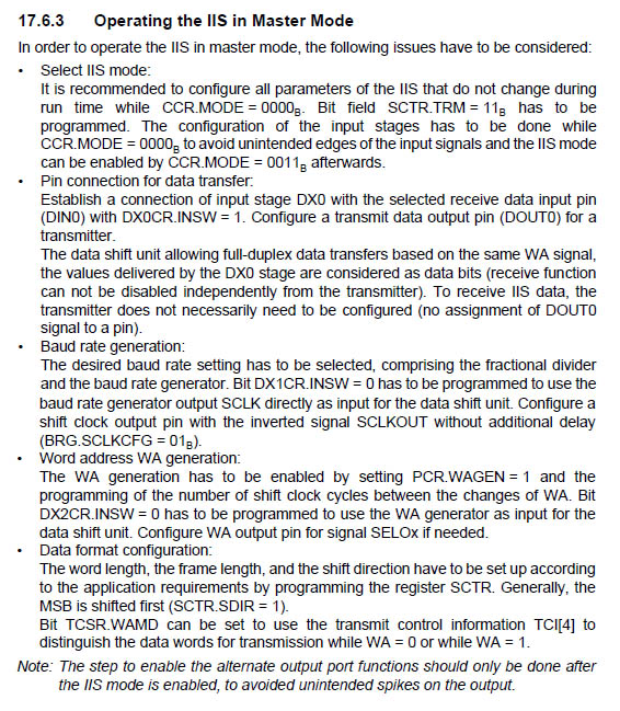

Sorry, don't understand what you mean with "assign the USICs". Anyway, each of six USIC channels, two per each independent USIC (3x2=6) have independent address space, see 17.11.1 Address Map
Table 17-20 Registers Address Space
Module Base Address End Address
USIC0_CH0 40030000H 400301FFH
USIC0_CH1 40030200H 400303FFH
USIC1_CH0 48020000H 480201FFH
USIC1_CH1 48020200H 480203FFH
USIC2_CH0 48024000H 480241FFH
USIC2_CH1 48024200H 480243FFH
So you can connect your I2S_data_in to for an example USIC0_CH0.DX0A input, or any of these:
Table 17-22 USIC Module 0 Channel 0 Interconnects
Input/Output
I/O Connected To Description
USIC0_CH0.DX0A I P1.5 Shift data input
USIC0_CH0.DX0B I P1.4 Shift data input
USIC0_CH0.DX0C I P4.7 Shift data input
USIC0_CH0.DX0D I P5.0 Shift data input
(there are more input "pins" like loopback and XTAL but not very useful)
Likewise output goes to output USIC0_CH0.DOUT0 (multiple locations), or generally to USICn_CHy.DOUT0 where n=0,1,2 and y=0,1.

Question : for all six serial interfaces, how to get the control signals SEL0 and SCLK ?
Infineon is advertising "6 x I2S".
Do they mean "6 x full duplex I2S" ?
Configuring all USICs as I2S, is it possible to sync all six I2S on a common Frame_Sync and Shift_Clock ?

I haven't studied output pinning but I think you can select mode for each pin separately. I would prefer ALT modes because I2S doesn't need HW modes (don't know which interface or protocol requires them but some will). Input pinning, well it's quite free. Regarding the channel protocols you control them via CCR.MODE register, thats Channel Control Register, so I assume you can select different protocol for each channel if needed:
CCR
MODE [3:0] rw Operating Mode
This bit field selects the protocol for this USIC
channel. Selecting a protocol that is not available (see
register CCFG) or a reserved combination disables
the USIC channel. When switching between two
protocols, the USIC channel has to be disabled
before selecting a new protocol. In this case, registers
PCR and PSR have to be cleared or updated by
software.
0H The USIC channel is disabled. All protocolrelated
state machines are set to an idle state.
1H The SSC (SPI) protocol is selected.
2H The ASC (SCI, UART) protocol is selected.

It's good idea to think which serial protocols are needed first. I2C or SPI for DAC/CODEC control, yes. Then how about UART, do you want to update the biquads using simple UART terminal? How about USB, could it be used for downloading filter coefficients? Does USB need isolator to avoid ground loops (off topic but good question if you are planning to use USB)?
If one I2S is master then other I2S channels can be slaves and for sure can be synched (though may need external links). There may be other ways but I'm not sure. I haven't ordered those kits yet because I'd like order them from Mouser with other stuff to fullfil the 65 EUR limit to get free delivery at least (must pay the VAT unfortunately here in Europe). LPC4300 looks better because of the speed and SGPIO, though there may be some hidden things preventing good performance. For an example the XMC4500 does have internal cache which is excellent thing at high clock speeds. I don't know if anyone has tried overclocking them yet (if that's possible), but at least the performance wouldn't be lacking because of the need to use wait states to read program code or data from slow flash. Anyway the XMC part looks good, it seems to be better for xover application than STM32F4 because of the USIC's. The DAVE might make programming easier when it gets I2S support - it might be good idea to download the software and try to use it if not for I2S then for I2C or SPI, it might be the generated code is easy to change to use I2S protocol by changing just the CCR.MODE setting and pinning.
Then there are at least two ways to handle the I/O buffering - either use FIFO or DMA. FIFO is simpler to start, but it's difficult to evaluate the performance. Maybe you can enable some GPIO pins and output some strobes and look with oscilloscope how long the subroutine takes time.
