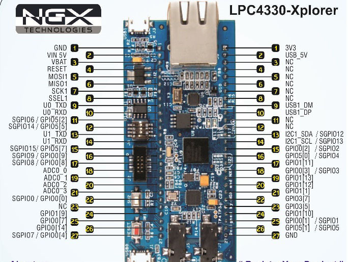

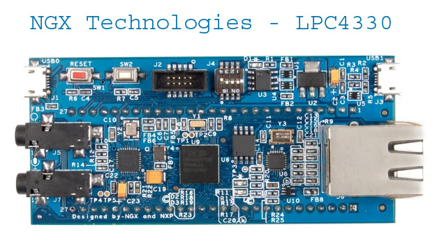

Open Source DSP XOs

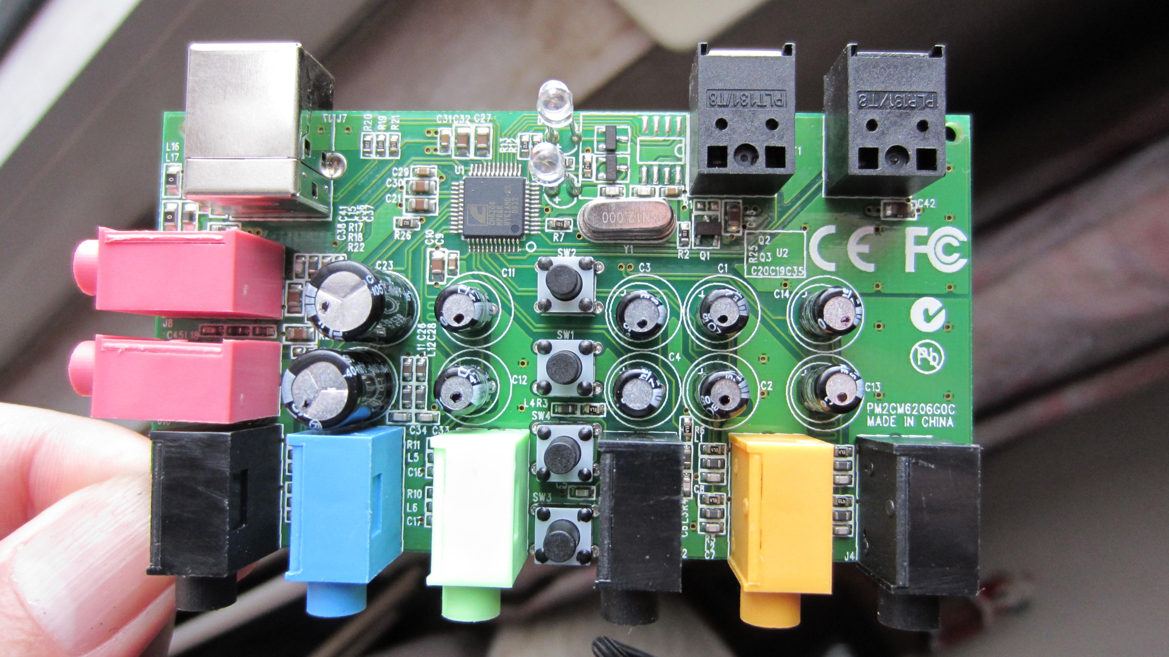

For audio enthusiasts like we have on diyAudio, the silicon that we need is the digital engine sitting in the SWEEX SC016 silicon (thus, without ADCs and DACs), upgraded to 24bit/96kHz. No doubt it will come in due time, inexpensive, as this is a mass market.
One may consider a group buy if such silicon remains ignored by Digi-Key, Mouser and Farnell.
In the meantime we may try hooking the SWEEX SC016 on CuBox or Raspberry Pi.
Later on we'll base on this experience for hooking the SWEEX SC016 on a Android 4.0 device.
A purely software affair, thus !
The CuBox and Raspberry Pi solutions are no short-term solution. They are suited to active speakers, embedded into active speakers. Cost remains low because of no graphical user interface..
The Android 4.0 solution would provide a high quality user interface, easing the setup. Especially using a 10 inch tablet and a physical keyboard, as development system for the XOver.
Once the Android 4.0 solution is completed, there would be a way to migrate it on CuBox and Raspberry Pi.

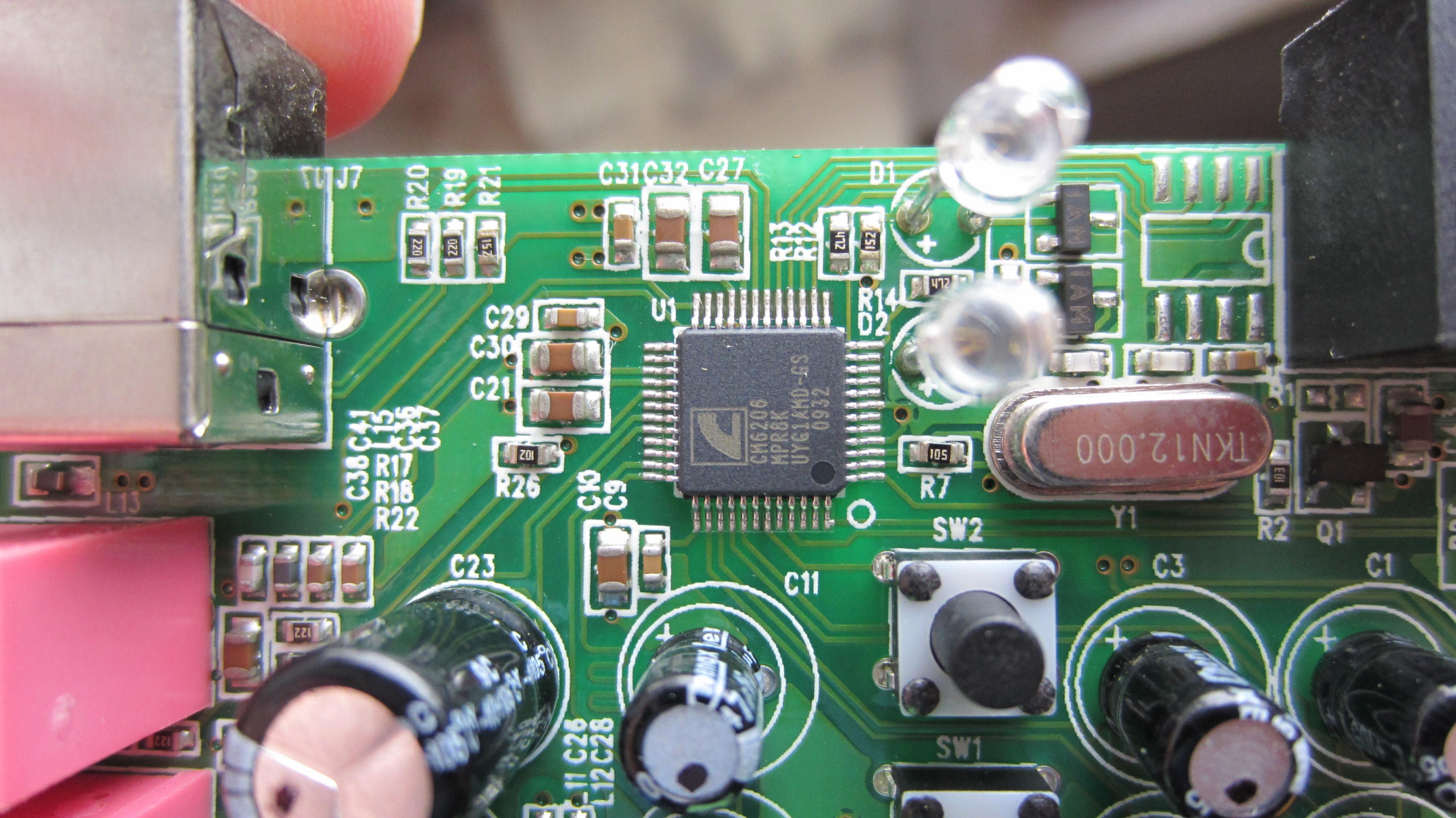

Cmedia CM6620 is a USB2.0 high-speed audio processor that can support the latest USB Audio Device Class Definition V2.0 and 7.1-channel true high-definition audio and Line-In/Mic-In (all up to 192KHz/24bit). The problem with the CM6620 is that it provides an HDA link (Intel High Definition Audio) instead of four I2S lanes or one TDM.
The VIA VT1730 is an USB 2.0 (480 Mb/s) 8-channel, 24-bit/192 kHz audio controller specifically designed to achieve cinema-quality audio recording and playback in high fidelity USB applications. The highly integrated single chip USB audio solution is embedded with a number of crucial modules, including a standard 8032 MCU core, USB transceiver, five I2C masters and one slave controller, an I2S controller, a serial flash controller, four SPI ports, phase locked loop (PLLs) with internal oscillator, and a 3.3 V~2.0V regulator. The VIA VT1730 supports multi-channel PCM digital audio format up to 24-bit resolution and 192 kHz sample rate. An S/PDIF interface with two stereo output ports and one stereo input port supports up to a 24-bit resolution and 192 kHz sample rate.
Are there other USB 2.0 audio controllers nowadays, outputting four I2S lanes or one TDM ? Equipped with a S/PDIF input ?
Are there people writing Android 4.0 drivers for USB 2.0 audio controllers ?

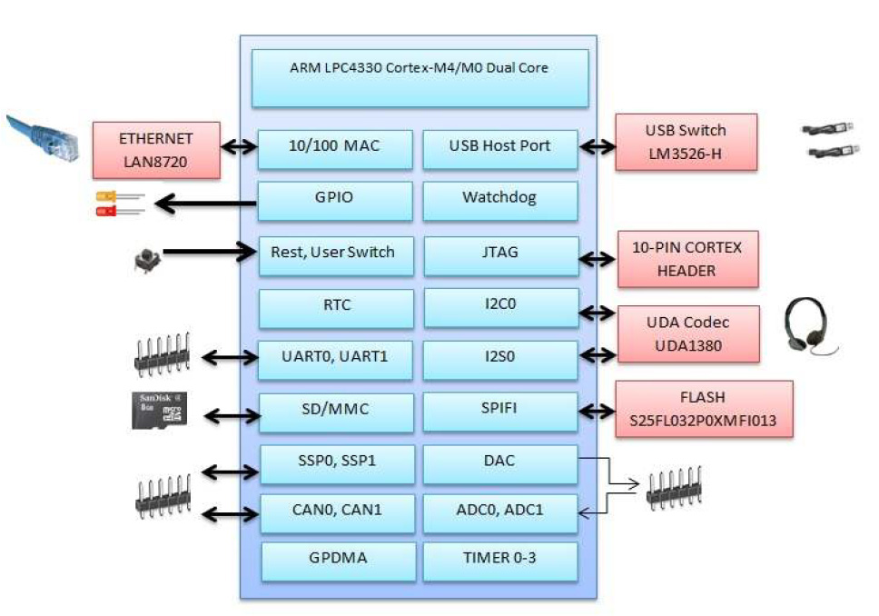

So, what about hardware?
Should we really stick to PC+USB thing? PC+PCI are easily obtainable, with 4 I2S outputs, slaving ability etc, so if we are going with PC, why not? There is no logical difference between USB and PCI - PC is always there.
And if we are going for less than 100% best DACs - then PCI multichannel cards are fine for us...
Yet, PC thing is bad - that's why we want stand-alone hardware DSP.
If we won't target the CPU-hungry FIRs (and we won't - with available cheap-end CPUs and DSPs), we are goind with IIRs.

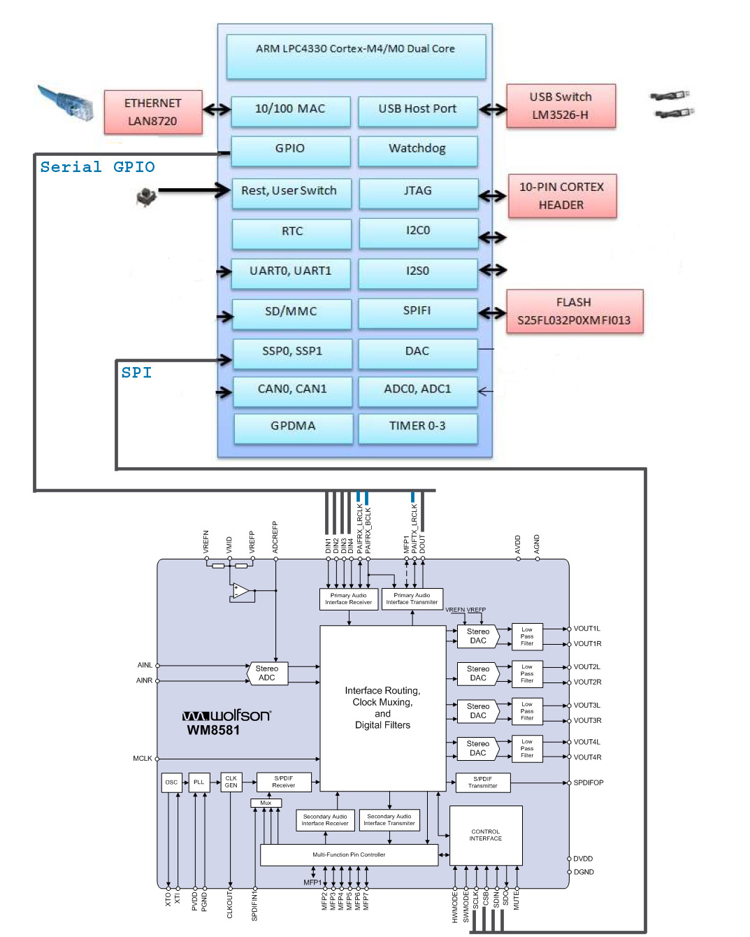

So, we need
1. PC Software to configure the different filters - plotting, measurements, filter generator.
- It depends how far we'd like to go. Fist of all, scale-ability, opennes on Math side, user friendliness.
2. DSP core - embedded software in C for MCUs or DSP code for specific DSPs.

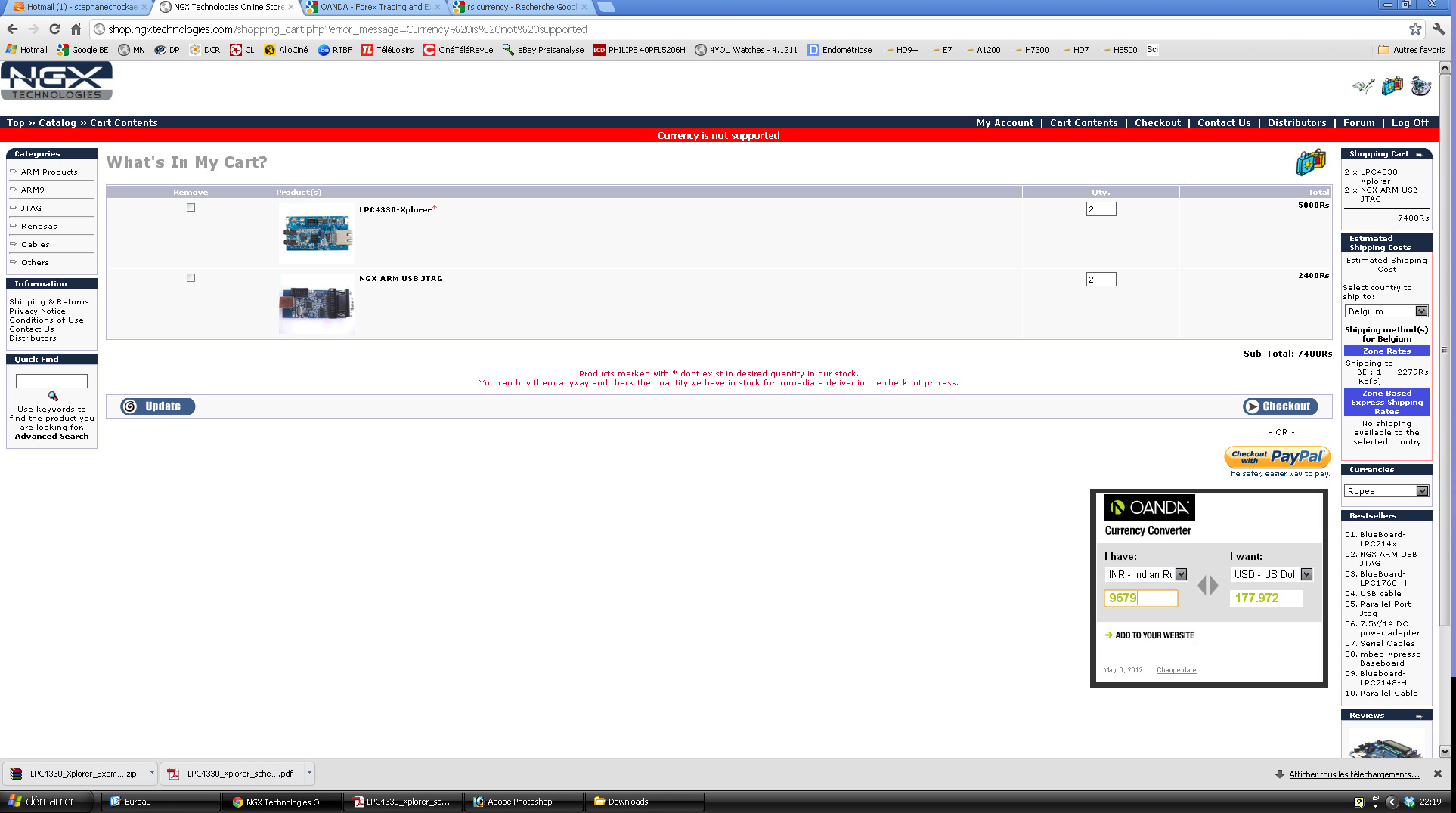

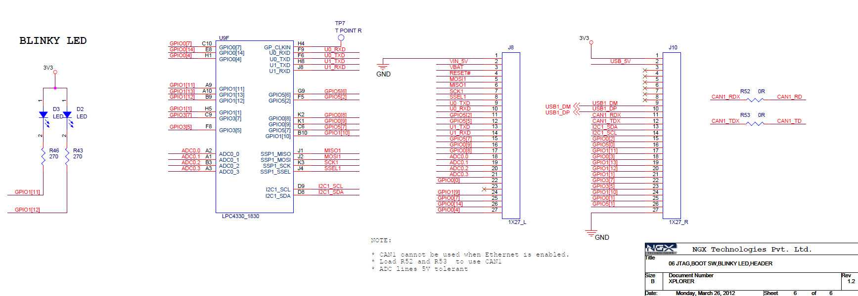

Pricey... 170$ for just a CPU is plain pricey...
From price point of view, Android device would be much better choice for the same price range. If you stick to some standart I/O bus (HDMI, USB), then you get hardware-independent solution, with Android as DSP and media player (touchscreen, WiFi, LAN, USB Host, memory). Add a squeezebox player app, and you're done implementing LAN DAC.
There is a GPU which could do the DSP processing just like a CUDA does...
NXP LPC4330 is pricey, 170$ for just a CPU is plain pricey.
Look again : the order I've made is about two LPC4330 Xplorer, two USB->JTAG converters, plus worldwide shipment.
As developer, you only need one USB-JTAG converter during the whole project life. I ordered two of them in order to avoid an interruption in the development cycle, in case I commit a fatal hardware mistake. Same approach for the LPC4330 Xplorer : I ordered two of them, as a safety precaution.
Once the LPC4330 gets programmed, the micro-USB connectivity would be used (along with a small PC application possibly written using Visual Basic), for changing the crossovers parameters. If you are not a developer, you don't need the USB-JTAG converter. If you are not a developer, you only need one LPC4330 Xplorer.
The micro-USB connectivity can be used as power supply.
A standalone 3-way stereo crossover with S/PDIF input and analog input could be built using :
- one audio-PCB used as motherboard, hosting an audio-grade voltage regulator, a WM8580 Codec, and the audio connectivity
- one LPC4330 Xplorer carrierboard plugged on the motherboard using the 2 x 27 pin headers
Mouser is currently supplying the WM8580 in 250 qty for $7.74, delay 18 weeks.
A standalone 4-way stereo crossover with S/PDIF input and analog input could be built using :
- one audio-PCB used as motherboard, hosting an audio-grade voltage regulator, a WM8581 Codec, and the audio connectivity
Mouser is currently supplying the WM8580 in 250 qty for $7.53, delay unspecified.

I'm still convinced that attaching a SWEEX SC016 on the USB-host of a PIC32 carrierboard or ARM Cortex-M3/M4 carrierboard is an interesting way to build an Open Source DSP XO featuring the S/PDIF-in and the analog stereo line-in. Not high-end, good enough for experiments.
How much for the SWEEX SC016 nowadays ?
Less than $25 on eBay, excluding shipment.
Absolutely required for such job, is the CM6206 datasheet from Cmedia.
Website here : C-Media Electronics, Inc.
Where can we find such datasheet ?
What carrierboards are available, equipped with a USB-host directly connecting on a 32-bit processor having DSP aptitudes ?
- STM32F4 discovery at $17 (Mouser USA)
- Embedded Artists LPC1769 LPCXpresso (need to solder a USB connector on J6-36 and J6-37) at $33 (Mouser USA)
- PIC32 USB Starter Kit II (DM320003-2) at $55 (Microchip Direct)
- NGX LPC4330-Xplorer at $57 (NGX technologies website)
The carrierboard budgetary price is thus from $17 to $57, depending on the model, excluding shipment.
The NGX LPC4330-Xplorer at $57 currently is the sole and only carrierboard that could be reused for building a high-end stereo 4-way crossover, once installed on a dedicated audio motherboard featuring a better S/PDIF receiver and better DACs than inside the CM6206 chip. The reason is the LPC4330 Serial GPIO and Cortex-M0 coprocessor, able to deliver five I2S lanes (one as input, four as outputs).
If you intend developing software for the NGX LPC4330-Xplorer, you need an external USB->SWD (Cortex Debug) solution. The obvious solution is to use the ULINK2 (less than $35 on eBay USA) or the Embedded Artists LPC1227 LPCXpresso LPC-LINK (about $40). This is what NGX developers used for debugging the demo software accompanying the NGX LPC4330-Xplorer. Plus the required 10 wire cable terminated by the 2x5 pin female mini-header. Which is going to be standard for all new Cortex-M4 boards. The Keil µVision and the Code Red Suite 4 are essentially free of charge, when code size is less than 32K.
