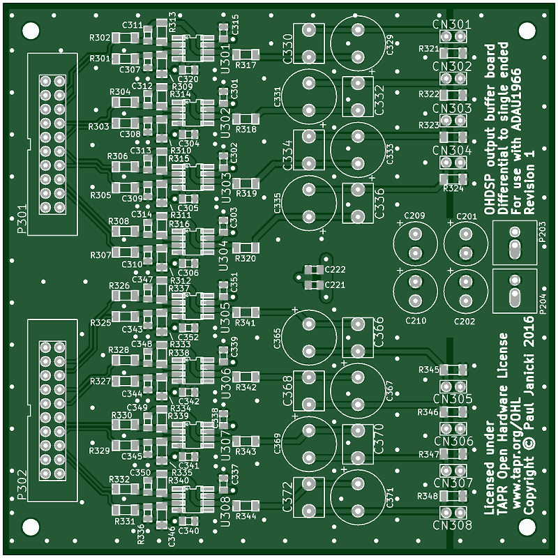

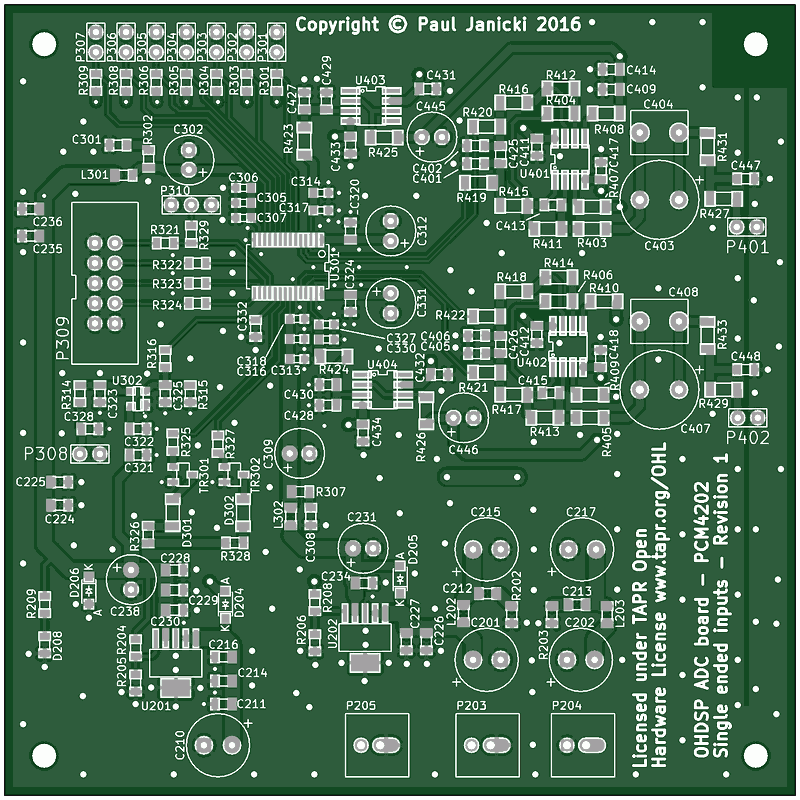

Congrats to the project and for using KiCAD. :D
You may want to overlook the pcb images on your website, which are quite "huge" pngs. (600kb)
I'll attach the shrunken down files.

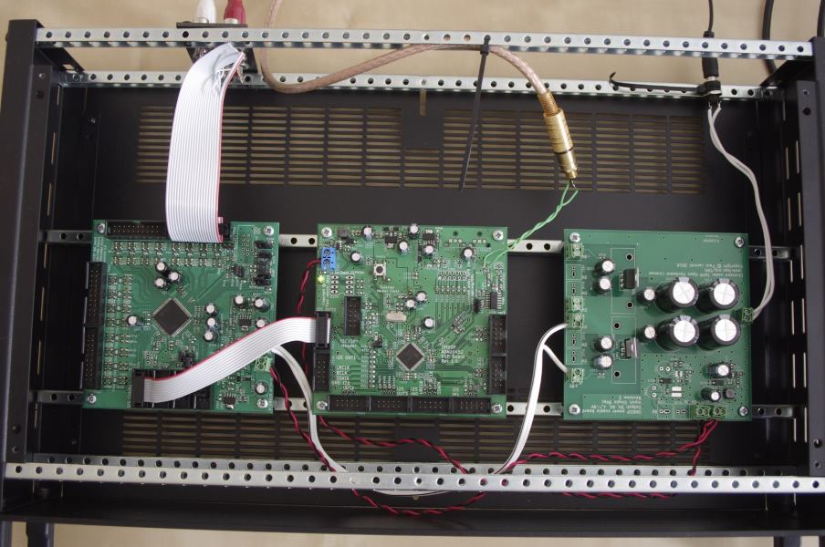

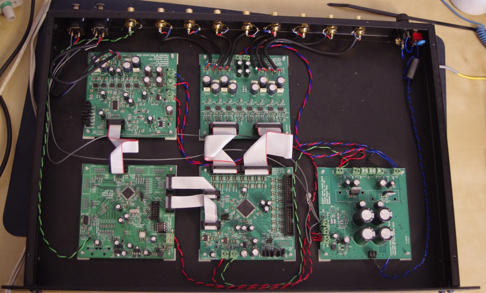

An SMD toaster oven may be a good investment if you fancy doing a lot of boards. I have been building up 8 of these boards (3 DAC, 3 DSP, 1 ADC, 1 PSU) and there are a lot of SMD parts...

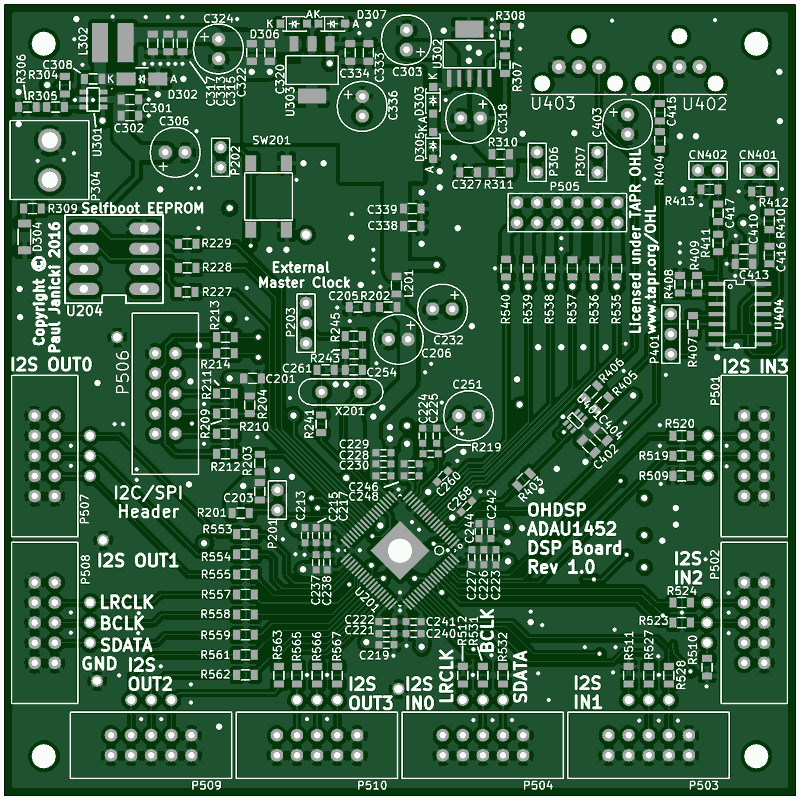

Soldering the ADAU1452 was ok, I put a large (3mm) via in the centre pad, fixed the chip around the sides and soldered up through the centre, 2 boards are fine although the 3rd looks like it may not have flowed as well as it should have, but that was just me being unsure having not used this method before.
I have boards up and running now. Feeding the ADAU1452 from a SPDIF output and into the ADAU1966. I have connected a headphone amplifier to the positive outputs of channel 1 and 2 on the DAC (only passive filters). The ADAU1966 sounds very good. Very very good in fact, given its a 16 channel dac chip for less than £8. It is also seems happy driving long spindly unbalanced phono cables with no buffering.
I have not tested everything yet but this is a good start! And a good sounding start at that as well.
Here is a (bad) video of my test setup running on a bench supply, on some stupidly small table.... I do now have it running off of the real supply as well:
https://goo.gl/photos/qqrevPUD3Sfw4fRK8
All I need now is a decent workshop area I could setup in...

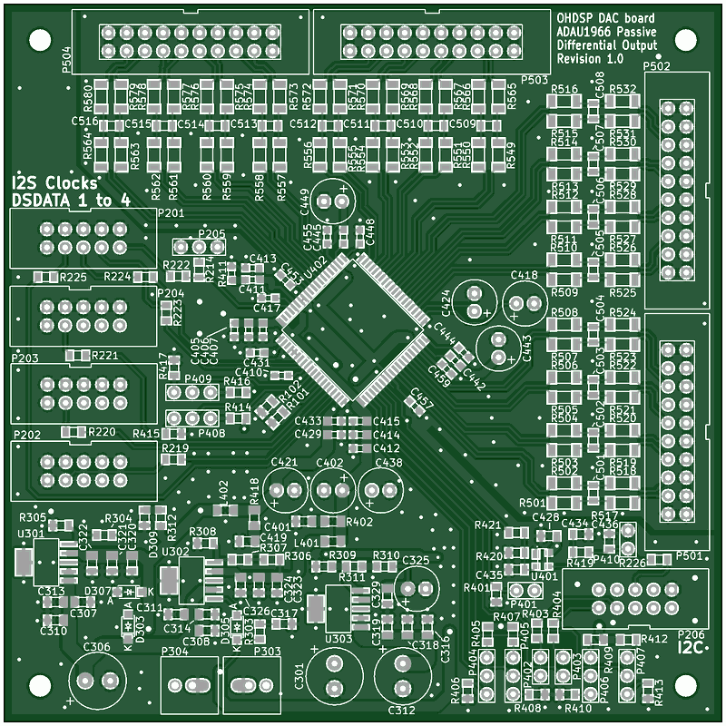

The 4 layer board is designed for a 0.2mm prepreg, 1.2mm core, 0.2mm prepreg stackup (core could be any thickness though). Boards are not impedance controlled but traces to IDC connectors are designed to have a ballpark figure to match with 26AWG ribbon cable driven in signal-ground-signal-ground config (but not 28AWG as I could not match that). The traces are quite thin (0.135mm/5.3mil) but a lot of manufacturers now support down to 0.127mm/5mil as standard. I would recommend DirtyPCB for the 4 layer board.
The 2 layer boards can be from anywhere, really does not matter. Traces are 0.3mm/11.8mil or thicker and the PCB thickness is 1.6mm as normal.
The boards I have are generally very good. Some silkscreen and a couple of holes not quite lined up 100%, also they sent 12 4-layer boards but 2 of them have the via's not seated in the board properly (copper sitting proud) which ruins the ADAU1452 footprint, but I did get what I ordered in usable boards.
There are mistakes on Release 1.0 boards but they do work, I will work on 1.1 boards with all the mistakes fixed and some minor tweaks to things like connector hole sizes.

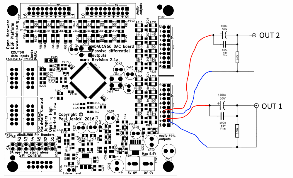

If you have a DSP and DAC board you can cheat and connect to the 0V and positive output of each channel on the DAC PCB. Leave each negative output unconnected. (or if you want to have the phase inverted connect to negative and leave positive unconnected). The output level may be a little high for some amplifier inputs.
You would need to add a dc blocking capacitor as the positive and negative outputs sit at around 2.5V. A 100uF aluminium electrolytic (Panasonic FC or other good cap) and 100nF polyester film in parallel would be fine.
A diagram will probably make it clearer; Have attached a sketch with added channel markings and two channels connected to phono/rca sockets.
Cheers

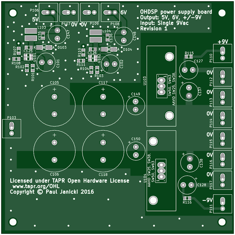

Also a 1A transformer would be fine; my speaker crossover box I have been testing seems to draw around 170 to 200mA from a 9Vac transformer. My transformer is rated 10VA at 9Vac on the secondary, so around 1.1A.
Edit: I should also point out that the PCM4202 ADC seems to have weak output drivers; I accidentally set my DSP and the PCM4202 to be outputs on BCLK, LRCLK and SDATA and now my PCM4202 is spewing out junk on the I2S interface. Just make sure you have the DSP setup properly before connecting the cable to the ADC!

I have my boards. All 50 lol . I was wondering if the ADAU 1452 can handle 3 channels in. I would use 2 ADC4202-se boards. I was thinking of my center channel .But i have not looked at the Sigma software. Can the software also handle 3 distinct channels to cross over ? The center channel is a 2way while my main channels will be 3 ways.
Thanks,
Carlos
Hi Carlos,
Good news with the PCBs, at least you won't run out :D
The ADAU1452 can support up to 48 channels in and 48 out through a mix of I2S and TDM interfaces.
The PCM4202 is I2S only though. But you could connect up 4 of these for 8 channels in.
Internally you can pretty much wire up the filters as you wish. Under SigmaStudio there is a routing matrix where you can tell an input to go to the Core, or through an ASRC (really useful for different clock domains).
With inputs routed to the Core, and outputs from the Core, you can "drop" input/output connectors on the main schematic. And then just connect up whatever filters/equalizers or other effects are needed in between.
