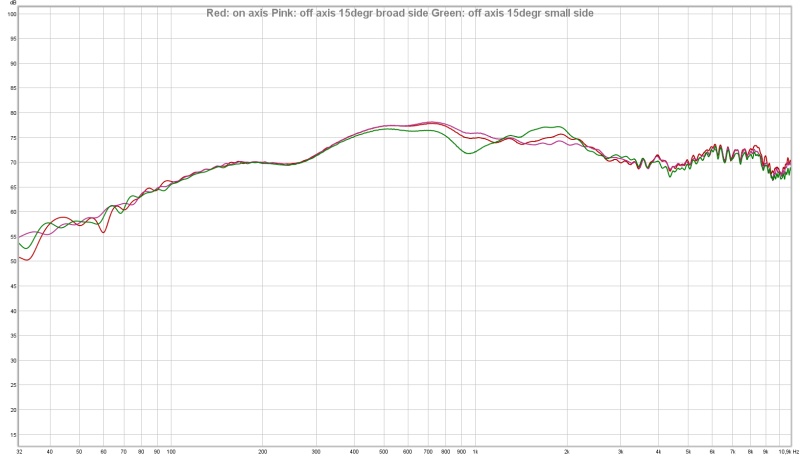

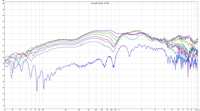

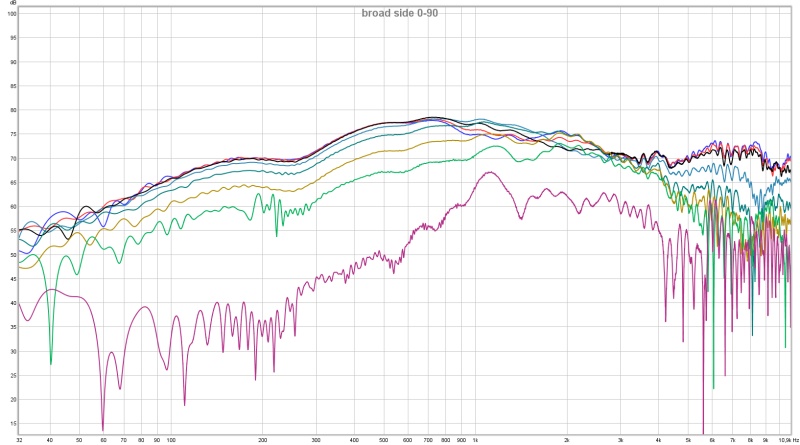

Now I have abandoned the assymetric baffle shape for a more traditional. It's still dipole/open baffle and new dimensions are: 180x26cm. The array is offset so cc of the driver to the small side is 8cm. I've experimented before quite a bit with different sizes and offsettings, and became so fond of the (possible) soundstage with one very small side (facing towards center). The more centered array on the baffle, the less depth was my impression. So aiming for this I came up with these dimensions in edge. It's made to get a good dispersion as high as possible and still not loose too much bass. So according to the excellent paper of Rudolf Finke (thanks Juhazi), off setting is a good way of handle things when the baffle needs to be a bit more than 3 times the driver size. Maybe you gain a bit both low and high then?
So, big questions are:
1. Will this be ok from about 100-200Hz up to 4Hz EQ'ed?
2. How to think about the small vs the broad side? Good or bad with offset?
3. What sort of filter/EQ (if this is a good start)?
Measurements as before (UMIK-1, REW), outdoors, 3m.
0-90 degress small side:
0-90 degress broad side:
on axis+15 degress off axis on small and broad side:
Any other comments or ideas are welcome!

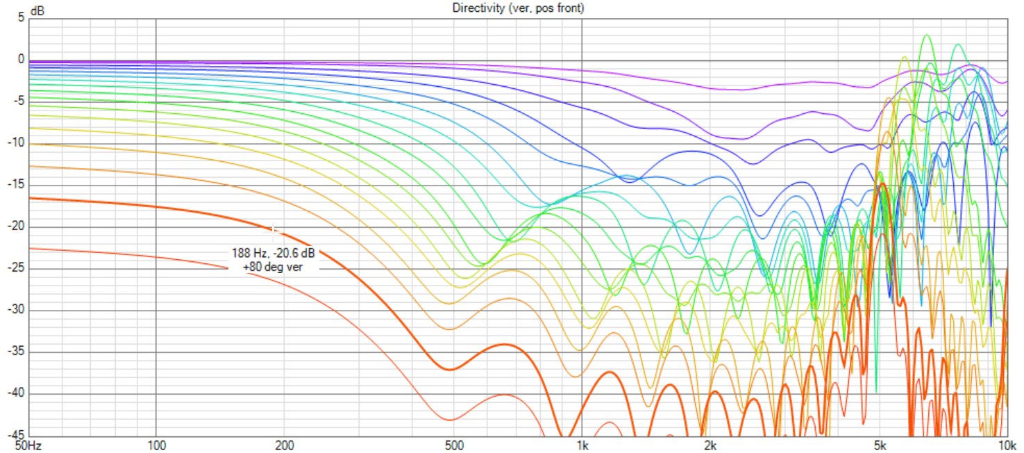

@diypole mentioned that dipole arrays are worth a look here: https://www.diyaudio.com/community/threads/another-improved-array-sep-2022.390605/post-7131505
I'm astonished that more people aren't doing this. The sims look absolutely ridiculous.
As time has marched on, I've noticed that dipole fans have been going for narrower and narrower and narrower baffles. For instance, the dipoles designed by Linkwitz in the 90s were nearly a foot in width, and his last dipole was just large enough for the drivers themselves.
@CharlieLaub has been doing some cool stuff with dipoles with NO baffle

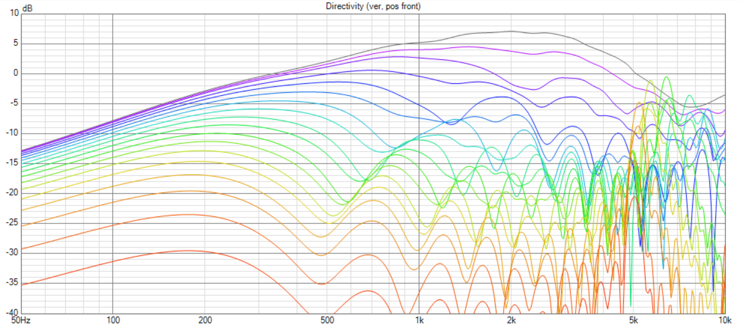

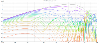

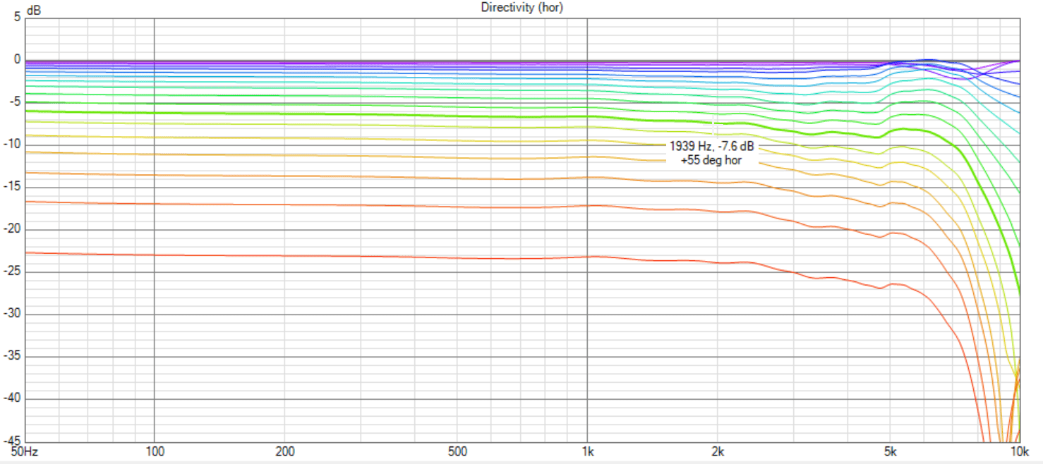

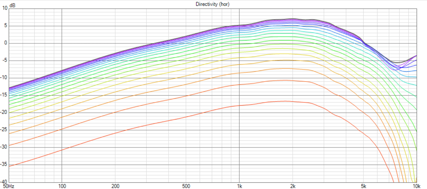

Here's some sims of a dipole line array that I did yesterday, using VituixCad (the instructions on how to model this were posted by @kimmosto here:
Attached are the predicted horizontal polars and vertical polars for a dipole line array. I did it yesterday, if I recall correctly it's 7.5cm wide with eleven 2.5" drivers. I've included the normalized and un-normalized responses.
It requires filtering to become flat, so DSP is a must. But it provides nearly ideal directivity using a baffle that's 7.5cm wide!!
Another intriguing thing about it, is that you get vertical directivity control, even with a very short array. IE, you would need an array that's 1.7 meters long to control directivity down to 200HZ if it's a monopole, but a dipole array of almost any length will do the same. It really just comes down to how much power handling you need; the more output you need, the longer an array you'll want. (Note that maximum output at high frequency is largely limited by the maximum output of a single element, because high frequency sources do not combine.)
I think one could improve on these results quite a bit if they power tapered the array, but I do not see any way to do that in Vituixcad. (I assume that it's not possible to combine individual dipole sources in Vituixcad like you can with monopole sources. I may be wrong.)
If I were going to design one of these things in real life, I think I'd figure out the power tapering in Vituixcad, modeling the array as a monopole, and then I'd use the narrowest baffle that I could live with.
