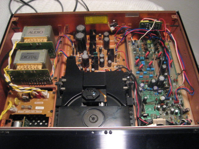

I swaped almost all of the opamps in my Sony 505 (apart from the OP27 which is for DC-offset control) with op213(2)4, OP275 (filter), LM6172 (IC4/501 with local decoupling, for I/U conv) and that kind of stuff but couldn't really hear much of a difference. I also upgraded the analogue power supply caps and added more capacitance directly on the board (C617-620). It was a lot of work to desolder all the opamps and put some DIP8 sockets in. The DIP-sockets don't really fit but you can make it work. I don't think it was worth it.
What really made a difference imho was to replace the digital decoupling caps around the DAC with os-cons.
All in all I was never satisfied with the sound of the Sony although I really like its mechanical appearance. It's a pity! May be the output stage is to complex? Or some jitter issues caused by multiple clocks?
I would say start with the digital and analogue power supply upgrades and than may be think a about a new (opamp less?) output stage.

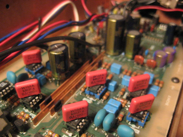

I tried replacing the 4 opamps (IC4/507 IC4/506 in X55ES) firstly with OPA2134 but was way too much, shouty and over the top but was better when only IC4/507 changed (last opamp) and the rest left as original (in this case 5532DD).
The best result was using AD825 on Brown Dog adaptors for IC4/507 and the remainder left stock. The sound became very smooth, great detail and seemed to dig deeper in the bottom end. A more controlled natural sound without the tizz and boom excitement.
Output caps C4/514 were changed to BG NX 47uF 6.3V and the by-pass C4/515 were removed. Power supply caps C508/C509 (I think) that fed IC4/507 were changed to Nichicon FG 47uF 50V. The supply caps C4/556 were changed to Panasonic FC.
Everything else is stock except to Toslink changed to an electrical digital out.

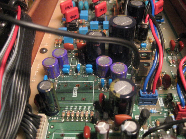

The digital decoulpling caps around the dac are: C401, C403, C503, C408, C508, C630, you get the idea.
When it comes to digital decoupling the quality of the caps and short leads/tracks are more important than quantity. I think I replaced them with 100uF oscons because I had them at hand. It's probably worth to solder some 10-100nF smd caps diretly at the pins where possible.
I can't remeber exactly what I did to the power supply. I probably replaced the caps with Panasonic FCs, apart from the main reservoir caps because I had nothing equivalent. I need to open the lid and have a look for more details.

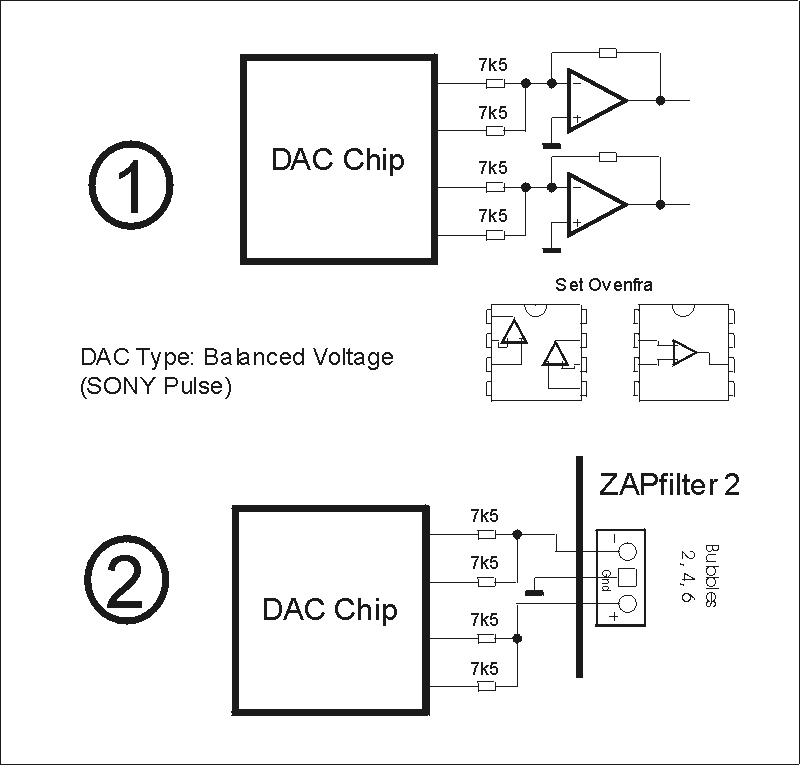

While I agree that rolling the op-amps may bring improvements (with a bit of luck) the results are highly unpredictable though. Combining PSRR, CMRR, noise etc of the op-amp with a specific layout, power supply and application schematic hardly gives an indication about what was achieved.
I'd like to suggest a different approach: a closer look to the filter caracteristics (type, order, cutoff freq.) and optimize these first before spending money on 12 single op-amps and adaptors or 6 dual op-amps. Most likely the improvements will be quite noticeable and you'll have the chance to control/corelate the results to your liking...

ZapfilterII - seconded
Couldn't agree more. I have the ZapfilterII in my Marantz CD-67SE and it made an enormous improvement.
In my implementation I put a 3rd-order low-pass passive filter between each voltage output of the DAC and input of the Zap. The DAC used unusually has unfiltered raw PWM outputs unlike most.
(A simple RC and then RCRC did the job too but sounded a bit rolled off, unlike the RCLC I settled on, which is flat to 20kHz.)

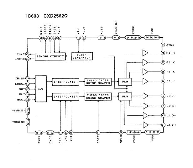

Futher more ..., ever noticed that the CXD2562Q DAC has an optional function ?
Digital phase inverter can be made by lifting pin no. 51 (DPOL) just needed to add an switch or relay for selecting hi/lo state
Usage of this feature can for some recordings make the overall performance of the stereo, raise to a higher level
Same metode goes for CXD2552 its pin no. 10 (POL)

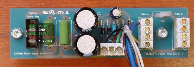

ATM my primary goal for improving the players sonics is the ZAPFilter PSU. Sigma22 should be easy to build, but not that easy to fit inside the player. An external enclosure should be possible to do, but is not my preferred solution. Please look at my measured voltage readings of the stock supply. This is about 23V symmetrical, plus an +23 V aux supply. I have the 230V european version.

Hi, yes the Zapfilter board gets very hot, as does the PSU board. All class A...
The PSU board is for rectifying and smoothing (the big resistors and caps form an RC filter). The regulators are on the Zapfilter2 board itself. These are high-quality shunt regulators! You don't want to be adding any more regulators.
Most of the parts on the Zapfilter board are for voltage regulation, DC servo, muting, etc. Not very much of it is actually directly in the signal path.

Glenn, do you know if the Sony CXD2562Q has "unfiltered outputs" too (i cannot find a valid datasheet for it) ? Or can we assume that it has some sort of filtering inside.. and nothing else needs to be done. See the audioboard schematic at my website:

I can soon create a picture showing how I currently have connected my zapfilter after the DAC chip..
