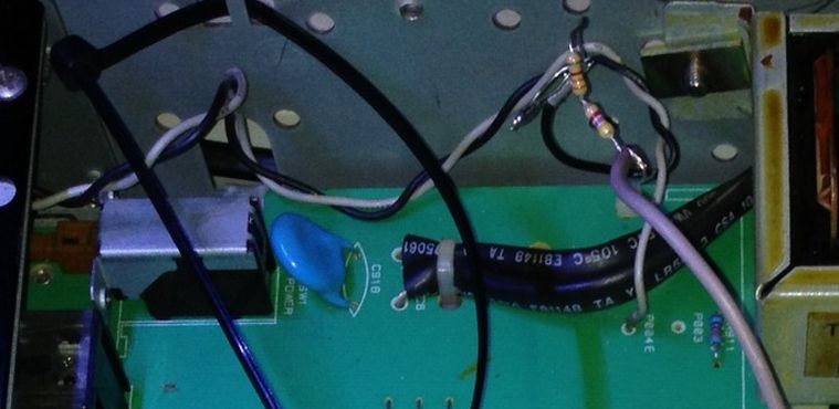

Earthing ... ground loops
1. if you put large capacitors after the regulated PSU, the regulations will not work.
2. In general use small caps of same type and value after the regulated psu, and as close to the ic/opamp as possible
3. the picture show a resistor and some wire going from the bord maybe to earth the case? ..... are you sure you don't have more loops to the case .... try cutting this ....

I went on to remove all active components, as you guys probably predicted, that doesn't do a thing.
Then I proceeded to work on the ground connection. I mutilated the PCB and separated the ground (or at least what I think it is) into 3 parts: input, output, and the rest. I then connect these grounds to my "star ground" on the new board. Although I am not able to totally separate the input ground and the rest of the ground (there are still a couple hundred thousand ohms between them), it is now very quiet!
Thanks again guys. :)
