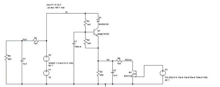

00940, agreed - a capacitance multiplier works very well. You can also put these on the output of the regulator to cleanup regulator noise, at the expense of some load current induced ripple on the output. Main point is wideband noise from the regulator is removed.
I would say that modern audio op-amp PSRR is very good. For example the LM4562 has a PSRR at 20kHz of 105db and at 200kHz 80db. On the negative rail, its 70db and 50db respectively, so not quite as good. In the big scheme of things, these are outstanding numbers.
Attached is a capacitance multiplier circuit.
