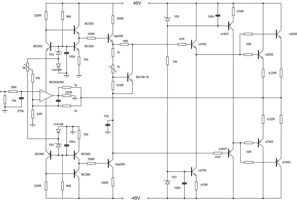

hi guys....i powered the beast up...i am using NE5534 in the input for now...
it seems to me that the sound of this amplifier is practically determined with the quality of the opamp...it is almost crucial to have a good opamp....am i right.....???

o.k. - this is the actual circuit that i am playing with...
instead of the NE5534 opamp i am using OPA627.....the power supply is +/-37Vdc ..... and i am using only one output pair of transistors for now...i will add another pair....
it is sounding quite nice.....
the question is what can be done better in this schematic....
i have few suggestions that might be done...
1. put 100nF capacitor accross c-e of BD139-16 transistor in the VAS section (or better to put 2 cap's - one accros b-e and one accros b-c)..???
2. instead of the resistor 6k8 in the input part of the amp - the one that is supplying current for the zener diode - put a ccs - would this make things a bit better....
i would like to make a better psu for the opamp using this sch...so, how can this be done that is the question...???
well....this is a brainstormer...
