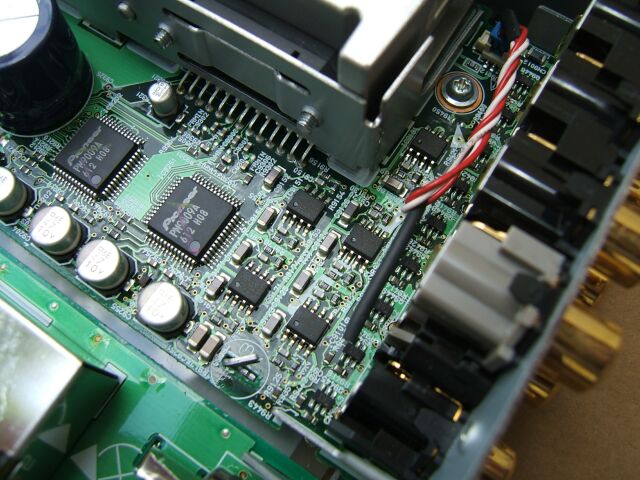

Hey guy's please shine some light on this for me. I have red somewhere that you should not swap out FET opamps with bipolar's. But I have never been able to find, or read the reasons why this is not a good practice. I have seen on other forums, where someone modded a sound card going form FET to bipolar. They said the modd has improved the sound card.

There is at least one technical reason: most bipolar opamps have orders of magnitude more input bias current than FET input opamps. Depending on the circuit details, the increased bias current can cause appreciable DC offset at the output. Again, depending on the circuit, this may or may not upset or even damage your system.
It should be clear that indiscrimiate changing of device types without having a good look to the consequences is a bit like playing Russian Roulette.

Thanks for answering guy's! I was about to swap out some opa2134ua with ad8599arz. Then I remember they were FET & Bipolar. I got some ad8066arz, I will use instead. I am trying to improve the sound of my pioneer car stereo.
