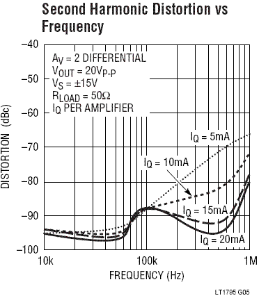

my guess is that many op amps use < 1mA output bias - open loop output Z of 50-100 Ohms is common: 1/2*(26mV/Iq) => 130 - 260 uA
opa134 claims 10 Ohm open loop output Z; => 1.3 mA, presumably output stage bias could be tested by plotting supply current vs output current
I can't see the point of "class A" biasing the input op amp in a multiloop/buffered arrangement - it only takes a uA or two to drive the output amp, surely 100:1 Iq:Iout is "class A" enough
It does seem likely that the newer dsl driver chips run the output considerably hotter - you don’t get -80 dB distortion at 1 MHz into 25 Ohms with lots of crossover distortion for your limited feedback to fix
LT1795 cfa with settable bias current:

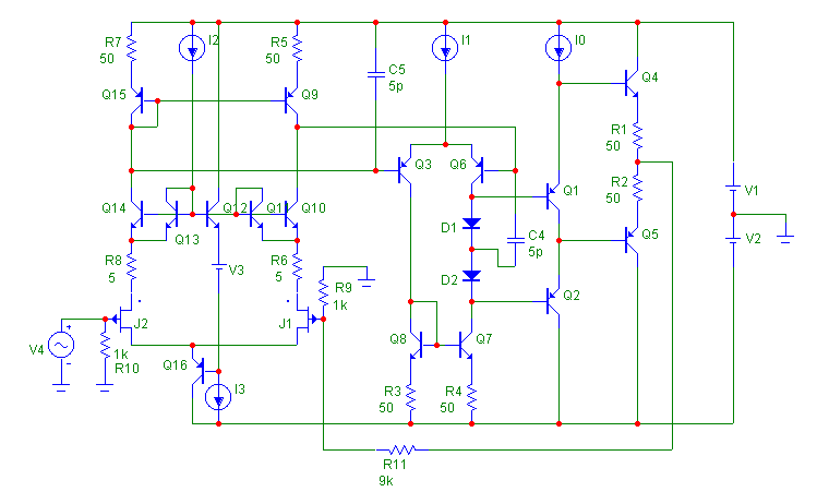

In a OP-amp driving constant current source + buffer within feedback loop arrangement
Walt Jung has made this 1mA current source optional.
( se my first post )
Why he added this option at all, I am not sure.
As told here, almost whatever OP-amp would easily drive/bias the input of a buffer, while using true class A though output transistors.
As somebody pointed out, it is only one half of the outpur stage that conducts the bias current, so we should only calculate with a single rail voltage. 10 mA bias and +/- 18 V rails, thus means we get 10 mA * 18 V = 180 mW. An 8-pin DIP has a typical Tja of 100 K/W, which means the chip temperature will raise 18 K (or 18 deg. C). Not a lot to worry about. Transistors are frequently run much hotter in discrete designs.

Interesting observations.Well, listened again last night to AD8610 (unbiased) vs OPA627 (biased into Class A, 2mA, with a JFET) and there is a difference.
The AD8610 seems to present a more open window, especially in the highs, on music, transients and realism of highs being enhanced.
I would say though that on some CD's it can come across as a bit bright. I will be bypassing using the Goudreau triplet and will post results here.
Where is to find the simplified schematic of the AD8610 and AD8620 ?
