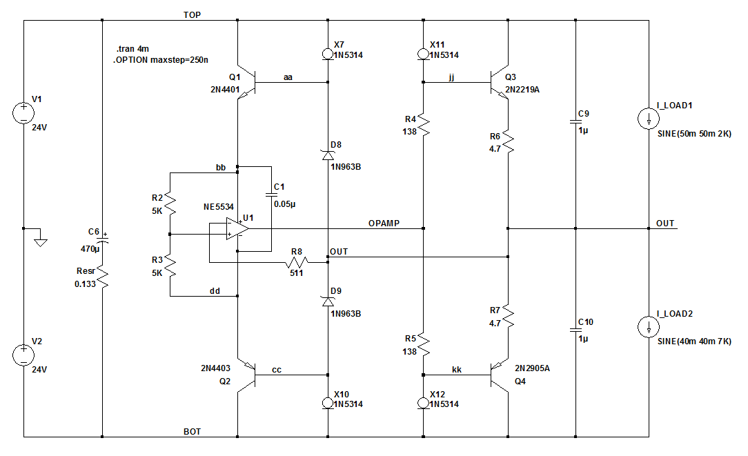

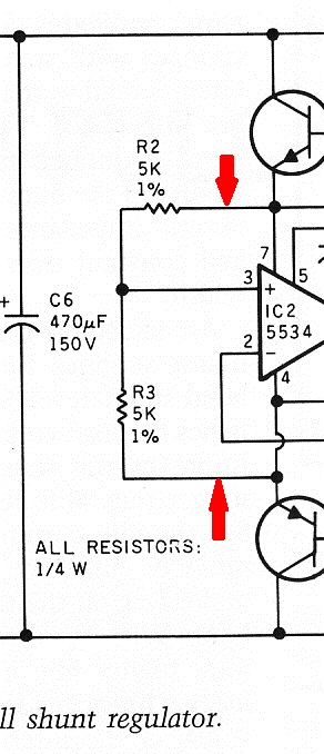

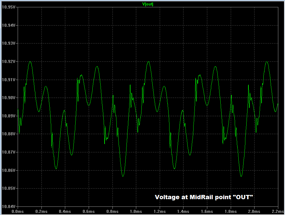

I put the "Push-Pull Shunt Regulator" (Audio Amateur, 1/88, pp. 26-29) circuit schematic into LTSPICE, and ran some simulations. To my surprise, the circuit appears not to regulate at all; output voltage was displaced from the midrail point by approximately eleven volts (!). I've studied the schematic for quite a long time, and I confess that I cannot find any trace of a negative feedback mechanism which (a) detects when the output is non-midrail, and then (b) pulls it in the other direction (towards the exact midpoint between the rails). Indeed there isn't a single node anywhere in the circuit, whose voltage is at the exact midpoint between the rails.
Maybe this is merely a drafting error; perhaps R2 and R3 were intended to connect to the upper rail and lower rail, respectively. If so then their junction would have been a midrail reference point, and the opamp's feedback loop would have stabilized the output at the midrail point. However the accompanying PCB design matches the schematic shown here, with R2 and R3 not connected to the rails. The previous design from 5 years before, shown in Figure 2 of the TAA article, did connect these resistors to the rails. Hmmm.

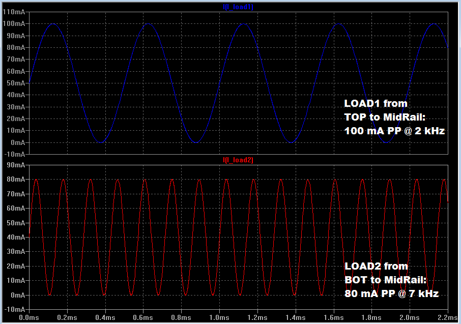

In simulation I loaded the regulator with a 0-to-100mA sinewave at 2 kHz, from Top to Midrail; and with a 0-to-80mA sinewave at 7 kHz, from Midrail to Bot. I've attached a 2-panel plot of these currents, below. The "regulated" voltage at the output is shown in a second plot. Its amplitude is ~ 60 millivolts peak to peak, implying an output impedance of about 0.6 ohms. There is also a bit of oscillatory ringing at approx 72 kHz, which dies away after two or 3 cycles. Most importantly of all, the output voltage is displaced about 10.9 volts above the midrail point.

Another point besides moving location of R's is your input is done wrong. Input must be floating -- not grounded. Like a 50v power source for +/- 24vdc output... ungrounded as explained in the article.
[Afterwards, try adding some series R or a series regulated input-floating... sim what happens.]

As shown it was a rail splitter but with the R's changed to rails it regulates as well. That didnt get shown and was an oversight in writing/editing.

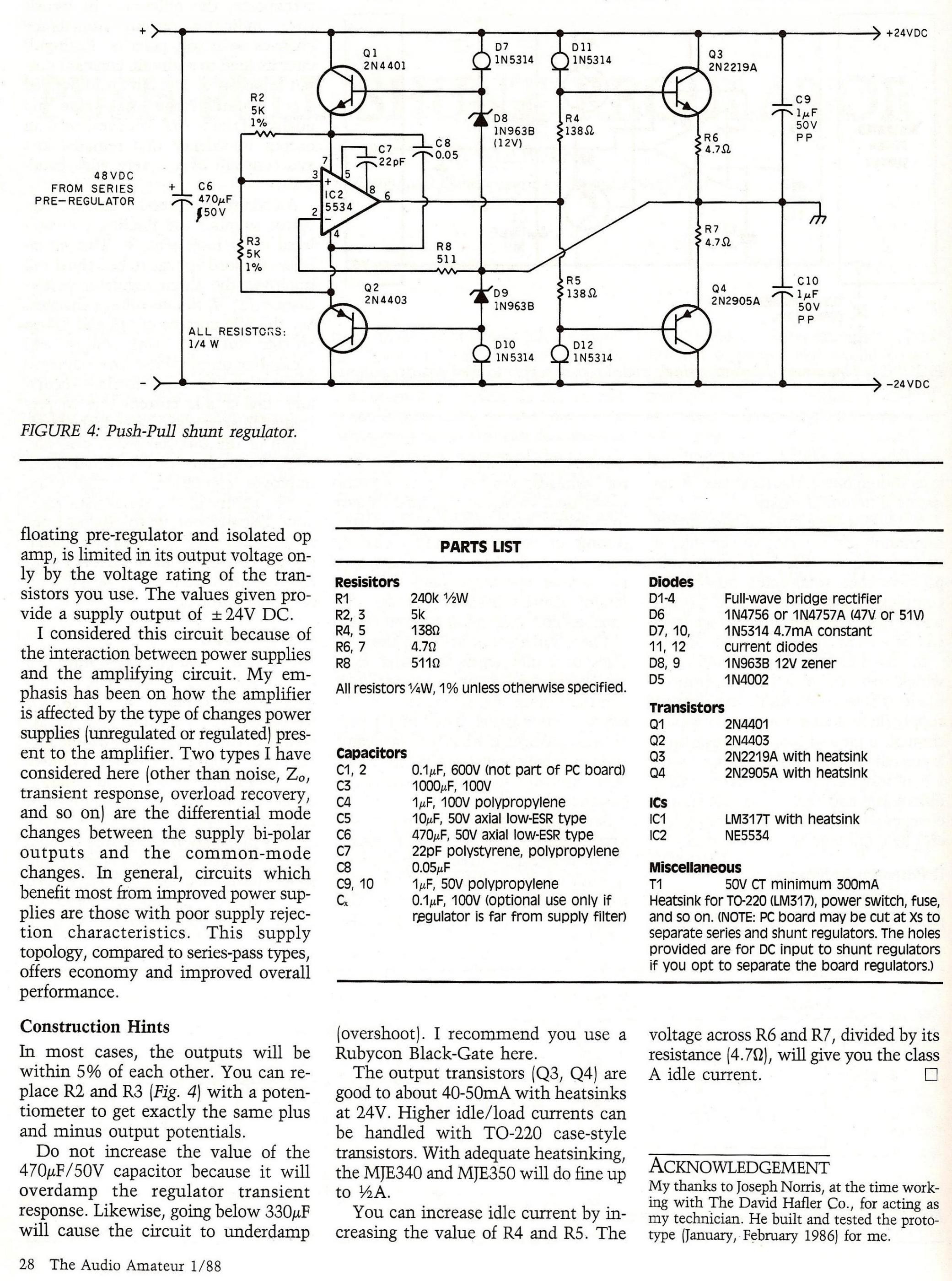

The original article had R2 and R3 incorrectly connected, in the same way I've shown; a snippet of the original schematic is below. The PCB layout faithfully duplicated the error, too.
I just found out that a guy named John Adelsbach noticed this same problem in 1988, and published a corrected circuit in TAA 4/88 (pp. 46-47). He concluded the input resistors were wrong in the original article. At the end of his article, an italicized passage appears: Mr. Marsh comments: The 5k resistors should go to rails as J. Adelsbach has indicated. ...

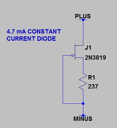

It doesn't take long to put together a simulation of the (incorrect) original rail splitter circuit, or to make modifications & test them out. Try it yourself, you'll enjoy it! The only slightly unusual element in this circuit is the 4.7 mA constant current diode 1N5314. I modeled it the easy way, using the primitive elements already present in LTSPICE: a JFET and a resistor. Voila, a 4.7 mA constant current diode with its own schematic symbol. Simulated Zout at 4.7 mA was half a megohm; plenty good enough.

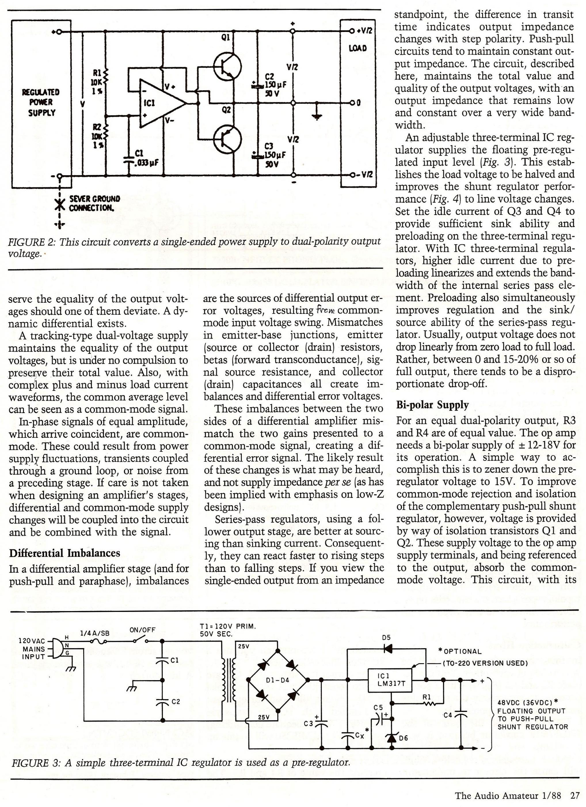

Every 25 years or so it's best to go back over the basics and sometimes the origins of what becomes mainstream.... for newbees and refreshers for the old geezers:
Note Fig2 is the correct form to use re. R1,2 for R2,3..
Enjoy!
