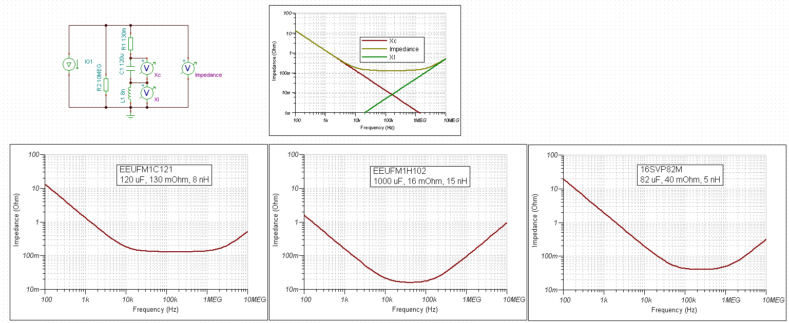

Please include ESR in your analysis! You will find that for electrolitics ESR is much higher than Xc and Xl at 'resonance' frequency. So actually they don't resonate with their self inductance at all. Not even polymer electrolyte caps. Ceramic caps do this with the inductance of the electrolyte cap.
ESR is in the order of tens milliohms normally. Completely negligible at this currents.
Current? We are talking about impedances. The value of current is irrelevant if you are talking about resonance, it is a linear network.
ESR can be low, but Xc and Xl are even lower around resonance. Lets take some good Low ESR example:
https://industrial.panasonic.com/cdbs/www-data/pdf/RDF0000/ABA0000C63.pdf
http://industrial.panasonic.com/cdbs/www-data/pdf/AAB8000/AAB8000C193.pdf
If ESR of n*10 mohm was negligible, then what do you say about Xl= n*1 mOhm?
In audio band inductance never dominates in case of local decoupling.
If it was negligible then why bother inductance? It causes even lower voltage! If voltage on ESR was negligible, then voltage on the whole part would be negligible and nothing would left for talking about.
Independently from your self-contradictional reasoning the fact is still true: ESR is much higher then Xl. You can not ignore the highest additional factor in a calculation.
Weather a voltage can be negligible or not depends on the circumstances (amplitude, waveform, frequency, amplitude of the useful signal, PSRR of OPA, performance expectations).
