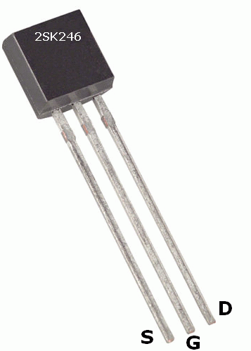

With the flat of the transistor up, I see the pins from Left to Right as S,G,D. I assume that this is drawn showing the pins, and we are looking at the transistor from the bottom, not the top. I used the classicCMP drawing.

Without the photo and schematic it's not totally clear what you really did in that "jumpered to" experiment of yours :)
To avoid possible confusion about resistor value, pinout and similar, please find attached clear pic of the 2sk246 pinout and the simplest Idss testing schematic. Just read what the mA-meter says.

Juma,
Sorry I was not clear.
The photo agrees with my interpretation of the pin out on the data sheet. In the previous test, the 10 ohm resistor was actuall 9.6, so 120 mA was obtained.
Since you were kind enough to supply a drawing, I'll explain how the tests were set up. All "jumpers" are wires with alligator clips at either end. They implement the connections in the drawing.
