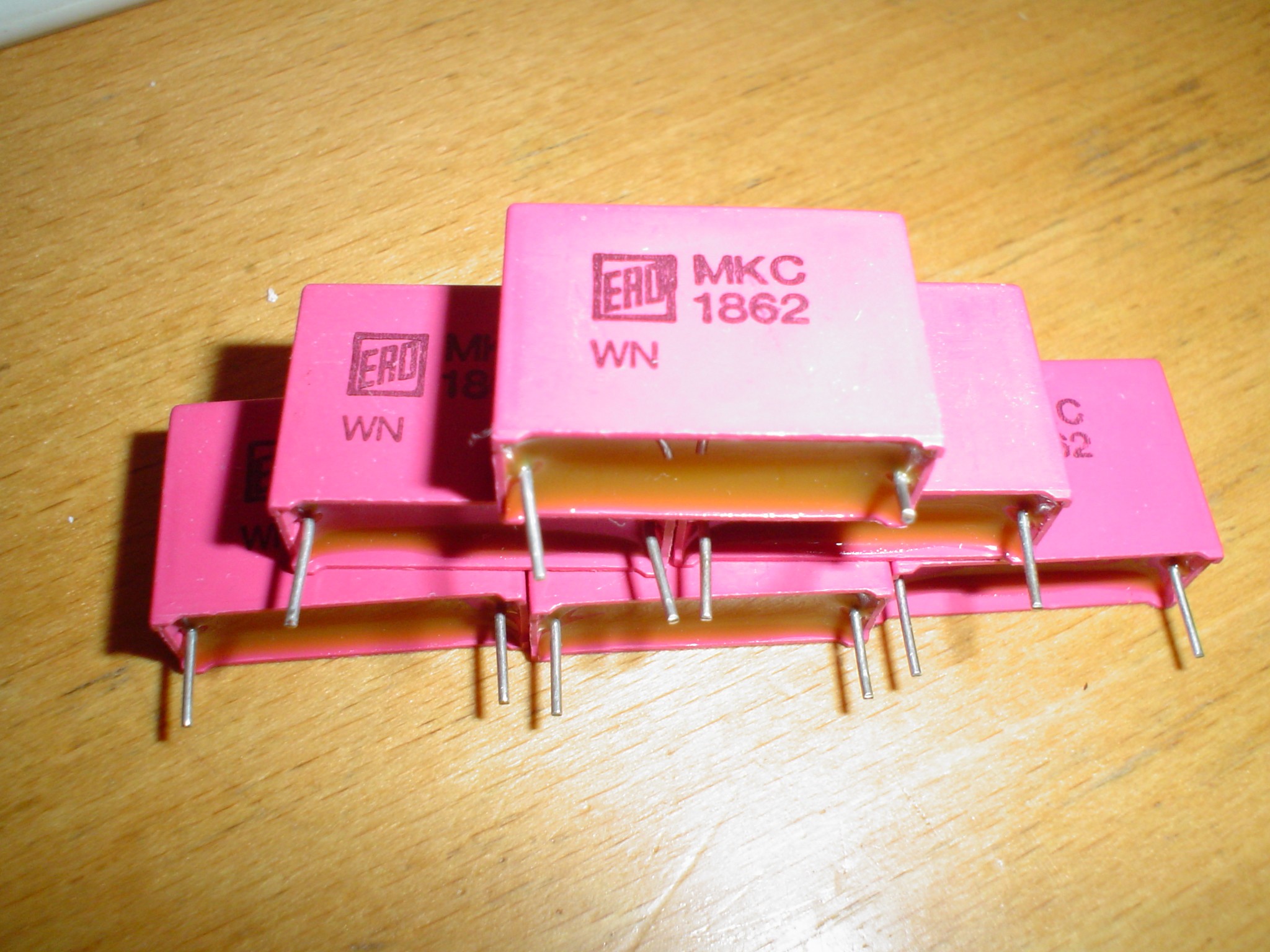

Did a search but didn't find any mkc in my parts box. I do have some wima fkp 10nf and I added those in. It's hard to detect any difference. I think it might be a little smoother, the little bit of edge is gone, but that might have gone anyway.
Certainly hasn't done harm anyway.
Fran

Drop me a PM with your particulars, and I'll send you a few MKC caps.
Magura
stash of everything
Not much glory in MKC (but i think i manage 1F easily. )

zygibajt: I will search for those caps, although I can't ever remember coming across them anywhere yet.
Try eBay they show up very often. Siemens MKV is just extremely outstanding cap as signal capacitor. Bosch MP is also extremely good although a tiny bit outperformed by Siemens. This is not only my opinion , you can google it.
You will not find anything even close to those below the level of Mudorf Silver in Oil or copper/oil jensens and the caps that would outperform Siemens and Bosch a little are V-Caps and Audio note but this cost a small fortune.
The Russians are quite fine, better than most of those audiophile crap out there below some usually very high prices. They actually showed me how huge diffrances the cap may do. But Siemens and Bosch is just another level.
If you want high quality audio without spending few hundreds bucks for a good signal caps. The only way to save the money if you have space inside component and do not mind use old used caps are the two above and maybe some others I stil haven't tested
