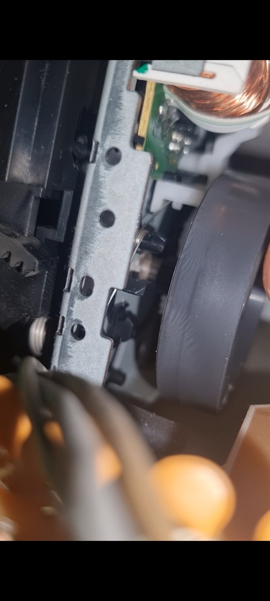

Any idea what this could be on the flywheel?
There are 3 pairs of those marks, 120° apart (the Y).
It looks like it would rub off with a finger (if I would rub for a looong time).
Flywheel is made out of plastic, can I clean it with IPA?
Currently I'm cleaning it with soapy water, but I'm getting nowhere...

A plastic flywheel is something I've never seen. Plastic coated maybe? Usually you need the weight and mass of a heavy flywheel to smooth out wow and flutter. Iso should be safe on plastic. I can't really make out the marks in the image to get a sense of what they are
Hy, I'm not liking the plastic flywheel either, maybee it's just coated, I don't know, but it feels alot lighter than the one on my old Akai.
