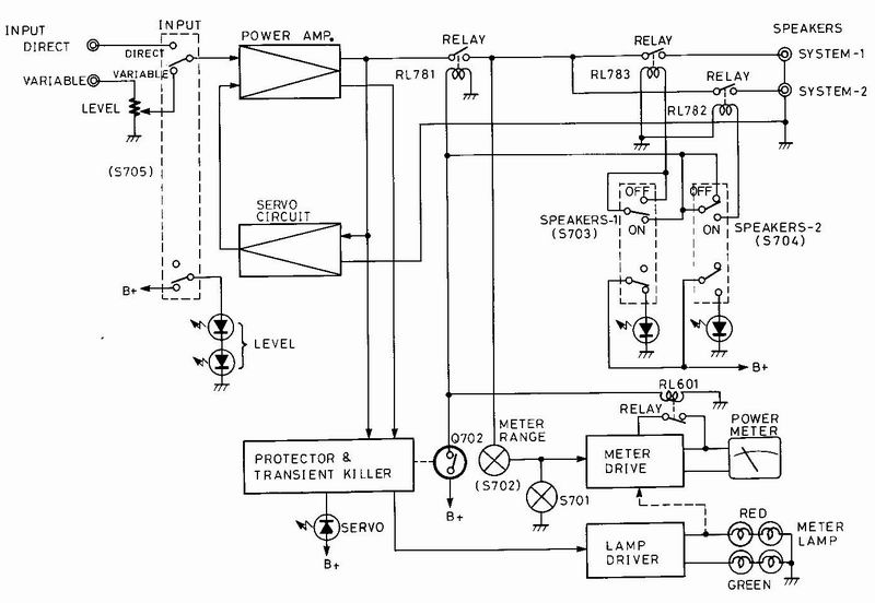

Looking at the M-508 block diagram which could be similar to the M-504:
djk is right, if the power amp is fried, RL781 should be open and the meters will peg due to a faulty protection or meter drive circuit.
I agree with others. This is not an amp to tackle without experience. Stripping it is an option but it would be a shame to dump a nice amp like that.

Well my amp has one small transformers and two larger ones (I am talking physical size). So is my idea a bad one as far as the two larger transformers "sharing" the larger one and the smaller one being bad? That is why both meters are pegging, from what I read I have a classic case of the amp going into protection as soon as I turn it on. That is why I have no relay, and no servo light. Does anyone think the transformer could be my problem? I think the power supply is fine because I looked at it closer and the meters are pegging and when I push the power button to turn the amp off they slowly go back to zero after a few seconds. Would that be the capacitors discharging?
Thanks again for all of the help
Dan

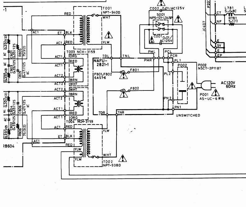

The probability of one of those common-mode chokes going open is slim-to-none.
Measure the rail voltages on the outputs to confirm.
Where the 21.5V supplies come from:

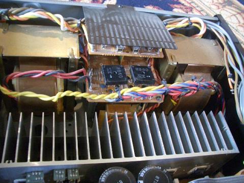

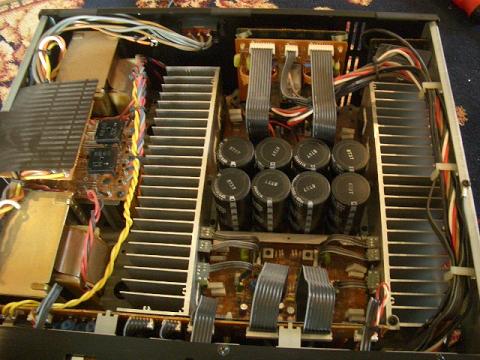

Ok this shouldn't be that hard. Can I measure the rail voltage with a common 50 dollar radio shack multimeter? Where exactly would I measure the rail voltages? I would obviously measure this with the amp on? Man I bet I sound like a rookie! I am with amps but not too much with the speaker end of things. Here are some pictures of the innards so you can get a closer look. The board is a single board but looks like it is divided down the middle and one side is mirrored of the other. One pic shows the three transformers and the small bottom one says inphase transformer. One pic shows where the wires from the transformers meet up ans distribute.
Dan
Dan

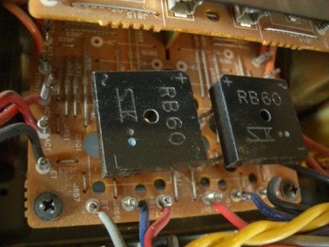

In yor pic of the RB60s you can see the wire at the bottom of the board (RED, BLUE, GREY) if you measure between the with your multimeter set to DC volts you shoild get the following voltages.
+B1 (RED) to ET (GREY) 68.1V
-B1 (BLUE) to ET (GREY) 66.7V

Ok, so yes the bottom small one is actually has a twin, it is two.
From red to grey I got 67.0V
From blue to grey I got 71.0V
I assume that there is no reason to check the other side (red, blue, black) at this point. So does it look ok? Where do I go next since both amps are being effected?

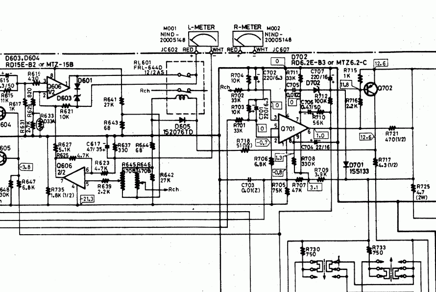

Meter problems with onkyo m504
Hey guys,
I have a similar problem, I need help with.
I bought my 504 this weekend and it worked fine - that is until I took the covers off to clean them. And I cleaned the heat sinks.
Now, the meters go negative on power up and really peg on the negative side when the speaker relay kicks in. The amp still works fine.
Any ideas? I am sure I wiggled a wire or two while cleaning, but didn't unplug anything.
Thanks,
Mark
