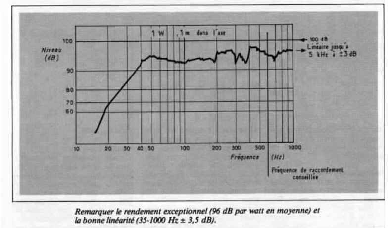

Just want to share these for those who haven't seen it yet.. A la Onken Double (515s or EXC400s) to match their radial horn HF:
http://www.artec-france.com/etudes.php?lang=en&switch=Y
Nice that they share plans for diy.. The "compact" system using 2 Supra 285's look interesting too. They were designed for SS gear they manuf, so they may need further tuning (XO, etc.) for lower powered tube electronics. In their "reference" bassbin blueprint plan shows open cavities (horn), but in their construction they have sealed it off, which may be a better match with their SS electronics.
Maybe there are already some Onken guidlines in the Melaudia forums?

Here's an A7 inspired type enclosure from the 90's. From Rintelen's website (originally published in SP):
http://rintelen.ch/pdf/DIY/blue_thunder.pdf
Please note that the bass drivers used are no longer available and that the cabinet size would have to be recalculated for use with other drivers
When I look closely at the internal pic in the .pdf article, I think he didn't seal off the 'horn chambers'. It has minimal stuffing too, only thick lining of the walls actually. He still uses 'em afaik now with supertweeters, but in a different albeit more hardcore (heavy on quality signal iron and ccs stuff) diy tube tri-amp set up + active digital xo.

The curve you showed in your post appears typical of most of these similar drivers in similar enclosures. You get fairly high sensitivity, but not much bass below 50 Hz. When I have heard these set ups they all have had the same characteristic of very limited LF extenstion, not really making it solidly to 40Hz. and having a bit too much 50-75Hz. energy in balance... I'm not saying this is bad, but for me it isn't a complete solution. When I run these drivers I also run my Quadripole subs to complete the spectrum and add in the foundation.
I remain skeptical about the reports of extension below 40Hz.
OTOH, it is one of the few ways to get articulate bass with high sensitivity... which is essential for either low power and/or matching to horns above.
