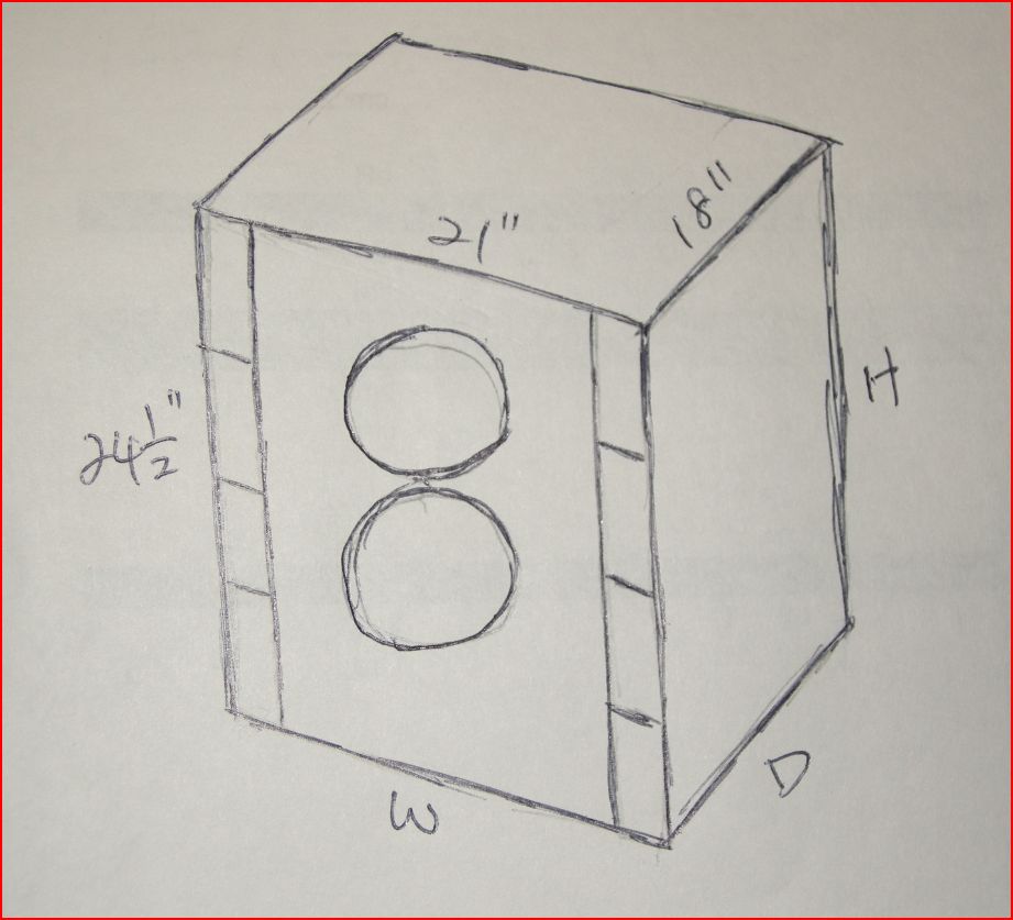

Onken bass box with 2 Eminence Deltalite ll 2510 10" bass drivers

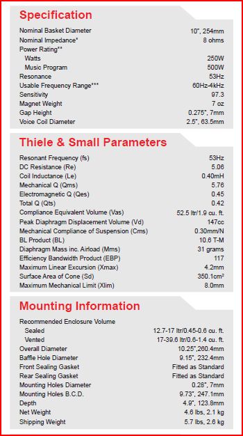

For the math challenged, he further complicated it by using scientific notation and m^2 for 'Sd' instead of the more common cm^2, which is where you messed up, so one must have a conversion chart or program such as 'Convert' to help folks like us.GM

Good to know, thanks! It doesn't seem to work quite the same for me though WRT to in. 350.1 cm^2 in m^2 converted it to milliliters, but when to was used it did the conversion correctly. For now though, I think I'll stick to using Convert.

I´ve taken the liberty to adjust the spreadsheet to take Sd in cm^2. Also removed one unnecessary decimal.
Actually the original Onken calculations from the Petite Onken article in L´Audiophile " only needs Vas, Qts and Fs or Mms, Qts, Sd and Fs. One might then add Re to make it possible to input Rg.
Maybe I should reduce the spreadsheet to make it less confusing?
http://www.revintage.se/ONKENcm3.xls

Regardless, if I wanted a fine performing cab with the Onken 'look' for dual 2510s, I'd make the vents full size and as long as required and damp the cabs to 'taste' same as a TL, though wouldn't drive them with a high output impedance since it will make the them relatively to outright huge depending on how high it is.

It is nothing special about the Onken concept expect for the n=6,34 and the ports being equal in area to Sd. About the ports it should be mentioned that I have an article from the L´Audiophile with two 515 and very small ports and L the same as the baffle thickness!
It should also be mentioned that Onken is nothing but a 4th order Butterworth bassreflex.
This one, (but not in Excel at first) that I made years ago(when the article was published) is by the book as I used the L´Audiophile(I have very issue of it) article.
http://www.revintage.se/Onken.xls
JMMLC's corrections to mine which only uses Vas, Fs, Qts and the driver's effective radius.
That is the same as mine and also by the book. See the left version in my spreadsheet.
As you see there is no provision for Rg. So CMD´s isn´t by the book but taken a step further. As I remember it there was another article just after this where the provision was added. Will check how it was done.
The 2510´s gives us a very long port which isn´t the best but it will surely work.

I think I am with revintage on this one. The crucial part seems to be the speaker in box alignment of 6.34. It may have been accidental that the vent size is so large unless he was trying, as GM suggested, to do something like the Thuras patent.
My feeling is that as long as the in box alignment is 6.34 then make the vents as large as you can whilst keeping to a reasonable length and putting the vents near the speaker, maybe each side. I think the idea of stuffing the ports slightly is probably good as well. This is just intuition - no experience to back up what ideas I've come to unlike GM and revintage.

When the two drivers share internal volume, is the measure mentioned double what each individual drivers need or is there more to the eqasiom? I use bass box pro to model, there is no multiple drivers option.
Might seem like a stupid question, but doubling a recipe often it's not just all ingredients go 1-2.
Odd. I haven't used BassBox 6 Pro in a while but previously I calculated box details for pairs of driver and as many as 16 drivers per box.
When you enter your new design the first question under the configuration tab is number of drivers query. You answer that question and work through the mechanical and electrical configurations. You enter the box parameters for a single driver as you move along and BBP will calculate the overall box values and such.
Works great! Of course you have to increase the overall box size as you work along to maintain similar responses if you are trying to have similar box tuning to a single driver.
