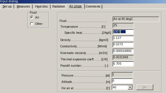

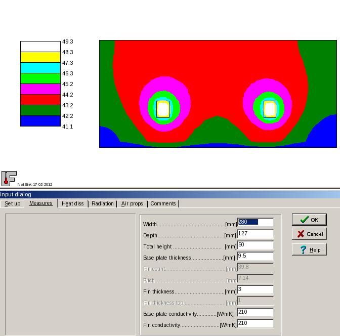

43C temperature rise for 62 Watts
The Natsink natural convection heatsink simulator estimates a 43C temperature rise for 62 Watts using the Antek/Par-Metal heatsink. Some of my input data could be incorrect, but here is what I get:

That 150W rating is for both channels, so 2 x 62W x .3C/W = 37.2C above ambient. Natsink gives about 43C above ambient. Getting pretty warm.
Thanks for running the sim! I'm on a mac so I couldn't run it. The only number that is slightly different from what you had is the total height should be 2.3" or 59mm.
That won't make a material difference, but just for accuracy sake.
Also, just wondering if the ambient air is set at 25 or 40C? It wasn't clear to me in the screen shot. That should be closer to 20C... at least in my house!
Yes, rerunning the sim with total-height 59mm didn't make a significant difference.
I set the ambient air at 25C.

43C temp rise? Brings the total to 68C, just a bit shy of 150F. That's hot. The heatsinks will feel painful within a second, but won't burn you for a few more.
That's about as hot as you want one of these to run.
In order to keep it at peak thermal efficiency you will need lots of room around the case. Also, you will need a bunch of vent holes in the chassis lid and base to keep the capacitors from cooking. No holes = easy bake oven. :(
