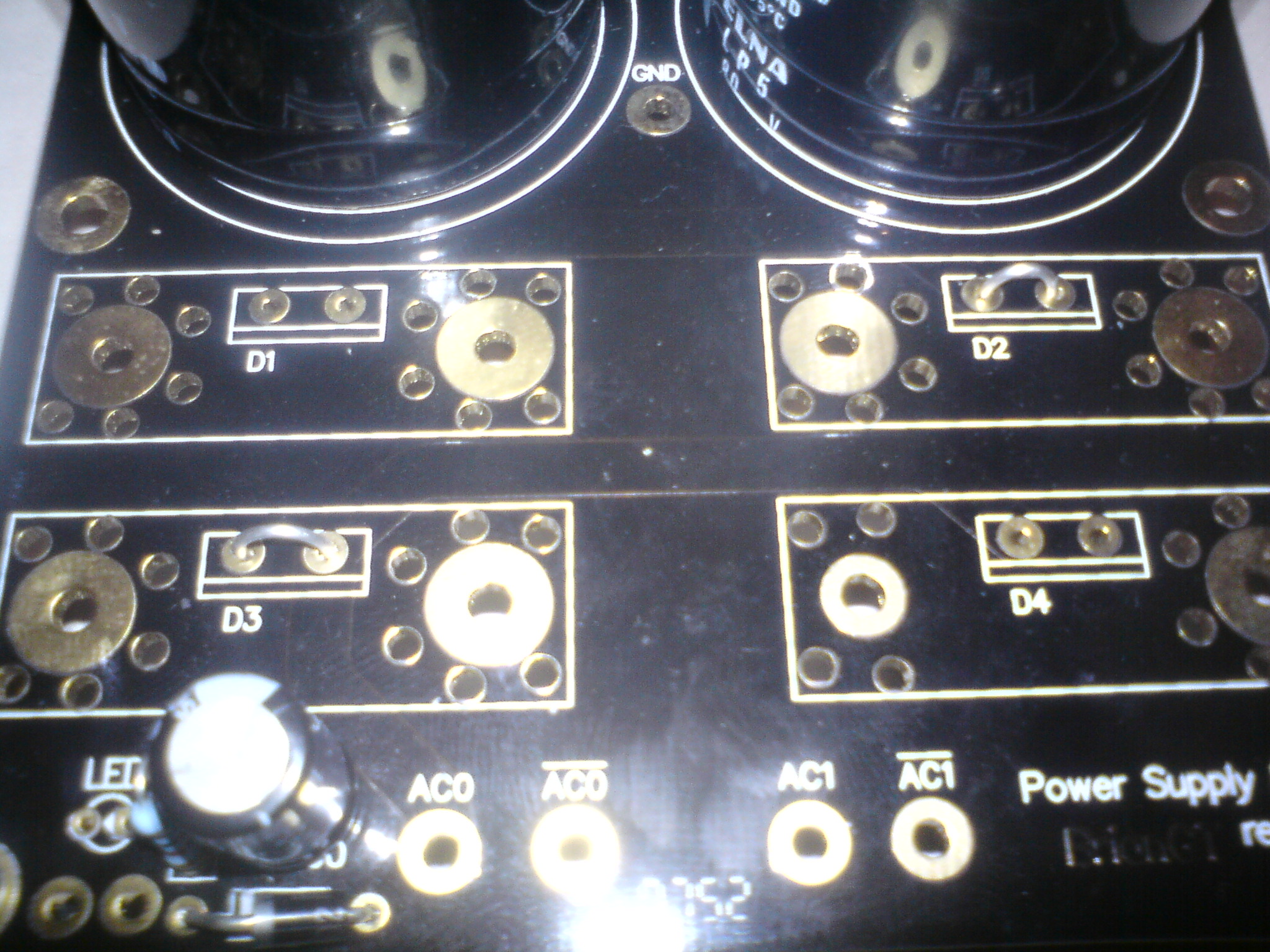

A bridge for each winding gains you a few things -
More current capability on the bridges
Distributed heat compared to a single bridge
A reduction in transformer physical hum when current draws change
Can you link to the PSU board you are using? I would like to see a closer photo of it.
Here's the link: Heavy Duty CRC Power Supply Kit for Class A Ampllifier | eBay
So I think you're saying get four rectifiers, one for each winding, and parallel the outputs to the board? That makes sense to me if I'm going to go through the trouble of doing this in the first place. Just need to make sure i wire to the board properly.
I assume I can just leave the original rectifiers... They will basically act like shorts in this case, correct?
I'll go ahead and thermal paste them anyway to see if that cools them down appreciably as well. Not optimistic though.
just pull them out. then you short the pads for 2 of the 4 rectifiers.
like this:
No, you only need 2.
Parallel 2 of your windings two times, to get the transformer connected as intended.
Now you should have (2) 18v windings of 400VA each. Put a bridge on each.
No. Remove them.
It's worth a shot, but 15A diodes will not last long in that circuit even if cooled by submersion in a mountain stream... :) :) :)
@6L6 - Ah, gotcha. That makes sense. I was confused by "a bridge for each winding."
@AudioSan - your description is much simpler!
Thanks to both for your help! Much appreciated!
