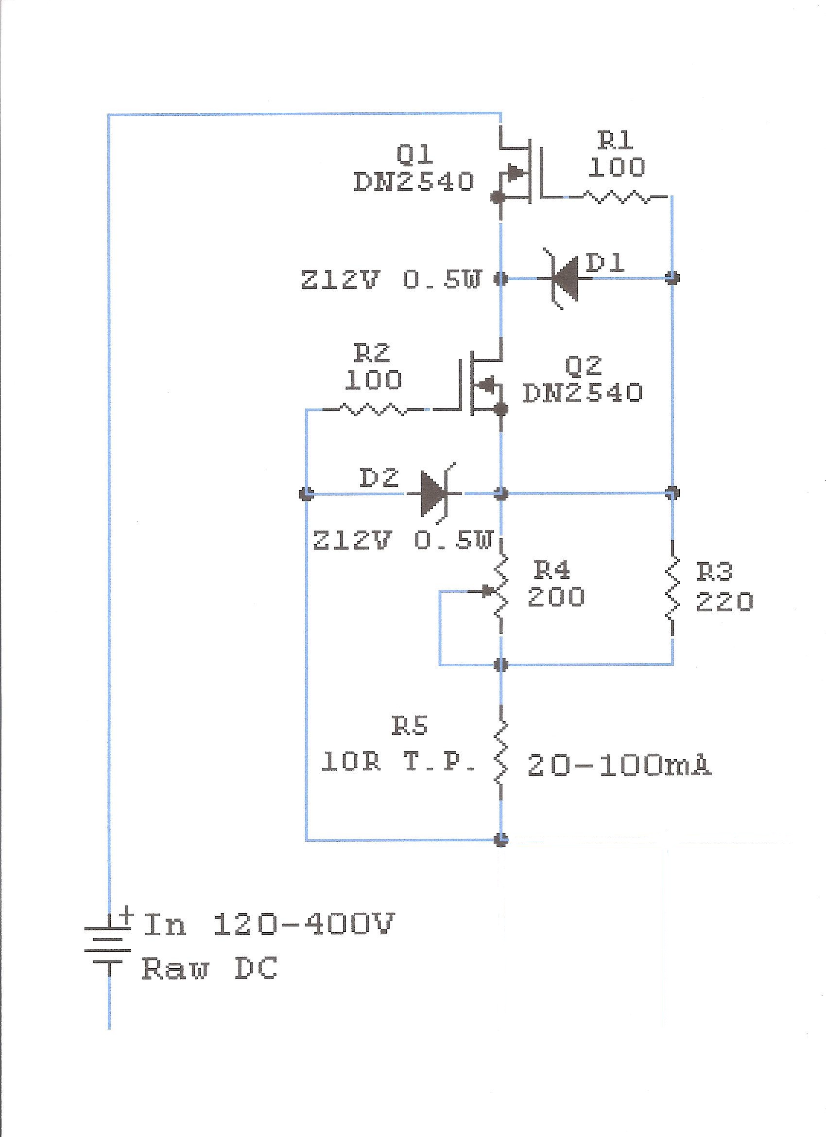

Thanks for support regal, so I have to adjust SSHV2 for 80mA (60mA for 4P1L & 20mA for the reg) for the two output tubes, for the CCS I have some DN2540 laying around so I will do the same CCS like SSHV2 but p2p, how have I to calculate the input voltage to have an output voltage of 250V or how many volts draws the CCS? I need to make two CCS: one per each tube driver, right?

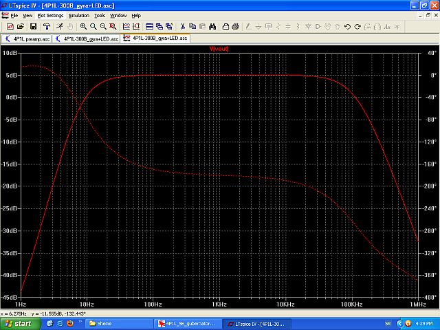

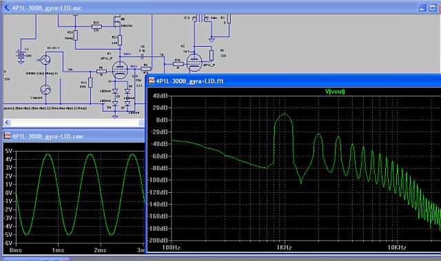

Just answer on some questions derived from pentode driver lovers.
Quick simulation says yes, 4P1L in pentode mode can drive 4P1L in triode mode. It is very easy.
Stay with CCS, reduce Rsurce value, reduce the number of red Leds in string and reduce Ug2.
4P1L in triode mode on output have Ugk around 15-16V.
We need 15Vrms (42Vpp) from driver stage. If Vin=2Vrms, total MU of driver stage must be 7,5.
If use 5K:8 OPT with about 15 henrys in primary, You can get about 1.8 Wrms output power with 2.3% THD and Fb 12Hz-84KHz @ - 3dB.
My recommendation is run away from any feedback in two stage SE amplifier. It's very bad. And of course, use well regulated PSU for Ug2 voltage.
