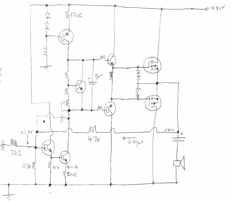

Well, it's not exactly crash hot, but with a few simple mods it could still be turned into a not too shabby performer.
This is what I would do:
1) Pull that twin triode from its current silly location, along with the bootstrapping components and replace with a 5mA BJT current source, biased with a LED or a couple of 1N4148's in series.
2) Emitter degenerate the voltage amplifier transistor Q1 with a ~200 ohm resistor. This resistor will raise the emitter of Q1 to +1V (200R*5mA), thus making the DC bias stability adequate.
3) Connect a MPSA42 or similar as an emitter follower to drive Q1. Tie its collector to the positive rail and return its emitter to ground with a 1k8 resistor for a collector current of about 1mA. This emitter follower will reduce distortion caused by feedback via Q1's cob and non-linear base current through the input resistor.
4) Add a complementary emitter follower buffer stage between the Vbe multiplier and the MOSFETS. This design only has a single stage for voltage gain, so we want to keep the collector impedance of Q1 nice and high.
5) Add zener+diode gate protection for the MOSFETs as described already.
6) Tweak R2 to appropriately set the output voltage at approximately 1/2 the supply rail.
7) Add some freaking frequency compensation around Q1 in the simple form of a miller compensation capacitor from collector to the base of the added emitter follower (junction of R1,R2 and R3).
8) Shunt the Vbe multiplier with a ~10uF electrolytic.
9) If you really want to keep the valve in circuit, configure one half of the twin triode as common cathode preamplifier, with the other half as a direct coupled cathode follower to buffer the anode load of the other half from the input resistor R1. Maybe even use the cathode follower to bootstrap the anode load of the common cathode amplifier and set the preamp gain with the same type of NFB arrangement as used for the solid state part.
I think that’s about it

Now I must be bored this evening. Here is a picky:
EDIT:
D'oh! Forgot grid stoppers for the MOSFETs!

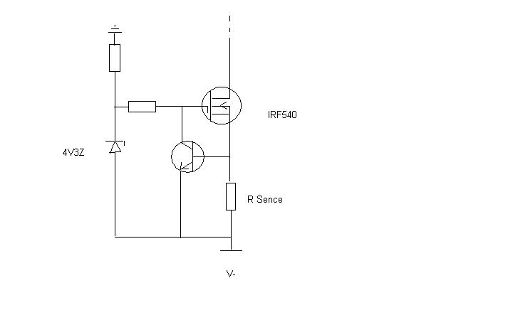

The original schematic relies on Vgs of the lower output MOSFET to set the CCS current. It is basically the voltage on the gate of this MOSFET, minus Vgs required for this CCS current, divided by the source resistor of the MOSFET. The problem here is that while the voltage on the gate can be made well defined (by a zener, diode string, etc), the Vgs of the MOSFET depends on the particular MOSFET itself - not only the particular type used, but also within the same type there can be large tolerances, especially for the same type from different manufacturers, and on the temperature of the MOSFET. Therefore, without some sort of an adjustment and thermal compensation, this CCS current is not well defined.
This is why a different type of CCS needs to be put in that position. Instead of relying on several variables, you can reduce this to only one, by constructing a CCS which tries to maintain one Vbe voltage drop of a BJT on the source resistor of the MOSFET. Then the current is only dependant on the Vbe change with temperature of the BJT, and the current through the collector of the BJT, which can be stabilized the same way as the gate voltage in the original version of the CCS was stabilised (in fact, you can use this same 'voltage reference' for the input stage differential CCS, saving a part or two).
In general, this is how you do it:
First provide a voltage reference off the V0 rail. You do this by tying a suitable zener in series with a resistor from -V to GND. The zener anode goes to -V. The zener cathode is the reference p[oint.
Next, connect a resistor much larger than the series zener resistor, from the reference point to the gate of the bottom MOSFET (N-ch). The source of this MOSFET remains connected to -V through a source resistor, as it is now.
Then, connect a NPN BJT so that it's collector goes to the MOSFET gate, it's base to the MOSFET source, and it's emitter to V-. This puts the B-E junction directly across the MOSFET source resistor.
The resistor from thereference point supplies positive gate voltage to turn on the MOSFET. However, if the voltage across the source resistor rises as a result, the BJT starts conducting and shunts the MOSFET gate voltage to V-, therefore limiting it so that the current through the source resistor creates a voltage drop equal to about 0.55-0.6V for typical small signal BJTs. In other words, it's anegative feedback based CCS.
The advantage of this CCS is that a relatively small voltage drop is needed on the source resistor, and the Vbe of the BJT changes by about 2-3mV/degC so assuming a relatively constant reference, this is the only source of CCS current change. In actuality, the BJT can be kept sufficiently away from the MOSFET to reduce temperature dependancy, but even with 50deg C difference between hot and cold, the tolerance of the CCS will be +-10%, which is far better than that of the original. With the original, the drop on the source resistor has to be quite large compared to the Vgs of the MOSFET to keep the Vgs variations small in comparison - so, a lot of voltage (and heat) is lost across the source resistor.

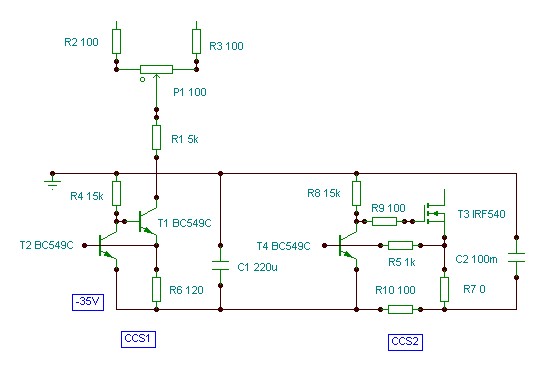

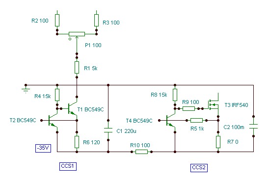

Thanks both of you.
In my mind these concepts works as a servo controlling the DC current through the transistors. The interesting question now- can this now be applied to an AC condition ? Would not the servo cancel all AC components applied to the gate of the transistor? That is- is this something to be added to the existing circuit?
Hans

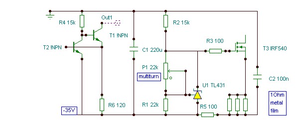

Hi Hans,
these are constant current sources, just like those in the original circuit. (D1, P3, R5, R15, Q3)
The base-emitter voltage of T2 and T4 are utilized as reference voltages instead of the zener diode.
The current of the input stage will be: 0.6V/R6=5mA, in the output stage: 0,6V/R7
Omit D1, P3, R5, R15 and break the connection towards R11.
