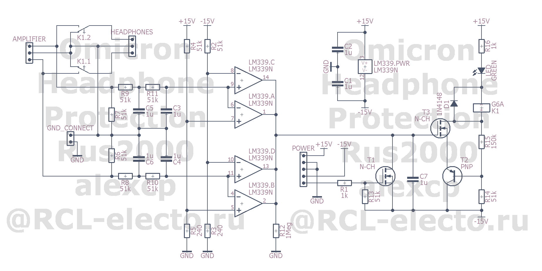

The schematic is virtually identical to the one published last year, with a couple of resistors and a ground connect jumper added:
The signal from each channel is low-pass filtered with R9 C5 R11 C3 and R8 C6 R10 C4 and fed to a window comparator. If the DC component of the input signal falls outside of the window set by R2 R3 R4 R5 (+/-80-mV with the values shown and +/-17V power supply), the comparator switches off the Schmitt trigger T2T3, which turns off the relay and disconnects the load. The protection is fast - a 1V step at the input disconnects the load in 30 milliseconds.
When DC disappears, C7 slowly charges via R12, so the relay turns on with a delay of about 1 second with the values shown. The same delay protects the load from turn-on transients.

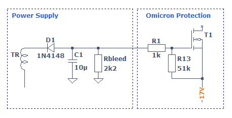

T1 optionally provides fast turn-off, in cooperation with the power supply. The gate of T1 is connected to a rectifier with a small filter capacitor along these lines (Omicron power supply includes a suitable rectifier):
Normally, the gate is at or below the negative rail (-17V) but is pulled to ground by Rbleed when AC power disappears, which discharges C7 and turnes off the relay.

what is the function
1. "GND Connect" pin? why not directly connect to ground? why there is "option"
2. R6 and R7?
3. if am using 12v coil relay can i adjust R16? or something else to be adjusted? and at what value for 12v coil relay?
thank you so much
1. The option to connect the power ground to the signal ground adds some flexibility when integrating the protection into an amplifier. Normally, there should be no connection, as the power ground should be connected to the power supply's ground, while the signal ground - to the amplifier's output ground.
2. R6 and R7 sink the comparators' input bias currents. These resistors are not required if the protection circuit is permanently connected to an amplifier's output (as in the Omicron). However, should the amplifier's output be unconnected and R6/R7 not installed, the input bias currents would slowly charge C3 C4 C5 C6, triggering protection.

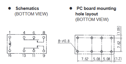

3. R16 drops the difference between the rail-to-rail power supply voltage and the relay's coil voltage rating. The value, obviously, depends on the impedance of your relay's coil.
For example, for Fujitsu RY-12W-K the coil resistance is 960 ohm, which corresponds to 12V/960ohm=12.5mA. If your rails are +/-15V, you'd need to drop (15+15)-12=18V, and R16 would be 18V/12.5mA=1.44kOhm. From the E24 list of standard values, 1.5kOhm would work well. Note that R16 would dissipate 18V×12.5mA=225mW, so you'd need at least a 0.5W resistor, and 1W would be even better. For a lower impedance coil, the current and the power dissipation would be proportionally higher, and the required resistance would be lower.
The values shown work for 18VAC secondaries. You can make it work with pretty much any voltage, provided that the gate of the MOSFET never goes above or below its source (=negative supply rail) by more than the MOSFET gate-to-source voltage rating (+/-20V typical). To achieve that, choose R1 R13 to make the MOSFET safe, then choose Rbleed so that MOSFET stays off when AC is present but opens quickly when AC disappears.Hello,
Is there any recommendation for the min/max voltage for the "TR" transformer?
