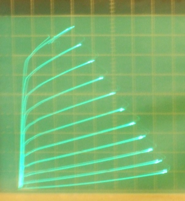

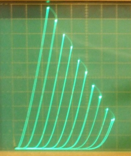

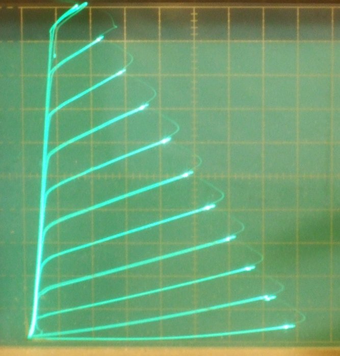

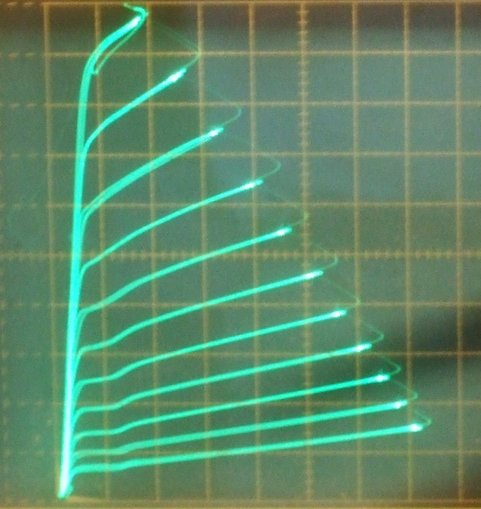

The old advice, or admonishment, to "linearize first, before applying feedback" has entered a new dimension:
1) old grid 1 drive
2) new (g2 and g1 hybrid or "Crazy drive")
No amps using it yet however. Will someday be realized.
(after doing taxes, clearing deadly trees from nearby river for kayakers, after clearing brush from some property I need to sell, to pay those taxes, after solving high blood pressure problem .....) Well, maybe next year.
"I still reckon the enhanced triode mode that Tim deP used back in the mid 90s was a form of hybrid drive."
That's just g2 drive alone. Nothing new about that. Certainly not triode like curves either.
1) g2 drive
2) Crazy drive
3) g2 connected to plate, frame grid "triode"
4) real triode, 300B
5) perfect "triode", g2 connected to plate

Crazy Drive,
I have a home custom design of Push Pull 6DQ5 sweep tubes running Crazy Drive with the resistor ratios suggested by smoking amp. This amp makes in excess of 40 watts rms and does sound very good. That said, I am not sure it sounds better than my own custom home designed and built Push Pull 6BQ5 ultra linear amp that makes 13 watts rms. My hearing suffers from high frequency loss and is not what it used to be. Still the new crazy drive amp sounds very good to me. Mickeystan :)
:up:
Are you using any local Fdbk (or global) to tame the output Z? What level of idle current was needed for the tubes to clear up crossover?
"I am not sure it sounds better than my own custom home designed and built Push Pull 6BQ5 ultra linear amp that makes 13 watts rms."
The 1st question needing to be answered yet for this scheme, is if the loss in stage gain (for local Fdbk use) using g2 drive or Crazy Drive is compensated for by the lower initial tube distortion. Crazy Drive requires less drive than g2 drive and is more linear than g2 drive, that much is clear. So the run-off is between g1 drive and Crazy Drive. I strongly suspect that higher harmonics are reduced more than the loss of stage gain using Crazy Drive, but an FFT test would really be needed to settle the issue. The reduced drive requirement of Crazy Drive versus g2 only drive is much safer for the tube also.
Of course, if one uses local Fdbk back to the driver stage grids or cathodes, then Crazy Drive almost certainly comes out ahead with some high gm driver tubes to boost the local loop gain. (12HL7 $1)
The other question needing an answer is how smooth is the zero crossover between tubes? I suspect it is similar to g1 drive, since at low signal level, g1 is mainly providing the control. Bad crossover would definitely sound bad. So Crazy Drive seems to be doing OK here with the 1st amp.
The reason it is an issue, is Crazy Drive seems to maintain a constant effective gm over almost the full current range of the tube. (great for SE use) That would lead to gm doubling in the overlap region for P-P, which would cause dist. Close investigation of the Crazy Drive plate curves however, does show that the gm eventually drops off at very low current, so a constant gm sum in a modest overlap region is looking possible.
