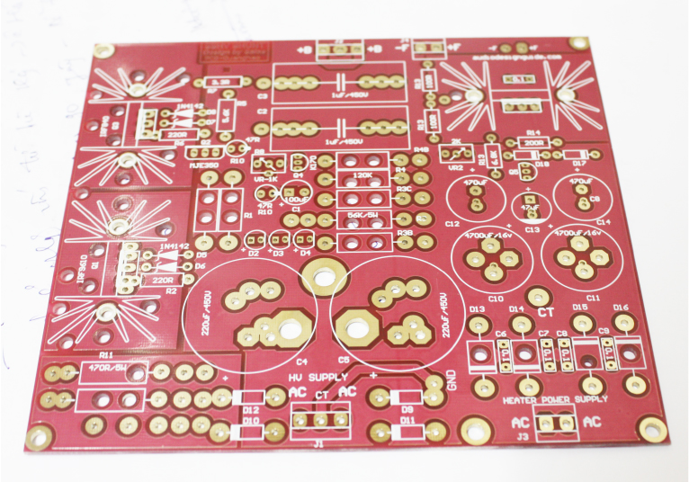

I am getting a tranformer turned for this project.
Will it be ok if i ask for
50VA
secondary 1: 230V = 100mA
secondary 2: 9V = 2.5A
like on the circuit diagram a few pages earlier in this thread? or should the ampere rating be higher?
yes, it is ok. 230 x 1.28 = 294V, +B need 200 V , I= 40ma, ok,
Second question IRF9160 , anybody have a supplier/equivalent for these ,it seems they are hard for me to find.
WAIT! I think i see now , It should be IRF9610 and NOT IRF9160
We\I need a decent parts list page with designators.
and possibly a once over to look for mistakes like this
you can use 9240 change 9160, becuase in the PCB, i put size for it

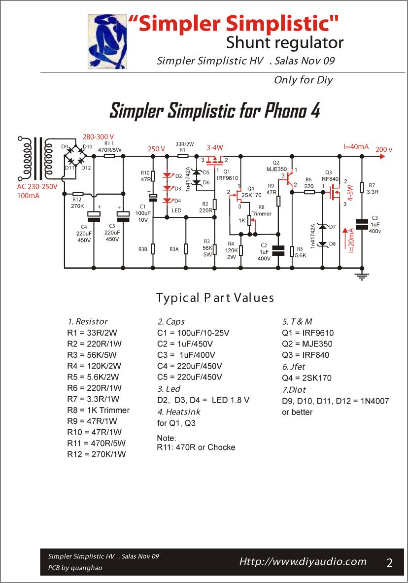

Let me rephrase:
http://www.diyaudio.com/forums/atta...r-andrea-ciuffoli-simpler-siplistic-phono.jpg
IRF9160 = WRONG!!!
IRF9610 = CORRECT!!!
IRF9160 = WRONG!!!
