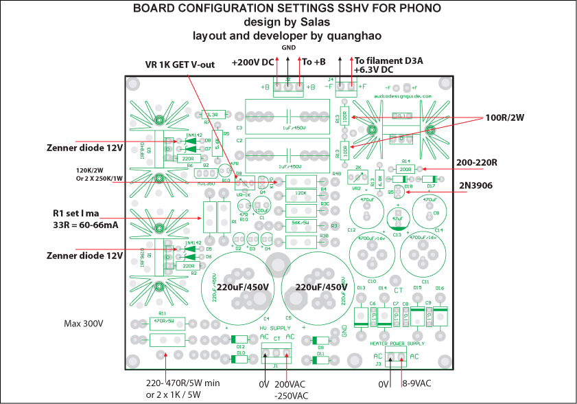

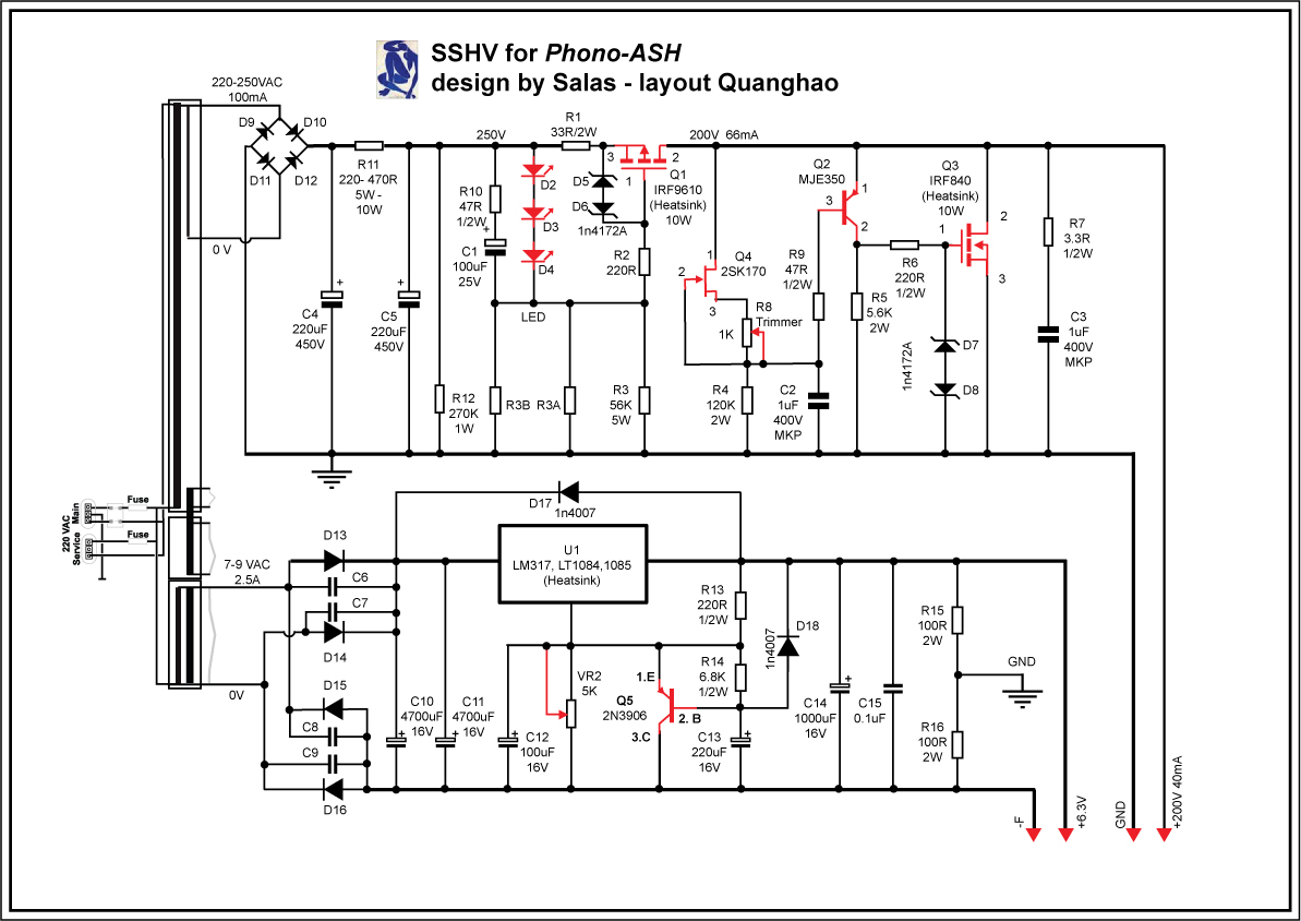

Hi all
i am currently busy ordering components. I have found these two fonfusing things on the pcb that I will post to possibly help someone else who is building this phono premamp.
on the pcb for power supply there are 3 x R13 reference designators they have values of
100R and 6.8k
if you compare the pcb to the schematic.
The 2x R13 100R on the pcb is R15 and R16 100r 2W on the schematic
R14 200R on the pcb is 220R 1/4W R13 on the schematic
ON the pcb R13 6.8K is R14 6.8k 1/2W on the schematic
In short ,the values on the pcb is correct but it does not correlate back to the powersupply schematic.
100R and 6.8k

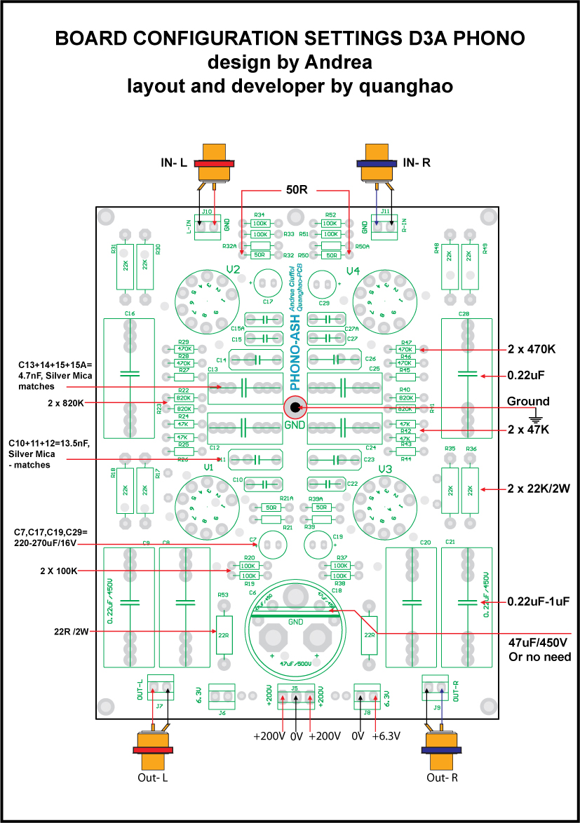

Hi!
Attention on the pcb there is a printing error:
At in - put:
Island between GND and place In.
I don´t understand were is the error?
You have picture?
Klaus
You have picture?
Klaus
Hi! you can see it!
