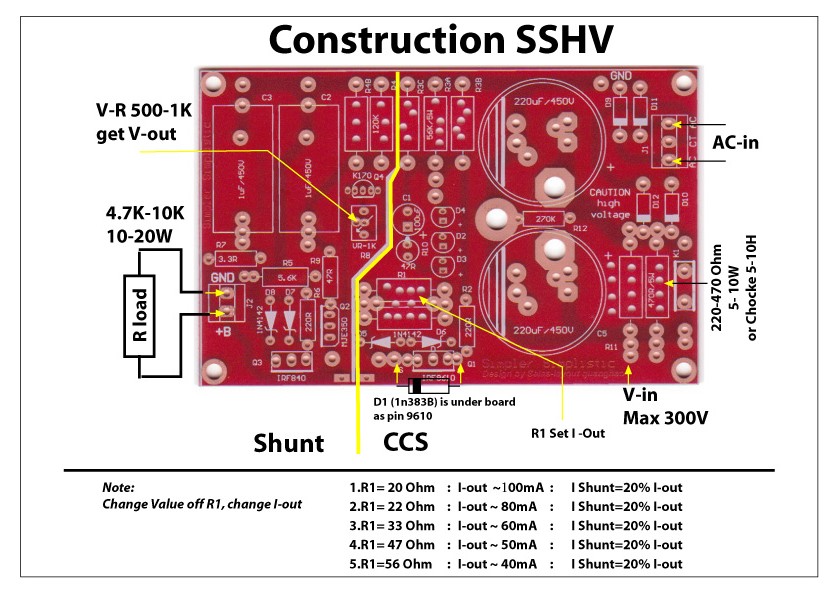

Problem with Salas HV
Using 0-250 Rcore -260V AC at input
250VDC after rectifier?
Have blown 2 9610s
THe 470 ohm resistors start smoking after 2 seconds. Obviously too much current
No obvious shorts on board.
Where do I start troubleshooting
Bob
You see this image
What about the Led??
May be Mje 350 died , so 840 get all mA

I will check the MJE 350.
The 3 LEDs light.
R1 (33 ohms) is also very hot so it draws excess current.
Oh. I don't have a 1N3838 installed. Did not see it on the BOM. Will try to find one in my parts.

Per Quanghao I will not use the diode across the 9610.
I found out that my 47 ohm resistors were 470 ohms not 47. They are marked 47. This happened to a fellow DIYer a couple of years ago. I usually check with a meter before installing but became impatient. Live and learn. I have replaced semiconductors and will see how things go later tonight.
