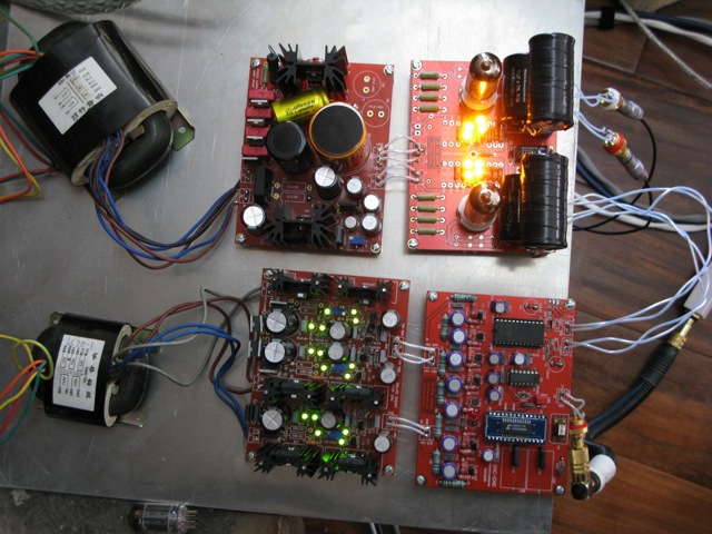

It's working !!!!!
Thanks to everyone who kept me moving forward.
Long story short. My problem was a flaky "switch" I used for in phase out of phase. Hard wired to in phase and everything came up.
Using ECC182s, Adamus LED mod, and Munford Silver/Oil with Russian Teflon bypass. 105V at the anodes.
After first couple of hours I can say the sound is very nice. Bass is tight, vry sweet voices and very good detail.

Thanks for posting your DAC photos. Looks awesome!
Thanks.
Once I have settled on final touches I will put it in a wood box with copper accents.
For those interested in the 6H6P,6H1P,6H2P I can recommend Oliver's Tube-I-zator board. I had it hooked up to the DAC End2 for a couple of hours this PM and it also has superb sonics. Tight bass, superb voices and excellent detail. Nice option if the NOS ECC182s keep going up.

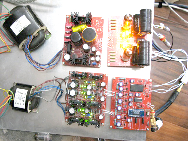

Nice build Flocchini!
Did you omit the filter completly?
Also you seem to leave out R30-R33?
Did you try the I/V without Adamus LED mod?
