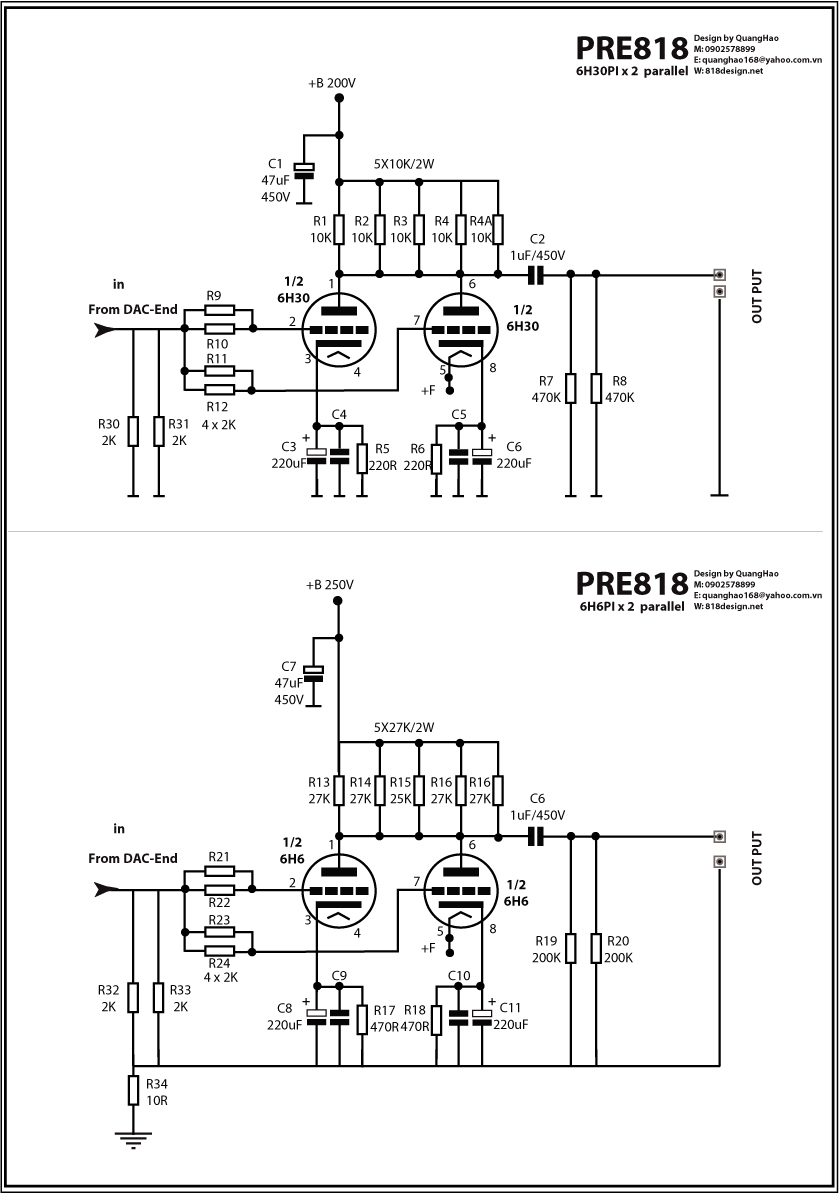

A simple mod with this could be to ditch the 47k resistors and build a simple cascode CSS with led ref (keeping the bias scheme). That would flatten the load line and probably reduce distortion a little (although its only 0.2% anyway! we arent swinging much voltage anyway, so i really am being picky i think. It would increase the gain too, which probably isnt wanted.
About the IV 5687. Andrea has mesure many the value or R Anod, so we are like 47K paralle.
About the Cascode with 2 led gree you can try to it, but i dont like the sound when use led.
you can try remove C by bass, I think you like sound .

The dacend will satisfy my tweaking needs more. I already can see the potential for a 6n6p ouput stage, gyrator or CSS loaded, led biased. i do love the 6n6p.
I love 6h6pi and 6h30pi, i have been to design cricuit of use parallel 6h6 and 6h30 few year ago. I make many PCB for my friend, they was like them.
The sound is excellent, I love them. the and new pre818 I use 2 tube 6h30 or 6h6 parallel.
In this circuit, you can try do most for IV stage if you like it.
6h30 is better than 6h6.

at some point i am going to try this, or something very similar. A more modern twist on the iv stage.
Thats a very quick sketch up so probably many errors but the basic approach should be readable.
the 6n6p has 800ma heater current so a similar load to the 5687 so the PS could remain as it is.
Rset should be for 30ma, as its a paralellel arrangement. I would try it with just one side of the triode first to be honest.
yes, it meant to say 1uf, as i said, its sketchup so many mistakes, and rather vital resistor values missing. I'll do some work on it when i get chance and perfboard it.
I have found an improvement with CSS. You do loose some of that romantic 'tube sound' as distortion drops significntly.
Yes I know it, CCS is very good with some kind of tube, but I really do not like CCS for 6h6 and 6h30 at anod.
The sound of it is skewed, not natural.
I agree with you about using LED instead of the resistance
