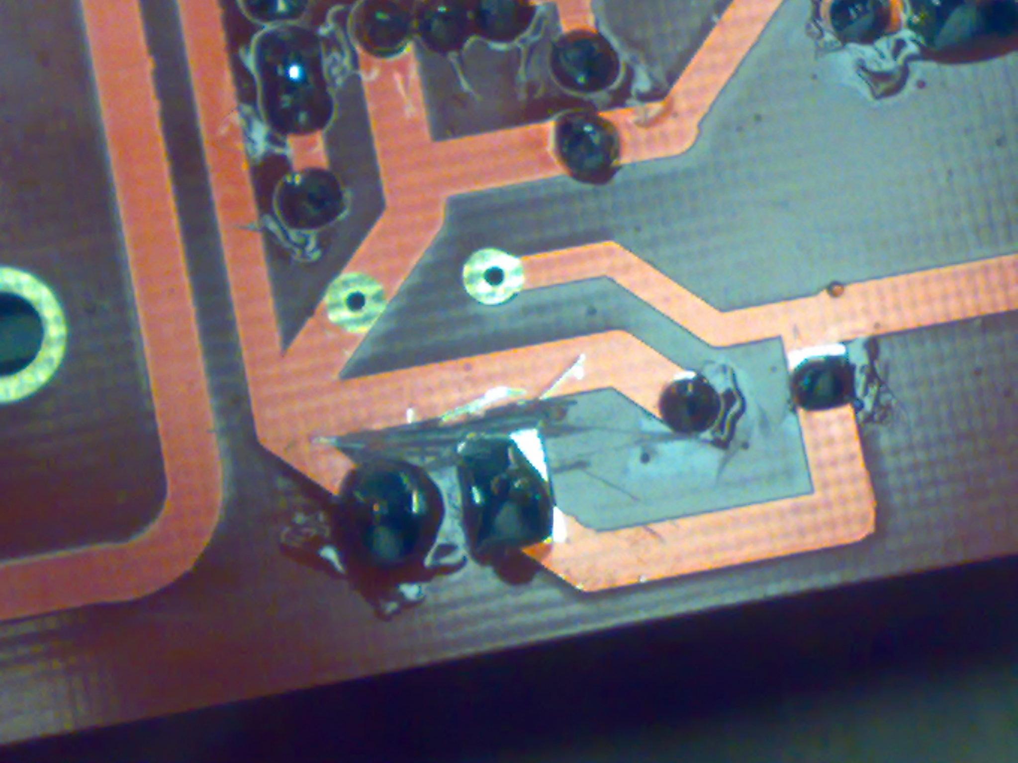

* In my pcb of the Salas board there was a little problem.
* The output of single +5v was in short circuit.
* To resolve it is necessary make a little cut of the wires, see photo.
* In my case this problem has not destroyed the components but
* please check before switch on.

checked my board, no short so must be a slight fab issue.

-- a t t e n t i o n ---x short
possible short circuit on Salas board
check twice for the short
under screw terminal +5 Digital output
Thanks Audiodesign!
Thanks Audiodesign!
