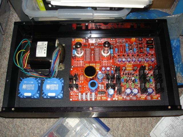

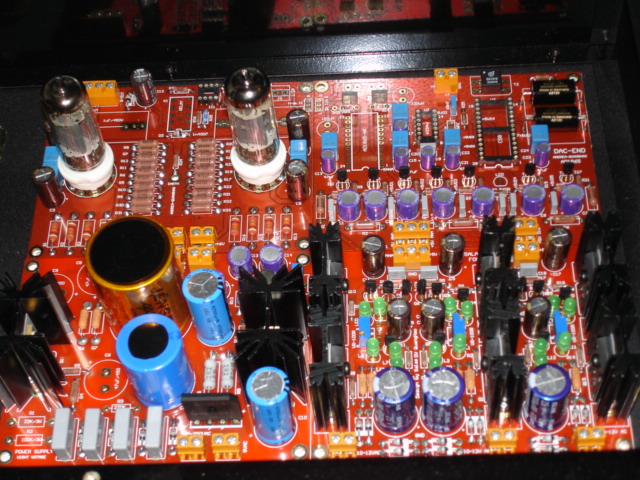

Almost ready. Only a few parts to go.

It is very nice!
but the tranformer near The Iv stage.
you can rotate 90 degrees transformers, power transformers and barriers between the motherboard and features a shield!
And you do not use L1, L2 so you do not use R30, R31, R32 , R34 .
R8, R9 (2.2 Ohm) in the HV supply is very hot, you can change by R 1 Ohm parallel
The Cap in put is good, i like it!
