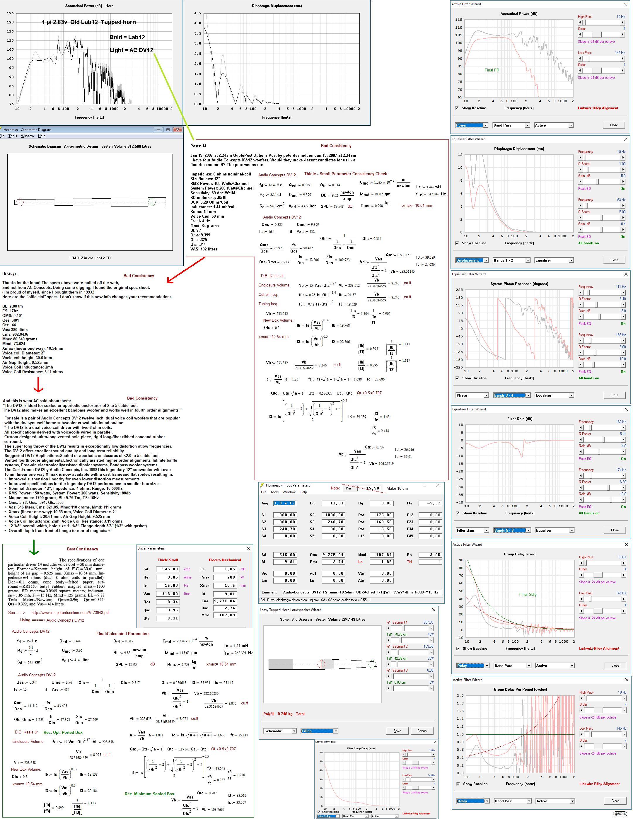

that Sd figure must be a typo - maybe that's the only thing off in those specs (?) - - here's one spec I found for a DV12 compared to Lab12 in a tapped horn designed for the Lab12 - the real spec might do better than this sim
Lab12 - Tapped Horn -

In the attachment, I see the hornresp horn, segment 1 is 175 litres, parallel walls, then in segment 2 the horn narrows. Can you explain how to get the fold, so the speaker placement lines up for the tapp by the mouth? If I fold both halves in half, it works as in they overlay, but it makes an odd sort of large rear chamber. is this what this is looking for? the driver is mounted facing out at the mouth. If a box has a path with 1 180 degree turn, the outside shape is odd, while the speaker mount and tapp do not overlay? Can you describe a general shape or path for the horn?
Sorry If I seem dumb, but this is new, but once I get my head around it, I should be able to make a box. thanks again for any help getting me going here. I was able to create the same model, just have to now convert that to a box.

OK a few questions to help here?
If S1 and S2 are equal then the baffle is parallel with the wall? and if L12 is 175, the driver is way up by the fold? then L34 is way less than L12 this makes the mouth up close to the woof/ finally S4 is at 177 so there must be more box past the mouth? does one close the mouth at the bottom and have an empty void in the lower bit. Its like of the 350 ish cm horn, 250 is on on side, while maybe 100 cm are on the other side? Very odd shape happening here. Am I way off in the way I am reading this? I suppose an access panel can be placed in front of the driver for access, and an empty void can be left past the mouth to make the box squareish? Or can one fold the L12 in half?
