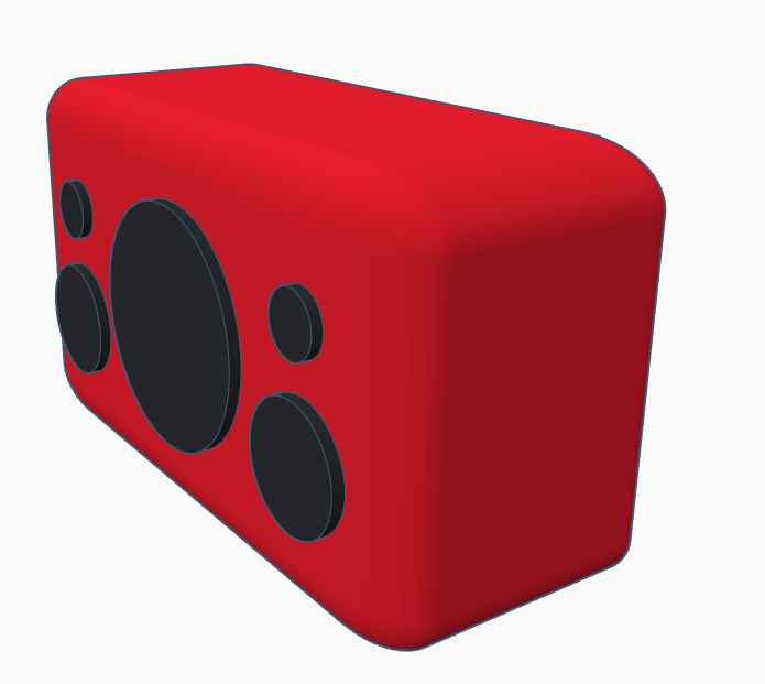

I have tried to make a quick 3d model of what i think the speaker will look like

You are right about that, plus i think it will be hard to fit two 8 inch passive radiators in the box, so a port seems like the easiest and cheapest option. Should it be front firing or back firing? As its most likely going to stand up a wall, ill assume a front firing one may be the best choice?I don't have direct experience with that one, but it looks capable.

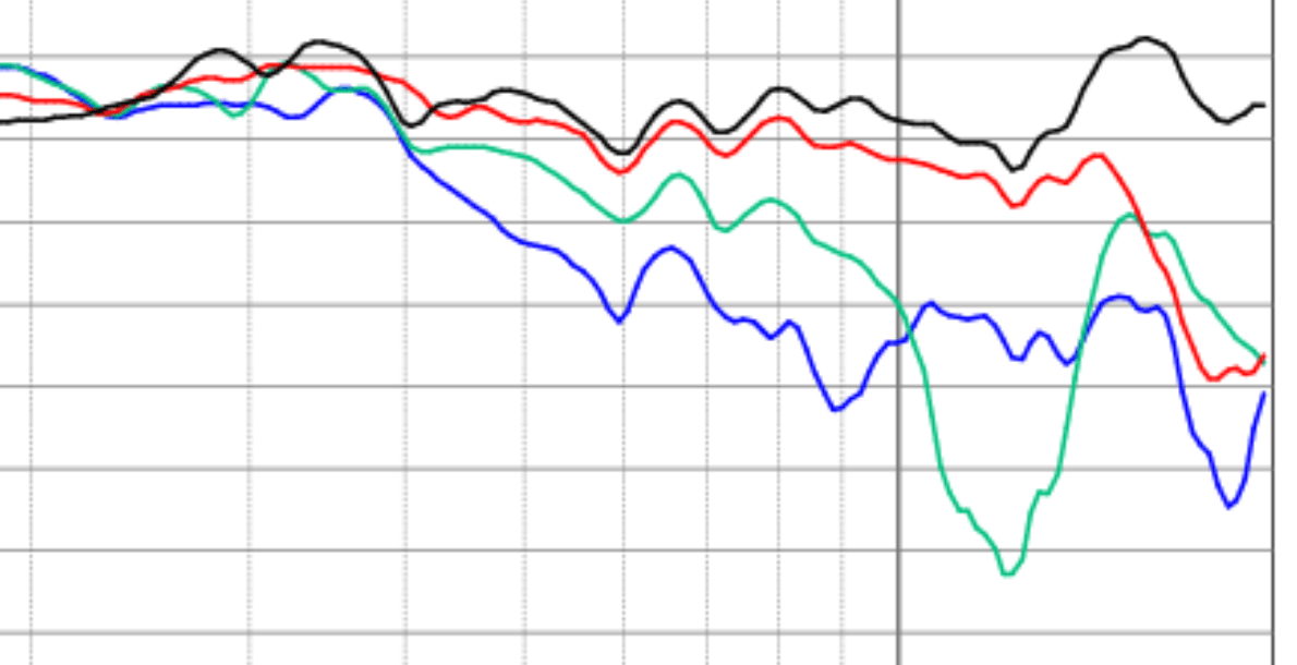

Oh, i didn't even think about that. So the full-range will produce from 500-20k Hz. I am slightly concerned about the higher frequencies though.Another thing you haven't mentioned is the potential to just use full-range drivers for the midbass-tweeter range. That could eliminate passive crossovers entirely if you choose the right amp. The simplicity there might appeal to you.
This is on the Dayton Audio RS100-4 4" Full-range. But from what i could find, basically all full range woofers have this drop. So if you listen to it from straight ahead, it shouldn't be a problem, but as soon as there is a slight angle, the sound starts distorting. But if this doesn't have the biggest effect on listening quality, i would prefer the simplicity (both looks and build process) of just the full-range drivers and sub.
If you want to be able to push the speaker all the way against the wall, then putting the port on another face is better. If you can leave a couple inches or so of clearance, a rear port would still be OK.Should it be front firing or back firing? As its most likely going to stand up a wall
True, most full-range drivers will have a more pronounced fall-off in response when listening off axis when compared to 2-way with a dome tweeter. This is just a directivity issue mostly related to their size, but cone shape and how it decouples at higher frequencies can make some drivers produce a more consistent radiation pattern. The Markaudio model you mentioned earlier demonstrates that:I am slightly concerned about the higher frequencies though.

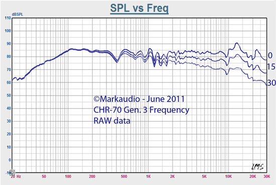

https://www.madisoundspeakerstore.c...arkaudio-chr-70-champaigne-cone-4-full-range/
The scale is different between the two plots, so keep that in mind, but overall the response is better behaved off-axis. Some EQ or tone control adjustment may be enough to make it acceptable across the typical listening window. On-axis may not be the primary listening location in an application like this.
If you build it with just the full-range drivers initially, it may be relatively easy to add tweeters if you feel the need later.
