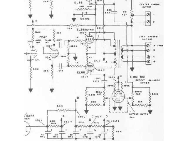

Dave, that was a great idea - bypassing the preamp and checking the sound of the amp only. I built a cheapie passive, the HH passive w/ RS parts and hooked it up to the amp. Bingo! Sweet sound and very detailed . So my next project is to rewire/replace parts. One question though. This amp uses balancing pots and meter(tube) and a center channel connect. I assume removing the center isnt a problem but if I pull out the meter and the two 500k pots, will this effect anything? Do the pots act as trim pots and need to be replaced or can I scrap the whole circuit. Below is one channel and the center and balancing circuit.

Looks like it is part of the biasing (not all the schema is there). I'd make sure you understand what it is doing before you muck too much.

taylor said:One question though. This amp uses balancing pots and meter(tube) and a center channel connect. I assume removing the center isnt a problem but if I pull out the meter and the two 500k pots, will this effect anything?

Bernhard, thanks for the offer but for I currently have 2 sets of telefunkens for it (hopefully that will be enough for awhile) Once I get the rewiring done and check/listen seriously to the unit, I may want somemore though. Ive decided to leave the "stereo balance" circuit in since Im not positive what removing it will do. When adjusting it while operating (500k pots) there is very little change it the sound. Besides, my buddies think the "blue eye" tube looks cool.
