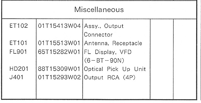

I Am An Idiot said:I would bet my last dollar that you have a defective laser. According to pacparts, both the pickup and the entire cd mechanism have been discontinued.
Try it upside down, depending on how bad the pickup is, it may play like that.
It can be replaced, providing you can find one. Did you try it upside down? I was serious about that.
Hi weesatron,
The laser head assembly must be replaced as a unit. Give the CDM a good clean while you are at it, especially the feed rollers.
-Chris
No.Also checked the switches with multimeter and there fine so I'm guising its the laser assembly is it possible to replace the laser diode?
-Chris
Sounds like the molex plug has been cut off.
Pink/white is mute, and was provided for integration with in-car cell phones. I never used it, but am pretty sure it required +V to mute. I can look it up in the old Product Guide if you're interested.
Light blue/white i believe is remote out, darker blue on the other side of the molex.
2 brown/white wires were actually connected together at the molex. Apply +12V here to pause the unit. Usually, +5V was enough for these switching fuctions in the old Alpines.
Does this unit have a DIN connector for a changer?
Yep, apply +12V on pink/white to engage the mute function.
No din plug for stacker i don't have a plug on the harness so it must of been cut. I don't think the light blue/white is for remote because it has a darker one too. Also is see that i can get a replacement laser assembly for the7909 I've seen pictures of the CDM form the the 7909 and they look identical. Dose anyone know if they are the same
Alpine provided two remote outputs- a solid blue, and a blue with white stripe.
One output is for power antenna (solid blue, IIRC) and the other is for amplifier turn-on. Both function the same, the antenna lead may have a lower current limit.
AFAIK, the 7903/04/09 used the same laser.
The Alpine part# for the 7903/4 optical pickup is 88T15309W01
Is the price reasonable?
