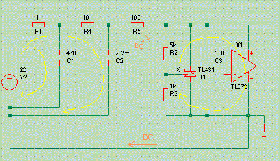

Hi Thorsten
Thanks again for taking the time to explain all of this in such detail. It's getting to the point where I'm starting to trust "my" interpretation of what the software is showing.
It does - and it's so obvious now! Why didn't I think of that?
Thought it would be much more complex.
So this is why some people use chokes.
OK - but I will still play it safe. If I see anything above 30V - I will use 50V components instead od 35V components.
Yes - I can see this effect.

If you increase the first resistor to 50R, this increases the conduction time to almost 5ms and the output voltage is still 24.9V after 7 seconds. Is this a reasonable thing to do or am I going overboard?
The 6db rule:- Trying to achieve a -6db roll-off at a particular frequency - using sucessive filters?? I did say earlier that I would probably have more questions about this.

Look at the current through the transformer, zoom in if neccesary, that should make it clear....
Originally posted by Kuei Yang Wang
Choke input and purely resistive load manage close to 180degrees/10mS condcution time (50Hz mains).
Maybe, you can do a worst case simulation with PSUD and establish the actual values for LIMIT and also look at the operational behaviour.
Usually. If you slit the R and C you get more ripple rejection.
Eg. if instead of 10R/4700uF on our earlier example you use 3R3/2,200uF/3R3/2,200uF/3R3/2200uF after 3R3/470uF on the input you get 20.45V instead of 20.5V, but with only 3.4mV Peak-Peak ripple instead of 22mV....
Even if you change the input RC to 3R3/100uF you still have only 5.2mV Peak-Peak ripple with 20.2V and the conduction angle widens a little more.
If we "design in" your 22V/0.5A Transformer and use 22R/100u/10R/2,200uF/10R/2,200uF/10R/2200uF we get 26V DC with 0.5mV peak-peak ripple. Peak currents (for 50mA DC out) are below 0.2A and the current draw is very "rounded", almost a nice sinewave. nearly 4mS conduction time equal 72degrees conduction angle.
Comparing this (for fun) with a single 4,700uF Capacitor has a conduction angle of 27 Degrees and nearly 0.5A peaks with 32V DC overlaid with 90mV Peak-Peak ripple.
I think this illustrates well the differences.
It sure does!
You can increase the timeconstant if you like. There are no hard and fast rules, except perhaps the 6db rule. PSUD allows you to try a lot of arrangements, work out two you think most likely build both and listen.... ;-)
Depends how far you want to go. Adding a TL/LM431 Shunt after the LM1085/317 series regulator is naturally a good thing, as is adding several RC filter circuits. The less noise the better. Where do you want to draw the line? You can go so far that even with AC powered gear there is no observable ground leakage and PSU noise is down to and limited purely by the active regulation device feeding the signal circuit. It does take a lot of effort to get this far and may not give better sound anyway...
Well - I was thinkig about the parts and components that I already have. The 22V 25VA transformer provides higher voltage and more current than needed. I've already got some LM317/337, LM1085 and LM431. To go a bit further than RCRC-Reg and use RCRCRC-LM317/337-LM431, will only require two additional 2,200uF/50V caps (one for +15V and one for -15V). Might be worth it?

Re: Supply for the servos.
Konnichiwa,
How do you arrive at +/-12V/1A? Have you checked the Motor Driver IC's used? What do they have as current limits (most are short circuit proof)?
Yup. However in most cases high current demands from the drive will be transient in nature, so the lower voltage, higher current transformer with large value reservoir capacitors may still be the better choice.... ;-) Try calculating realistically the regulation of the transformer and make sure you use Schottky Diode (models for simulation).

Always is.
First order approximations are fine for feasibility studies, for DESIGN you need real numbers.
You mean this paragraph?
I agree with it, except stick to LM317 Regs, as you need to / should keep the rails seperate untill you get to the common kelvin return (often inaccuratly called Star Ground) it matters nor what "sex" your regulator is. Usually the N-Channel/NPN types are better!
So go for RC\RC\RC\LM317\LM334(CCS)\LM/TL431 by all means. It pretty much matches "what I would do", if space, complexity and cost are not much of an issue.
Place the TL431 local next to the supplied pins and the CCS (LM334 for up to 10mA, otherwise FET's, IXYS adjustable Current Regs etc...) per 431 on the main add in supply board. Add some ferrite beads and RF chokes to the CCS and if possible cascode the CCS. Another RC circuit prior to the CCS may also be beneficial. Also, make sure to split each and every filter resistor into 2pcs, one in the positive line and one in the negative line.
As you can see the amount of effort and complexity in PSU's is nearly unlimited. If you go RC\RC\RC\REG\RC\CCS\SHUNT you can be pretty certain that your PSU noise and impedance is limited by the shunt only, all other noise should be minimal. Adding a further transistor to the shunt (high speed PNP type - see TI datasheet fig 21) can increase loop gain and drop the output impedance.
Also make sure to bypass the Adj/Cathode Resistor with a suitable Capacitor (single Os-Con is fine as this remains capacitive beyond the bandwidth of the TL431) to keep the shunt impedance low. Of course you might use a shunt regulator with a Op-Amp and suitable shunt transistor and so on....

Hi Thorsten
Finally figured out that the last two diodes in the dropdown list in PSUD are Schottky types. Using these in the simulation makes quite a significant and clearly visible difference to the shape of the waveform and the peak current values - thanks.
Working on it now. This has turned out to be a bit more than just copying someone else's handywork, but it is also a great learning exercise.
While we are still on the supplies for the servo's, and if any one is looking for the larger value capacitors, I noticed that Percyaudio.com has Nichicon KG Gold Tune in 10,000uF/35V snap in type for US$4.95. I hope these are suitable as the price is acceptable (for me anyway). Nichicon KG
Understood - I think! This means they will both be 15V supplies until they connect to the "ground" on the main PCB - where one supply will be connected in reverse?
Space:- Should be OK, especially if I can place a small board with the regulators directly above the circuit to be supplied.
Complexity:- Still figuring that out. Fortunately, the "horrible" DAC, with it's six supply pins, is very close to the edge of the PCB. There is an easy point where one supply can be connected which could feed all six 5V pins. Alternatively, each pin could be given its own regulator, connected to the supply side of the resistor feeding each pin. This would obviously be more complex - but I suppose it could be possible with a small board positioned directly above the DAC.
Is it worthwhile giving each pin its own 431?
If so, should the local decoulping stay in place?
Cost:- Might have solved this one. The main problem here is the cost (and availability) of quality capacitors. However, I just discovered Handmade Electronics in the US have Nichicon Muse KZ, FG, FX and ES at reasonable prices. Much cheaper that I can get Panasonic FC for - but I hope they are suitable. If anyone is interested, the datasheets are here:- KZ, FG, FX, ES.
I need to do some research on the ferrite beads and RF chokes etc. Might need to come back to this later.
Split each resistor:- For example - instead of 10R - 2200uF, you suggest - 5R - 2200uF with another 5R in the line to the other lead of the capacitor?
I would like to try this. The power supply seems to be the area where most corners are cut - and now I can see why.
This last step would get me really confused at this stage. I'll have a serious look at the 431 setup and see if I can get it all to fit neatly.

Konnichiwa,
Copying only works where you try to get EXACTLY where whaever is copied is. That would mean for a starter identical starting points.
I would expect them to work well, after all,as I said, consider the Servos "Audio Power Amplifiers".... ;-)
Yup.
You know what I think of that DAC... ;-)
Decoupling capacitors - yes.
Yes. This of course works only if the supplies remain seperate untill they are joined at the main kelvin return(s). The advantage is that you introduce a significant impedance also into the ground line, which would normally carry all sorts of leaked noise from the mains. Once you draw out all current loops (intentional and parasitic) in a complete interconnected system it should become clearer. Try this article masquerading as interconnect review:

Don't know if this has been answered since, I haven't read the whole thread yet.
Bricolo got confused on where to connected the ground leg(s) of a shunt regulator: near to the bridge, or near to the load.
The crux of shunt regulation is that is makes the (variable) load current run in a loop. This loop is formed by the load circuit, the shunt element, and any traces connecting these at the top (supply line) and bottom (signal ground potential).
The physical area of this loop must be as small as possible.
Hence.
If the shunt element is 'perfect' then the lines that connect its top to the supply voltage and its bottom to the supply null only carry DC current.
(As an aside: the ground node of the lower output voltage setting resistor of an LM317-type of regulator also must be connected with its own private trace to the load's local signal ground, as the bottom of said resistor constitutes the reference for the reg. See ALW's various postings on this.)
Bricolo said:
do you mean, the shunt+cap's ground should be placed at the chip's ground? so no direct connection to the bridge?
I don't understand the last one
Hence.
